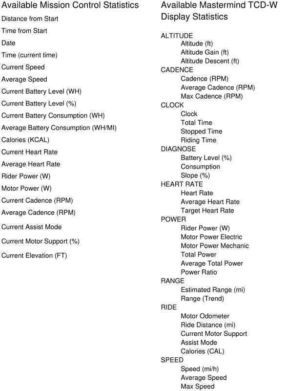

Being a statistics junky and an engineer to boot, I was curious about the statistics available to me on my new Tero 5. My old Garmin Edge 800 on my road bike can give me up to 5 pages of statistics, with as many as 10 statistics on any page.
So I first looked into Mission Control (MC). It has only a single page of statistics, with only 6 selectable stats on that page. Next I examined the Mastermind TCD-W system. Turn Bluetooth and your bike on. Then in the MC app, go to TUNE, the wrench icon, and select Customize Display hitting the little arrow to the right. This gives a screen with the name DISPLAY. Below that is a list of the available screens available after hitting the F1 button on the remote. If you hit the + to the right of the DISPLAY text, you will get a Select Layout screen. With 4 available screens, each showing from 1 to 6 selectable statistics. If you select a layout, you are taken back to the DISPLAY screen with the new screen named Screen 2. (Unless you have already done this.) Select that new screen and you will be able to add statistics to it.
I was curious about all the available statics, so I listed them all out so I could compare them. That list is shown below.
The MC has 20 statistics, and the TCD-W has 32 statistics. That should be enough for anybody. Since it is snowy here now, it ma be a while before I go riding, except on Zwift, so I have a while to decide which stats I want to show.

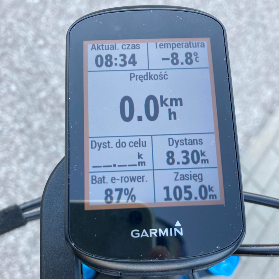

I have replied to it under another thread, Reed. Generally, ANT+ transfers this information from e-bike:
  • Speed (so Distance ridden, too)
  • Rider's Cadence
  • Rider's Power
  • E-Bike Battery %
  • Assistance Level Name (a.k.a. LEV Travel Mode)
  • Range (if calculated by the e-bike's control system)
Of course, you do not need any special sensors, as your Tero has all the sensors already in.
Garmin 530 as connected via ANT+ to a Giant Trance E+ e-bike. Data Fields selected: Time of Day, Ambient Temperature, Speed, Distance to Go, Distance Ridden, E-Bike Battery %, Range.

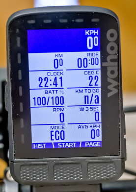

Wahoo ELEMNT Roam as connected via ANT+ to Vado SL: Speed, Distance Ridden, Ambient Temperature, E-Bike Battery % (main/extender), Distance to Go, Cadence, Rider's Power (3 second average), Travel Mode, Average Speed. There is a hidden field for Heart Rate there, too.

@mschwett : The list of Mission Control statistics that I presented came directly from the list in Mission Control > RIDE > STATS and then listing all the available selectable statistics. It turns out that Mastermind TCD-W does show altitude, altitude gain, and altitude descent. All Mission Control shows is the Current Elevation (Altitude). Please show me where I can find the additional displayable statistics for Mission Control.

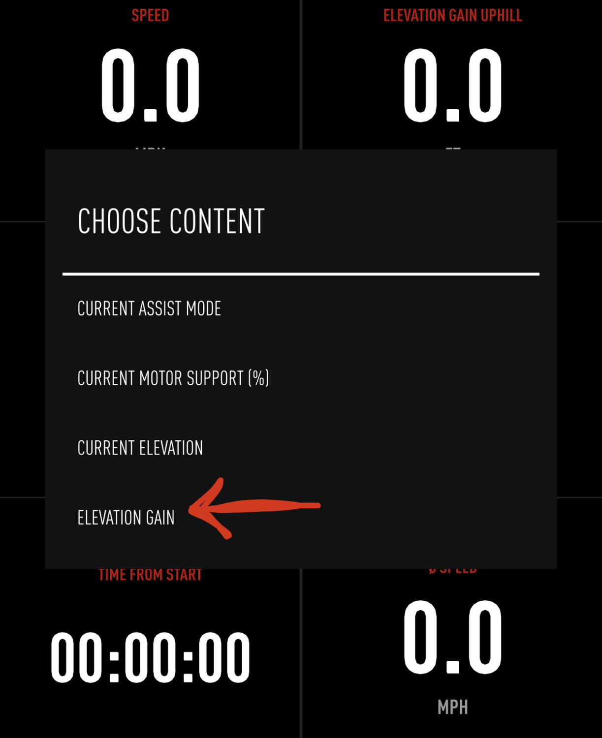

if you are in “ride” mode, and hold down a field, elevation gain is an option:
it is one i use on every ride, so i’m certain it works :)

@mschwett : Well, that is interesting. My list of stats stops at Current Elevation. I am viewing this in an android LG Stylo 5, running Android version 10. The version of Mission Control I am running is 2.8.0. I would like to have elevation gain available to me. I wonder if the amount of statistics shown is a function of iPhone or android, screen size, or what. My phone has a large screen. What phone are you running Mission Control on?

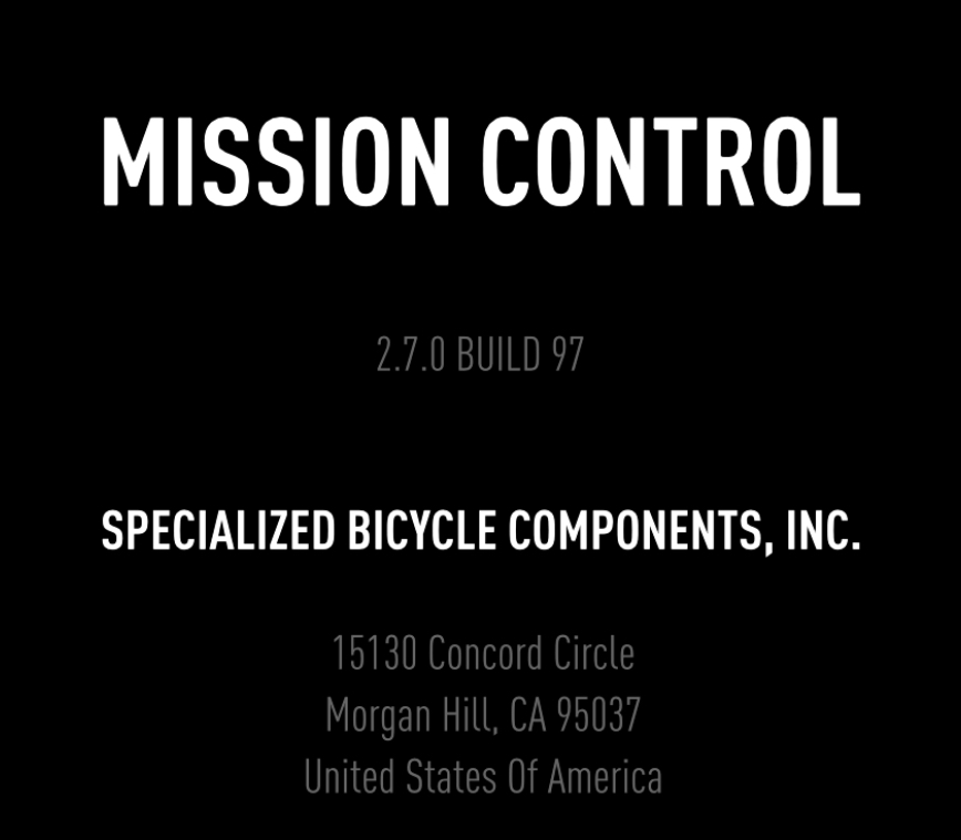

@kahn : What phone are you using for Mission Control? My phones are both LG android 10. I also tried it on a Samsung tablet No Joy on any of them.
i’m on
i’m on iOS, app version 2.7.0 97
i use it on both an iphone 13 pro max and a 12 mini; also a 12 pro max prior. the elevation gained field has always been present over many versions of iOS!

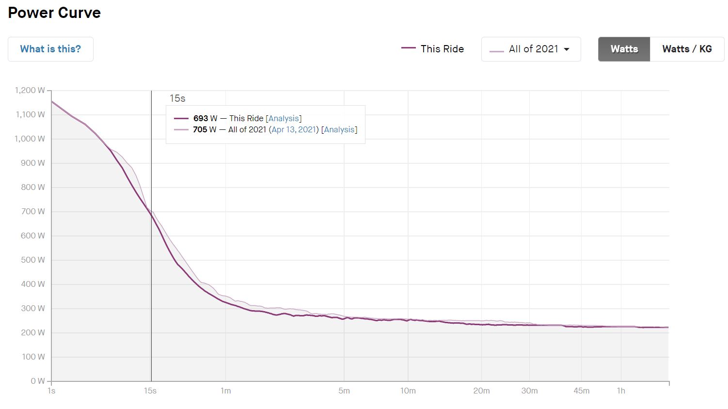

i really like the "power curve" feature in strava, which compares your power at any interval in the ride to your best efforts. on a longer ride it goes out to many hours.

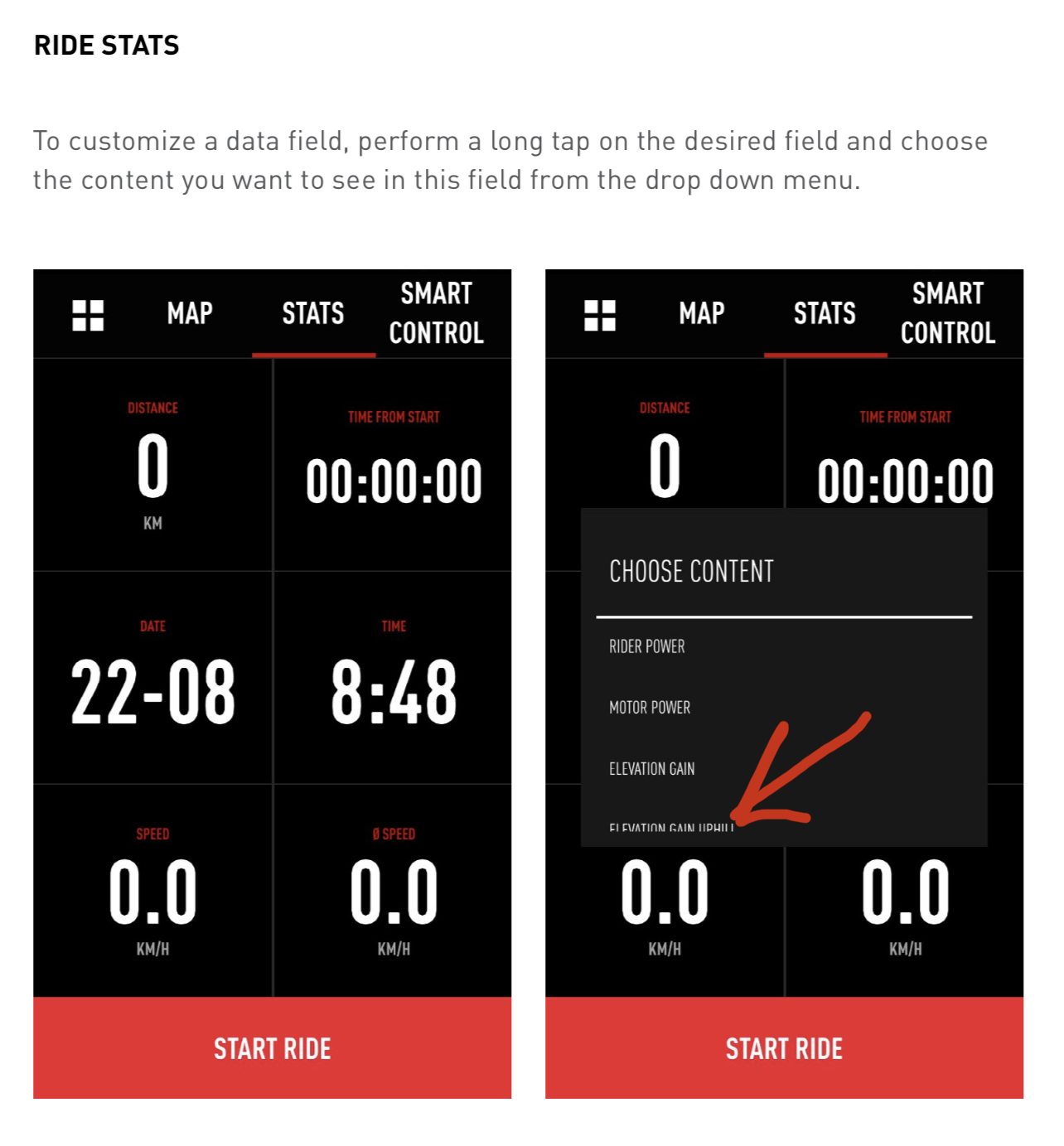

@mschwett: As far as I can remember you ride a Gen 1 Creo SL while ReedM owns the Gen 2 Tero? Isn't it making your both MCs different?
i don’t see why that would affect the “elevation climbed” field in MC, given that MC gets elevation from the phone, not the bike. perhaps a bug or inadvertent omission. could also be related to the android vs iOs versions?
even the pdf manual clearly shows elevation gain.
Mschwett: I don't want to make a PhD on how MC works ;) Suffice to say, I am very dissatisfied with Mission Control (and that's why I hardly use it).
