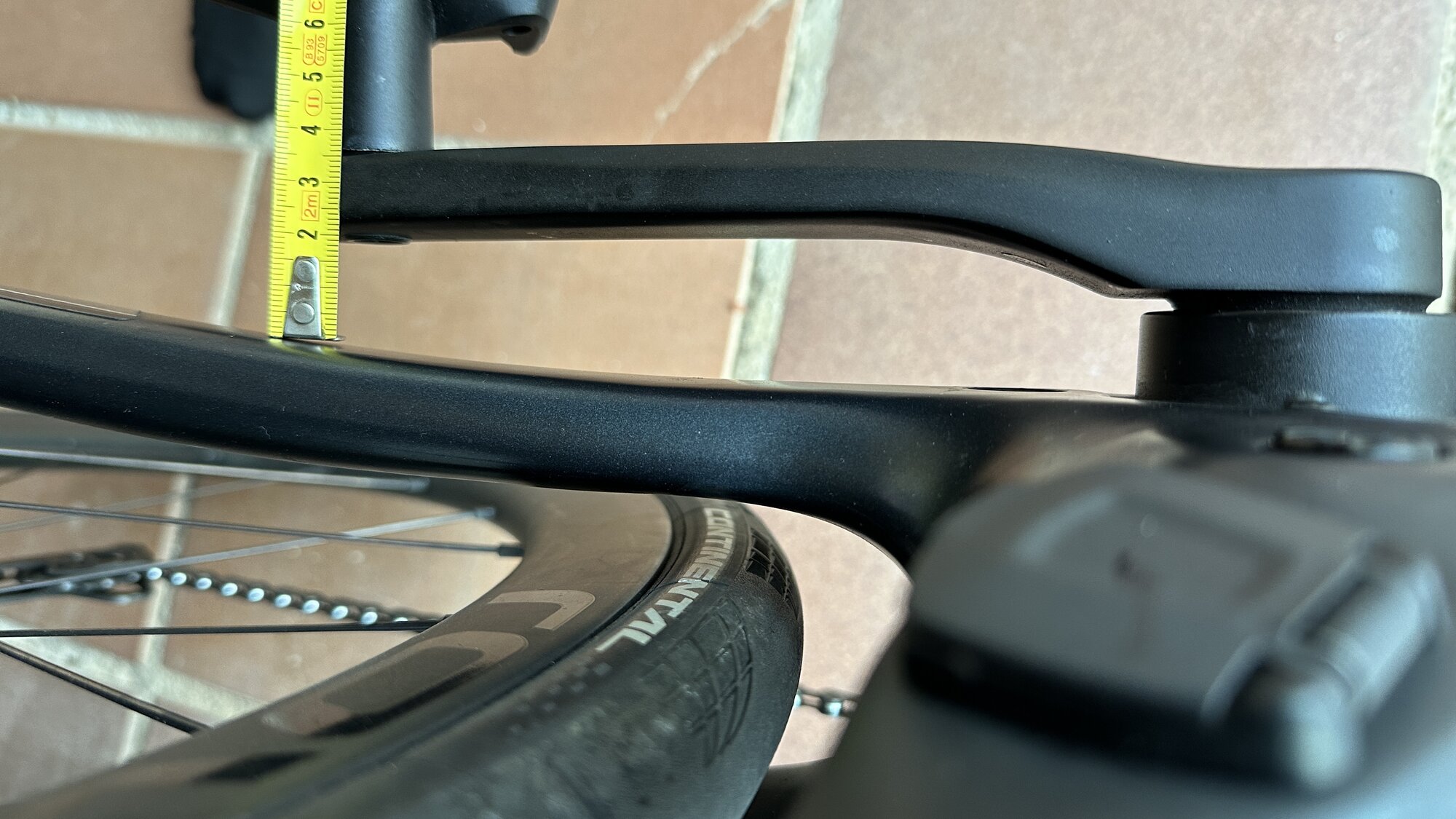

Here is my swapped crank with carbon fitted and alloy laid next to it. How can these be the same Q factor?

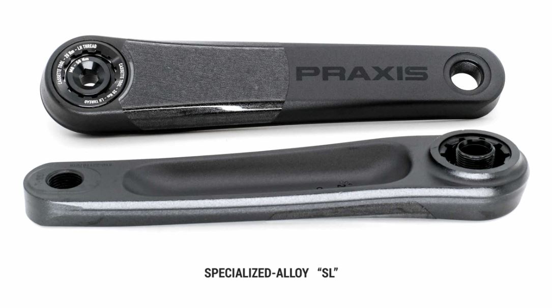

Well looking at Praxis website, my alloy arms do not match what they are showing. Mine have the wider MTB swoop and that is why I noticed the different. These are what the bike came with, so had the wrong crank arms fitted from new as these are clearly MTB ones.

The alloy swoop out cranks are definitely wider and I noticed the difference immediately as soon as I pedaled the bike. Praxis are assuming you have the same shaped cranks as the carbons, but if you have the swoop, then non swoop alloy ones will bring in the Q factor. Moving the cleats does not buy you much room, so I would look at side profiles on cranks and see if non swoop are about.

i don't have my old aluminum cranks handy, but i'm pretty sure they looked more similar to the shape of the carbon ones than your old aluminum ones seem to.
more like the way they're pictured on the praxis site, with a more gradual curve out from the interface.

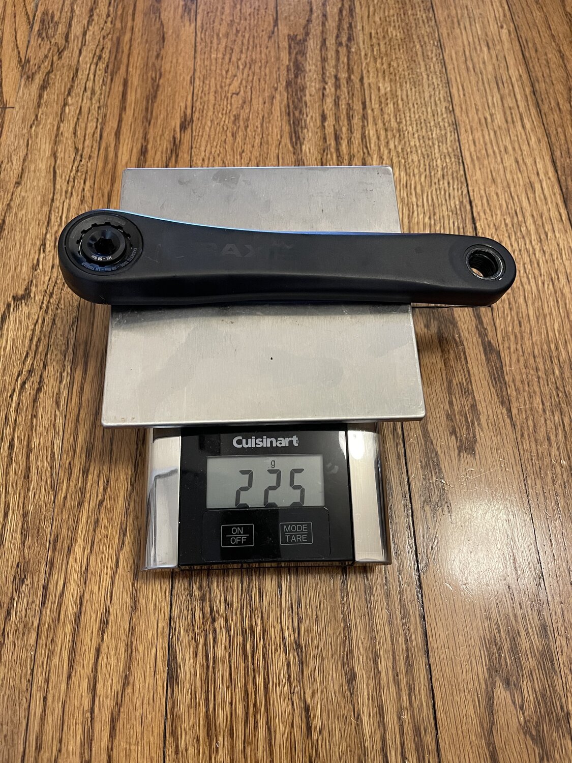

that looks to me like the "different" kind, and not what my creo came with, and potentially wider than the carbon ones. it's very hard to tell how much given the shape of both cranks, the significant offset at the attachment point, etc. it could also be that the much shorter sizes have a different shape. what size crank is that? not a great pic for the purposes, but these are the aluminum cranks that came on my creo.

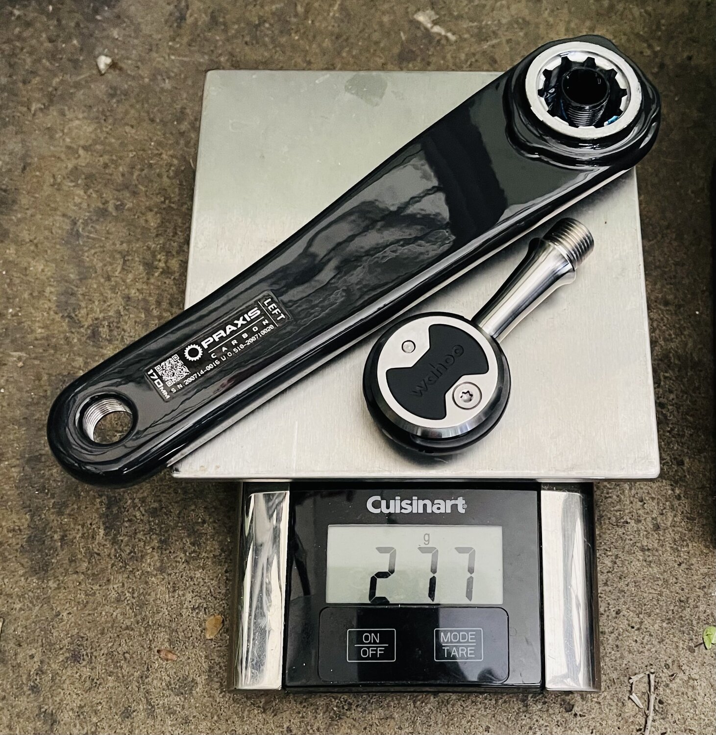

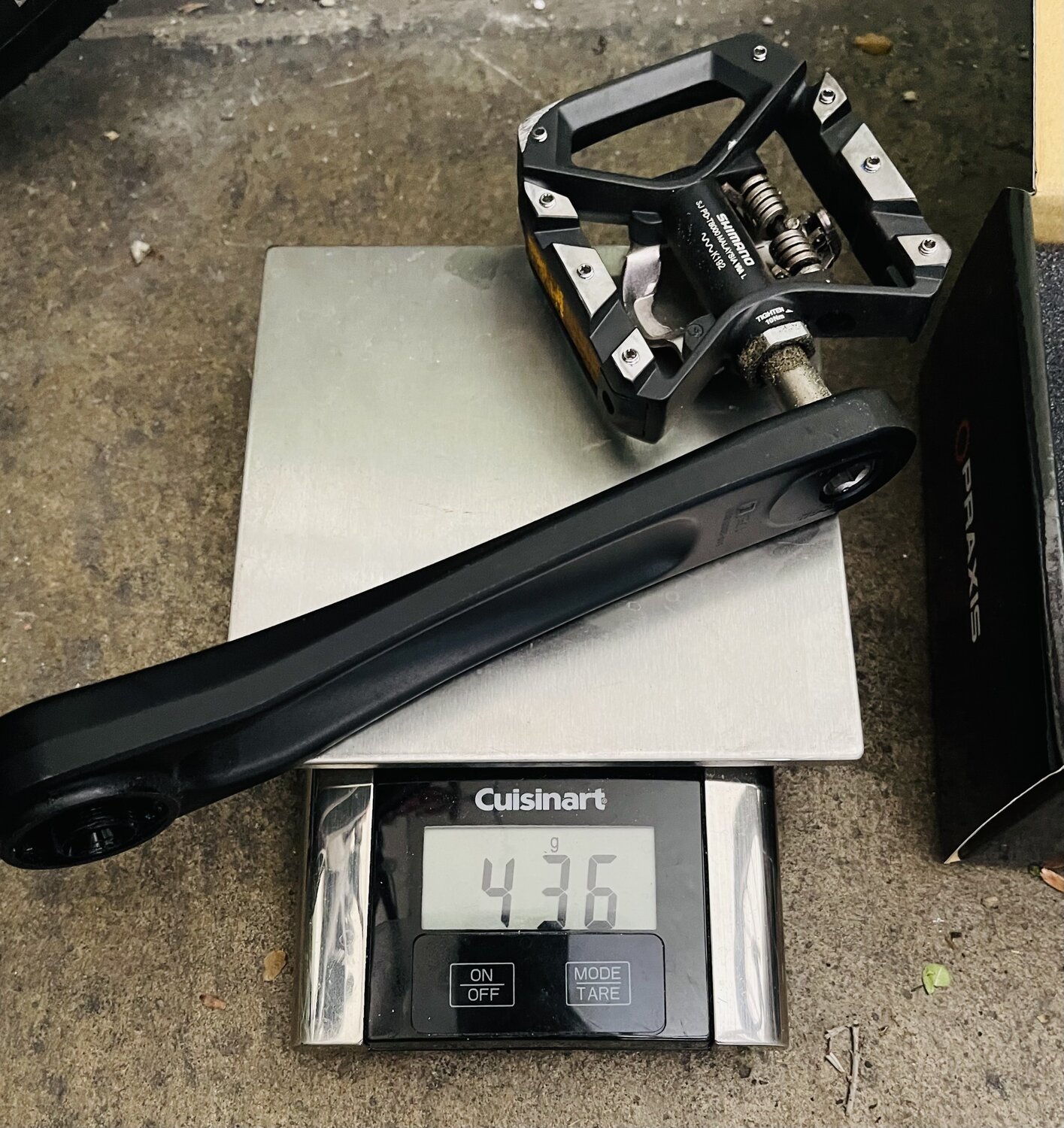

here is my 170mm carbon crank. the photos are obviously not from a good angle for these purposes, but they're what i had handy. also note 159g weight savings per going from big heavy pedals and aluminum crank to speedplay pedals and carbon cranks. that's .7lb, or around 2.5% of the entire weight of the bike!
