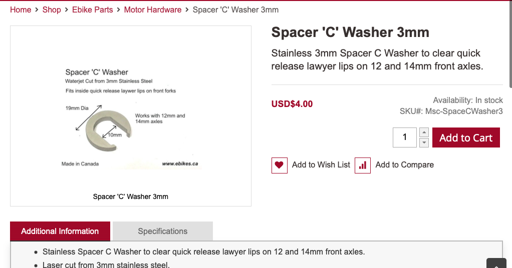

Front forks with quick-release hubs benefit from the use of C washers.
Stainless Spacer C Washer to clear quick-release lawyer lips.

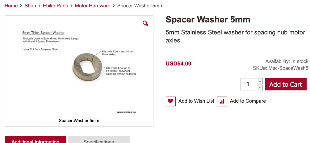

Link> Several sizes and other types are shown here.
  • Fits inside quick release lawyer lips on front forks
