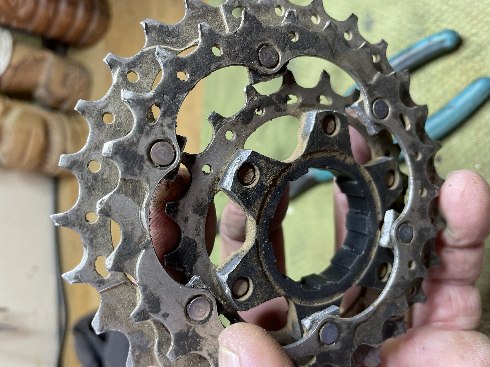

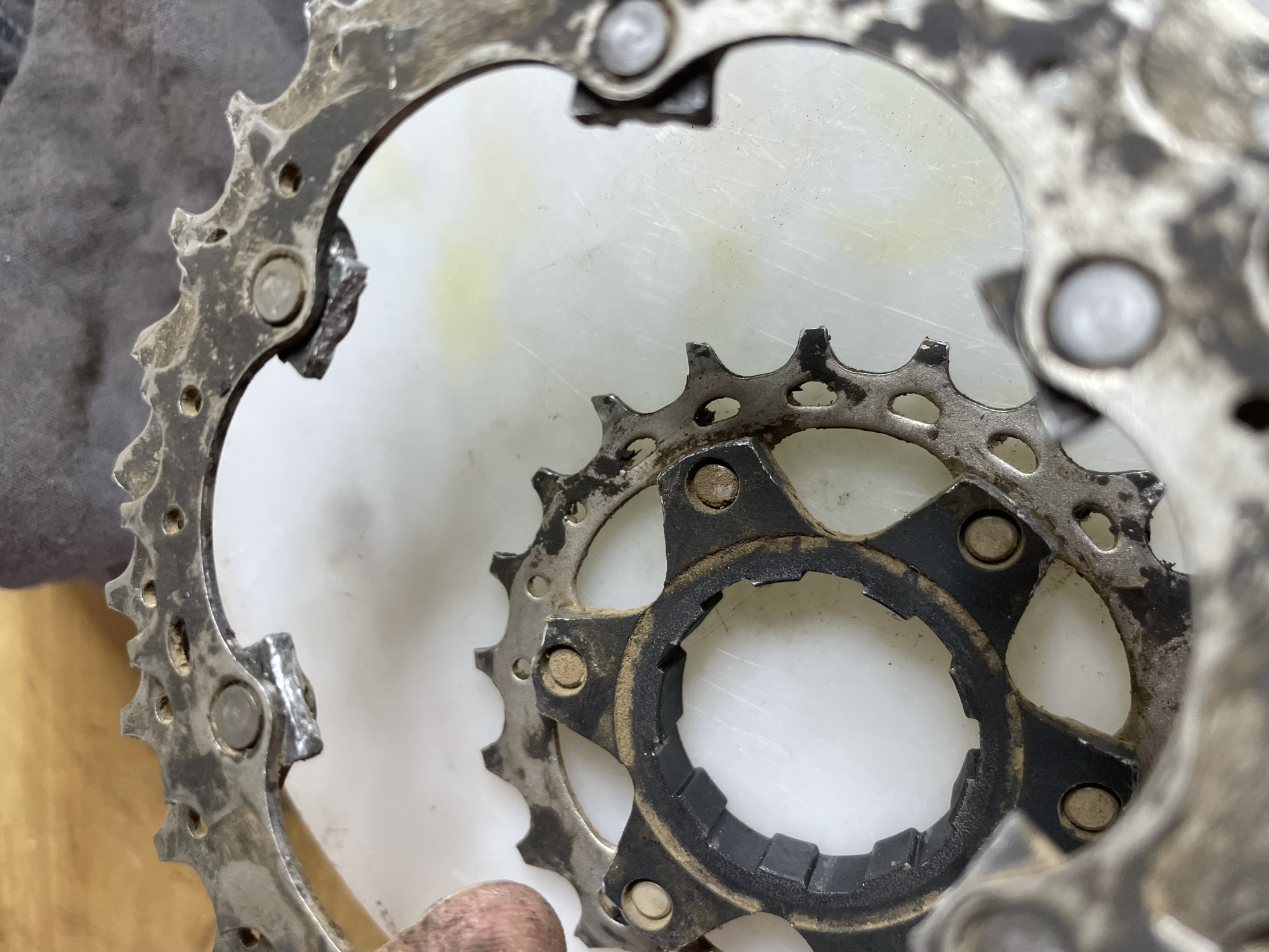

3 piece cogset: 21, 24, 28. I'm guessing I had been using the 24t cog most of the time seeing how the 21 is anchored to the actual hub body and the break is between that and the 24t. Broke out on a ride, just manually put the chain in the 32t and kept riding.

Vinny your right about chewing up a rear cassette.

As you can see by my pics it's the riveted assembly body that failed on mine. The thinner tab that holds the two larger gears is where mine broke. I would think less rivets and more actual slot mounting of the individual cogs on the hub would be better.
The biggest difference between the cassette you broke and the HG 10 Speed is the material they are made out of. Yours is made from aluminum and the HG is steel. Ive found a very durable setup is a steel free hub, the HG 10 speed cassett, and a KMC Ebike chain. I believe the Sunringle SRC hubs that came on my bike have a steel free hub so I added the HG cassette and KMC chain to my bike. Check out this video on the cassette
