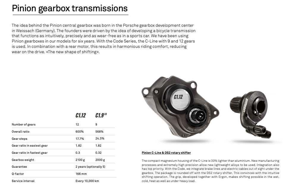

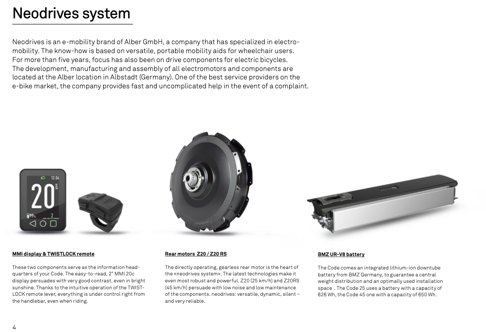

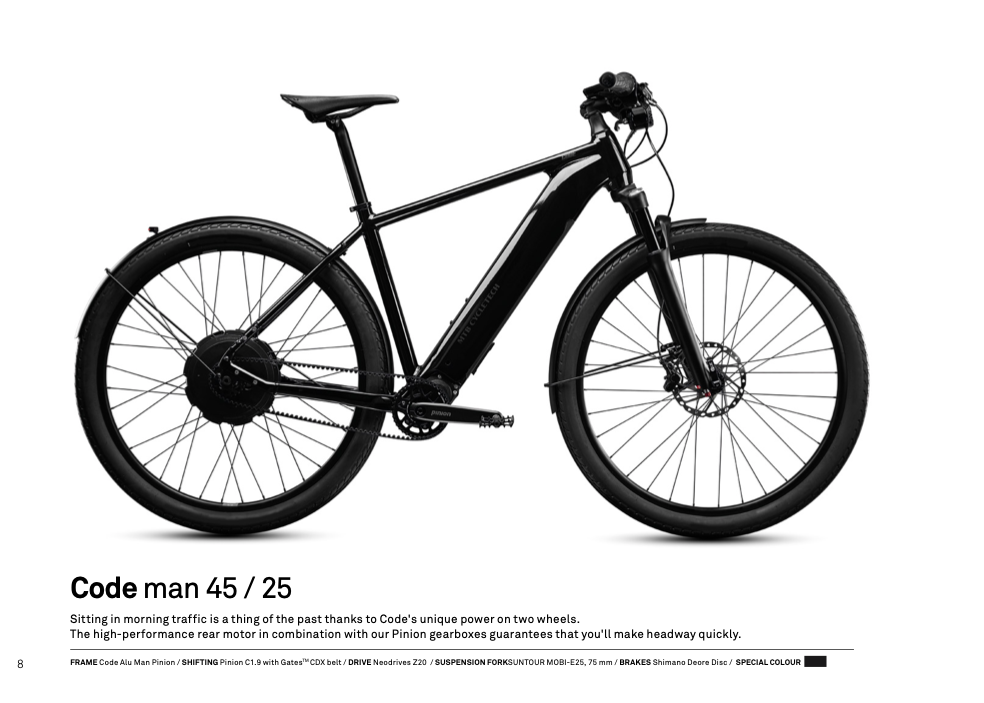

I am probably going to buy this MTB Cycletech Code 45 in the coming months. I agree with you that this is more than likely a very low maintenance setup albeit expensive.

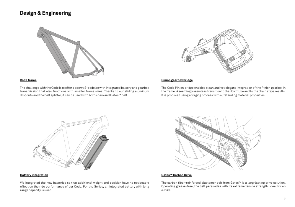

Your welding chops better be very good as the Pinion gearbox requires a custom frame as shown in the pictures below. ( there's no way I could even entertain doing something like that by myself)
46346463474634846349
I don't know if there are Pinion ready frames that can be bought without the integrated battery compartment ( which is probably proprietary and not for sale).
View attachment 46346View attachment 46347View attachment 46348View attachment 46349

That’s a beautiful looking bike. Too bad they don’t sell to North America.
I would love the Code 45 in a low step, lady or not. Its color is sweet too! Please bring it to North America.
Hey onelineaddy you're right those color options are sweet
