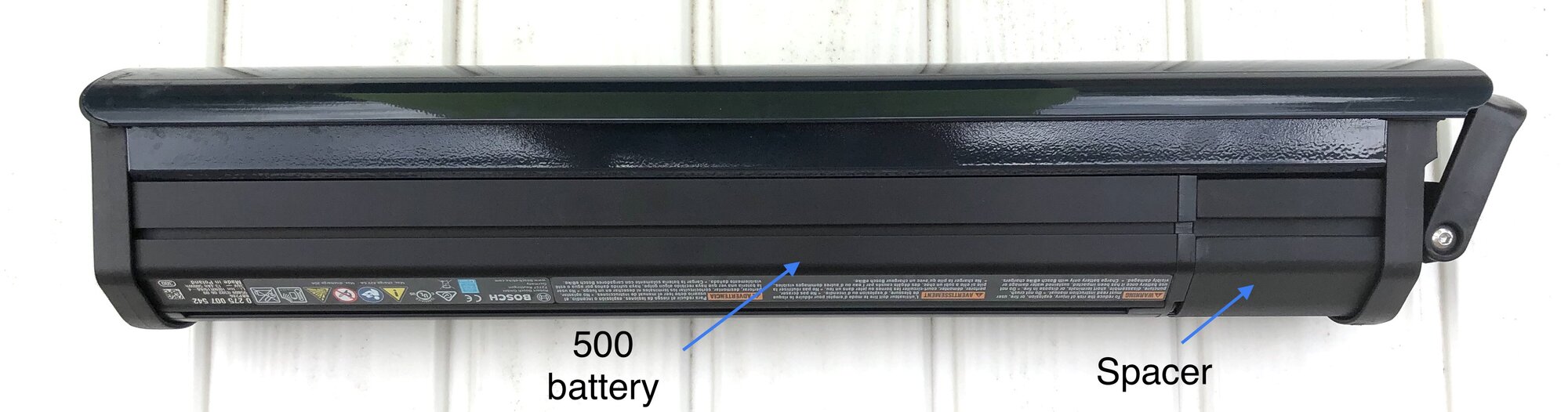

If you added a 500Wh Powertube battery without the plastic spacer block and without the RIB handle, how would it lock in place? The locking mechanism engages with the RIB handle section.
I could see that it would work without the cosmetic cover plate that has the trek logo on it, but I can't possibly imagine the battery would stay in place long without engaging the locking mechanism (which requires the spacer block for the 500Wh battery and requires the RIB handle for both the 500 and 625 Wh batteries).
I would be very cautious of riding without my battery locked in place!
I suppose you could test this by removing the plate and the spacer and RIB handle from your current battery and try mounting it on the bike without those parts. But please be careful that you don't drop it or that it doesn't fall out.
You are right. The handle is a separate piece from the spacer and is required to lock the battery in place.
