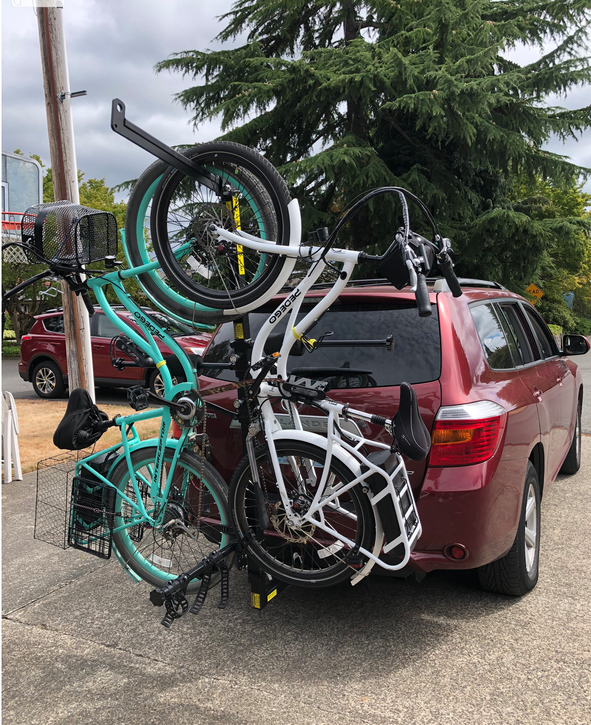

Today we had our first outing with the Upright Designs "Totem Pole" bike rack. My husband liked loading it better than the Hollywood rack, and liked that the load is carried closer to the body of the car.
We carried three Pedego bikes today on the rack. Here's a photo with two of the bikes loaded.
That is a very interesting rack. I like the way the load is distributed over the tradition rack. Nice choice.
Interesting...
