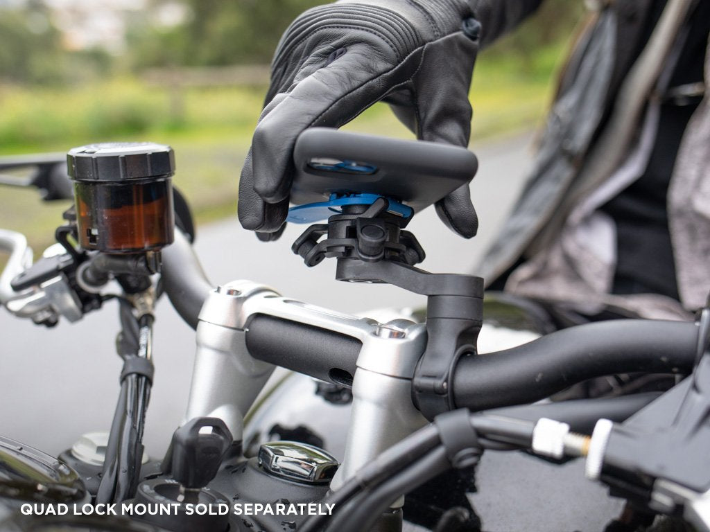

Obviously, it would require a solid mount. Any suggestions?
What about power (i.e. how to keep the phone on and charged during a long ride with nav)? The RadCity bikes I just ordered have a 48V, 14 Ah battery but, apparently, it has a 5V USB port. Maybe that's the way to do it?

And yes you can power off the USB port on the display, but you might find it's a tad underpowered if your phone is a real battery hog. My older iphone 7 would only maintain a state of charge when using the screen on max brightness and gps, but wouldn't recharge very fast. The new iphone 12 pro max seems much more efficient and works great off the display.
Also consider a vibration dampened mount like the quadlock or similar if you plan to ride gravel or rougher roads/trails as the image-stabilized phone cameras can be damaged by persistent vibration.

I'll look at the quadlock. Thanks again!

If I can find a decent mount that works with my Pixel (which is in a wallet-type leather case) and a way to power it from the bike, I'll be happy. Good point @theemartymac about the vibration - I wouldn't have thought of that.
