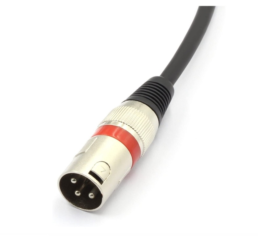

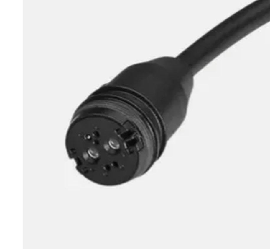

Actually, the charging circuit is sort of a two-way connection. If you think about it, the battery is "hot" and so is the charger. So which side should get the male contacts? And if you look at it from the point of the connector overall, the charger plug is male with female pins and the battery has a female receptacle with male pins inside. What you wouldn't want would be potentially hot pins out in the open, and in fact the pins on the battery are recessed within a receptacle.
Actually you would want the opposite.
For one the charger can be left unplugged until after being connected to the battery.... So essentially it's not always hot as is the battery.
Second the charger has a much lower potential and at a lower current then the battery.
And lastly the charger could easily be protected with a reset_able or replaceable fuse with easy access... especially since the battery needs to be waterproof.
Just looking at the charger plug would tell you that it is much more difficult to short out.
And then under what circumstances would someone put a key or anything else accidentally into the charger?
This is a typical end to an inexpensive charger... See if you can find videos or threads about people accidentally shorting them out.
Well, the Creo and other bikes uses a recessed cable plug so that the pins are protected

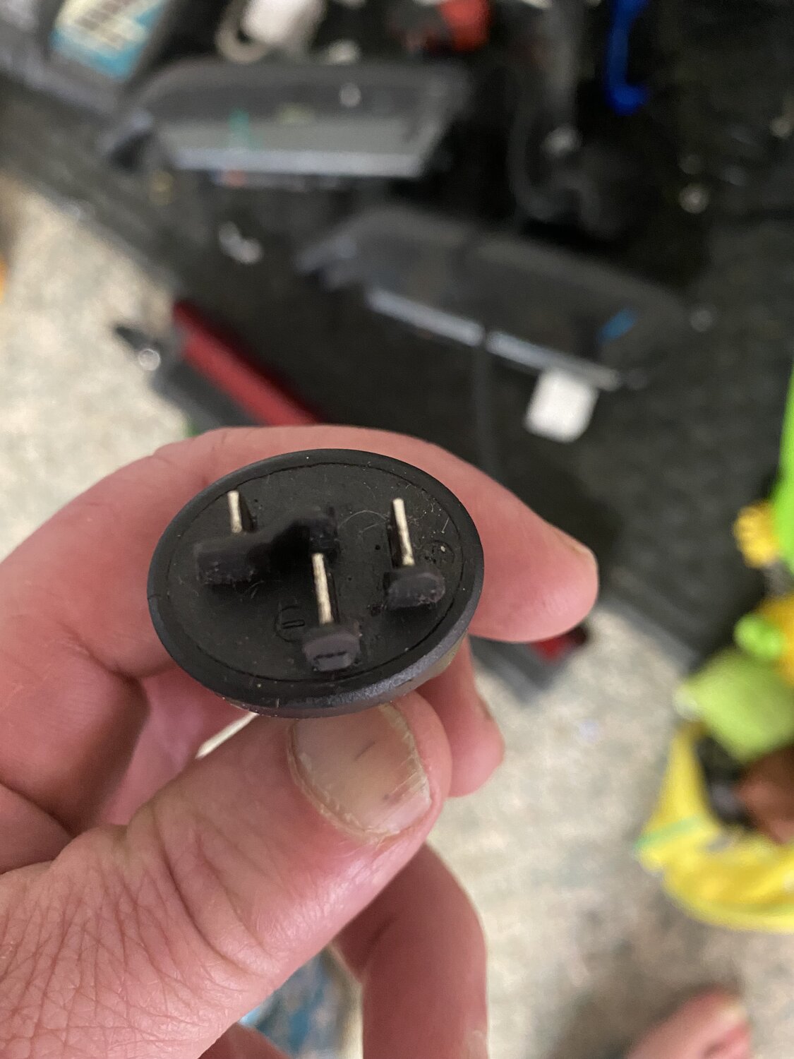

Or do as bosch does plastic protects the plug

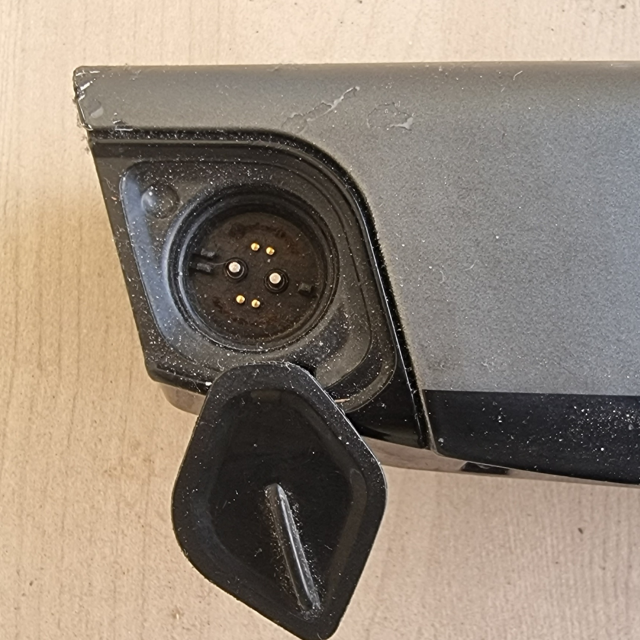

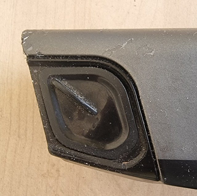

The Specialized U1-600 battery charging receptacle is normally protected with a magnetic cover.
After the charging is done, and the charger plug removed from the receptacle, it just requires a delicate movement of a finger to make the cover flip into the place and stay there. My oldest battery has been in use for 28 months. I am a really careless person, still the charging port covers on my three batteries stay in place.
The first generation of Vado/Como was made between 2017 and 2021. The fact you could use the same battery format for 460 or 500 or 604 Wh capacities was a concept beyond any competing system (think of varieties of Bosch or Giant batteries, compared to the single Specialized battery format). No-one can say a Specialized engineer didn't think of protecting the charging port, especially as Specialized chose the Rosenberger magnetic* plug/socket. The OP has just had a bad luck. Accidents do happen.
Having said the above, it is necessary to mention that the Gen 2 of Vado/Como/Tero has the location of the charging port modified for their new U2 batteries, while keeping the Rosenberger system.
*) The great thing about the Rosenberger plug is that if you incidentally trip over the charging cable, the plug will pop off the charging socket, with no damage to either the bike or the charger.

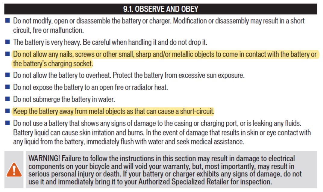

The magnetic cover is very well designed and pops back into place with almost no effort, which makes me even madder with myself that I hadn't done it. That's the main purpose of this thread, to remind those of us with this generation Vado and Como to always protect the plug or face the consequences. The manual is almost laughingly vague about the battery:
View attachment 117836View attachment 117837
