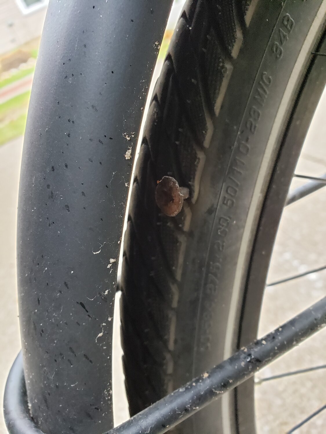

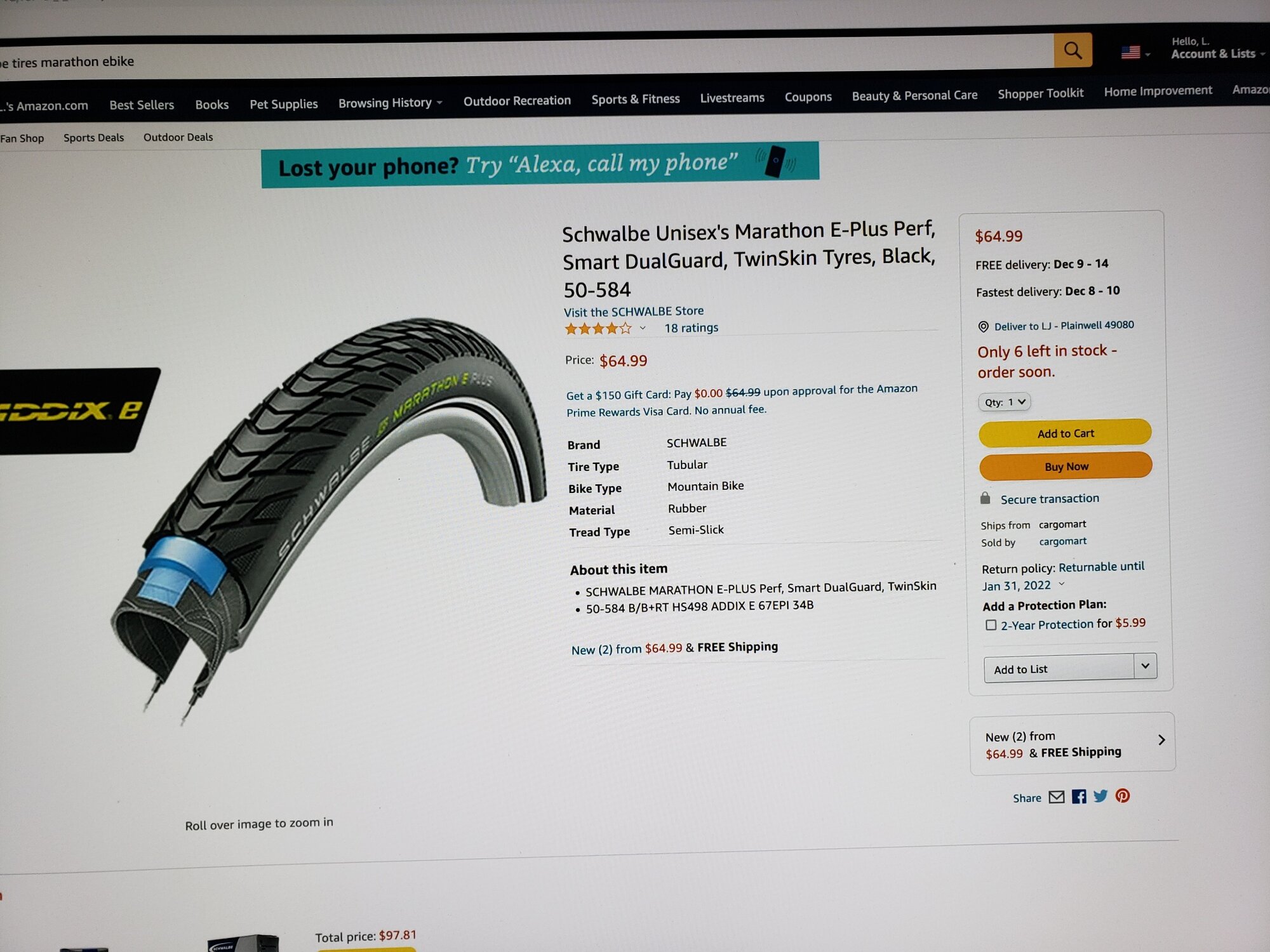

Take a look at the Schwalbe Marathon E-Plus tires. They are highly rated for Road Grip, Protection, and Durability. 3,500 miles on them with my Allant+ 8s and no flats from small items like glass or stones (one puncture due to large screw). There are also not showing any wear.
They are available on Amazon.

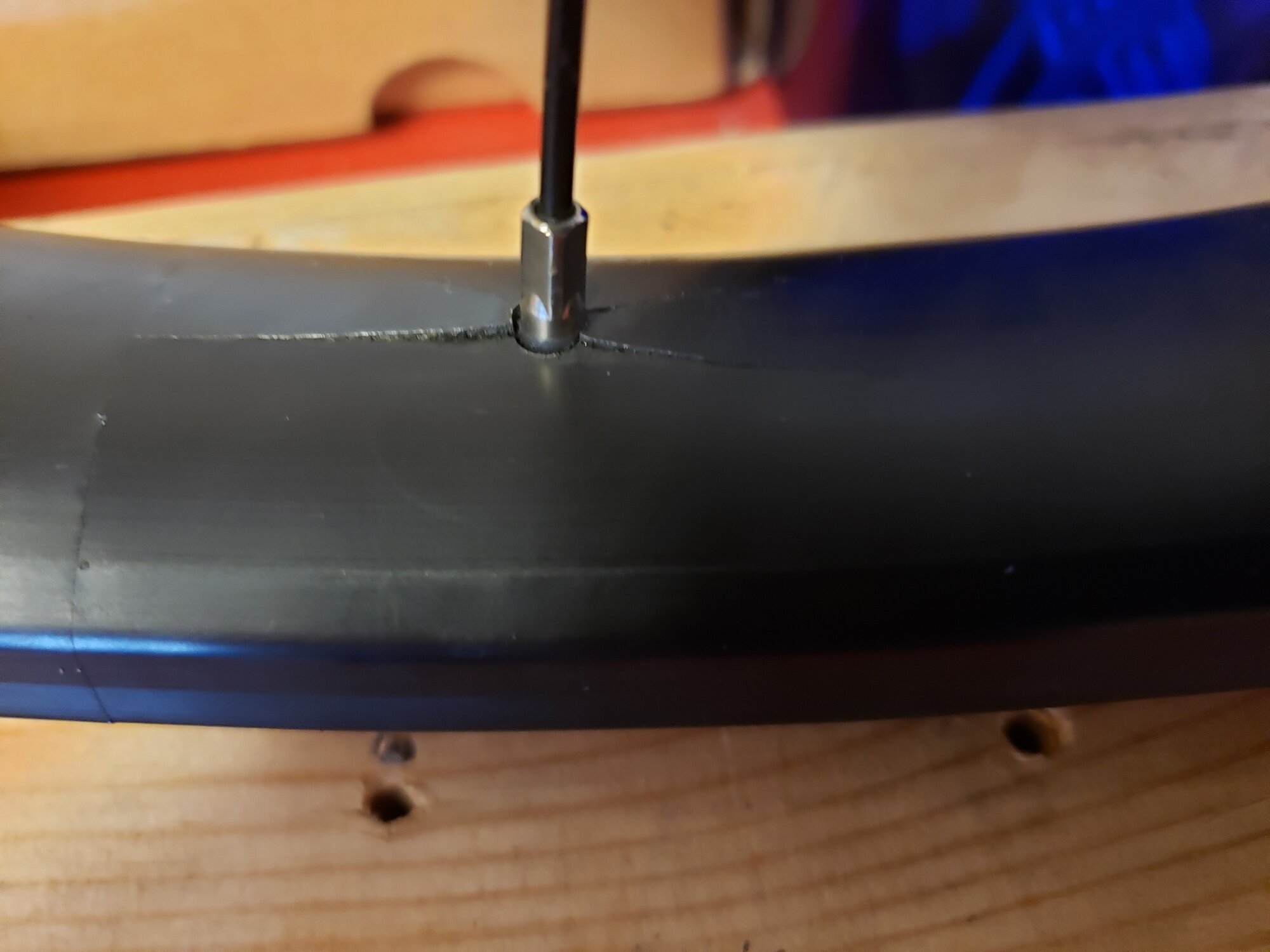

Just a tip, take a moment and check your rear wheel for cracks around the spokes. My rear wheel failed in about 4 places and needed to be replaced.

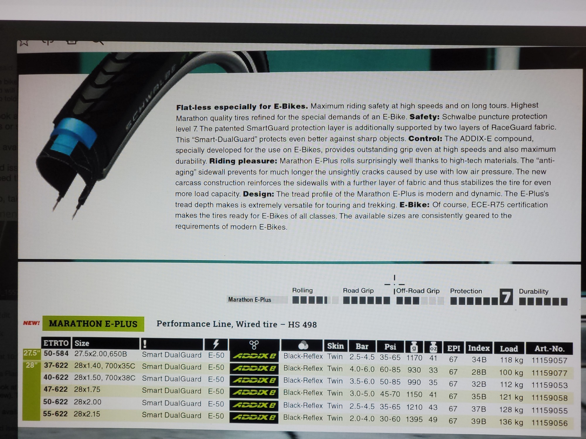

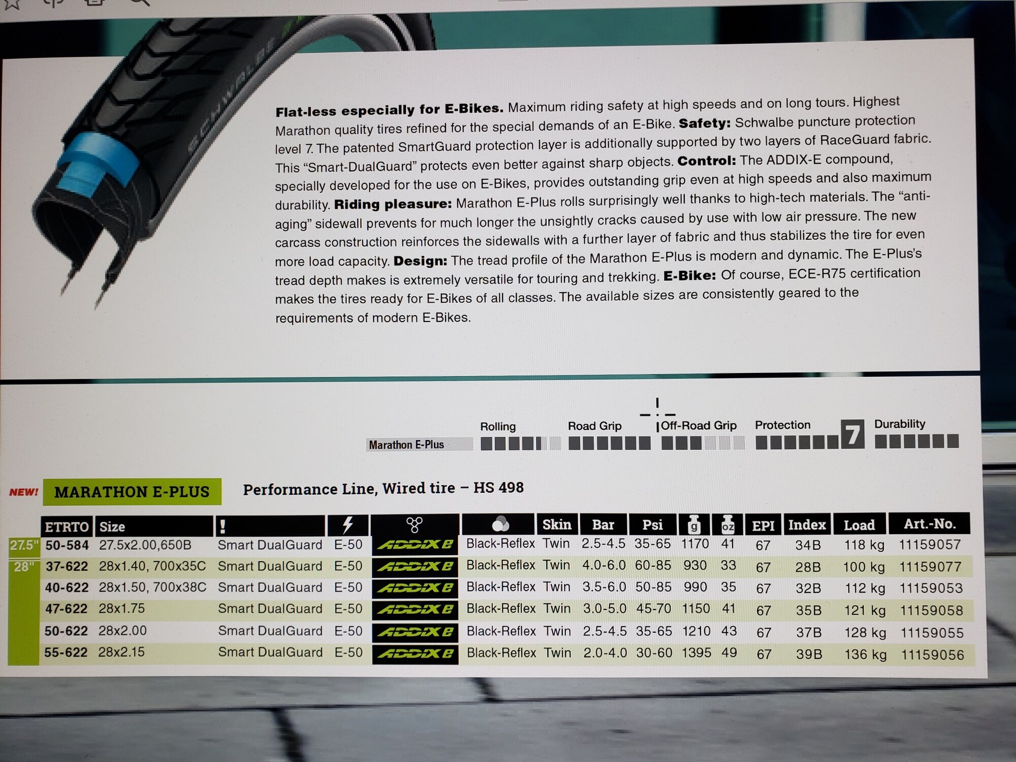

The premium highest rated tire only comes in 2.00 x 27.5. There are 5 other tires in 28 inch. I am very satisfied with the 2" tire. This tire is the highest rated for Road Grip, Protection, and Durability. If you do not go with Schwalbe, at the least get an E-50 rated tire. With a heavy e-bike you want the strongest, most durable tire available.
