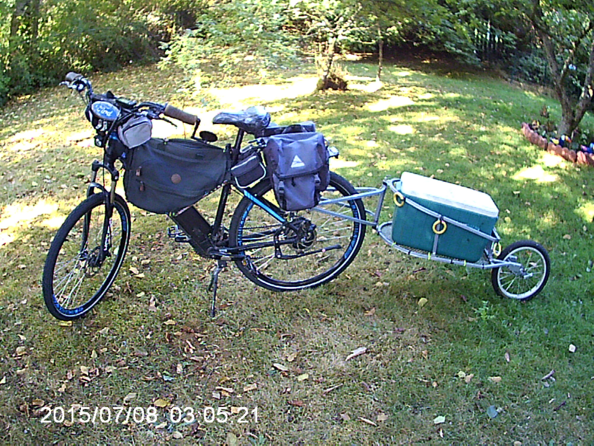

Cheap, strong, durable, daily driver: NCM moscow, Take care of it & it´ll give good service;
a long time. See: EBR review.
