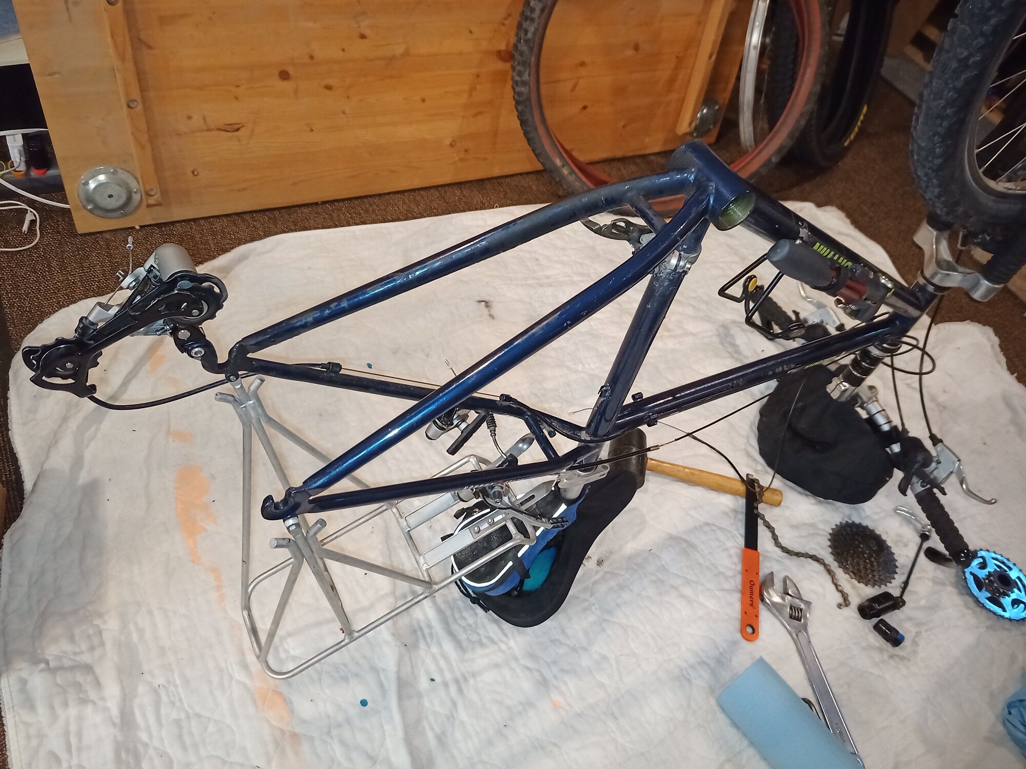

After a ridiculous amount of thought I'm going to start my Kona Hoss BBSHD build
