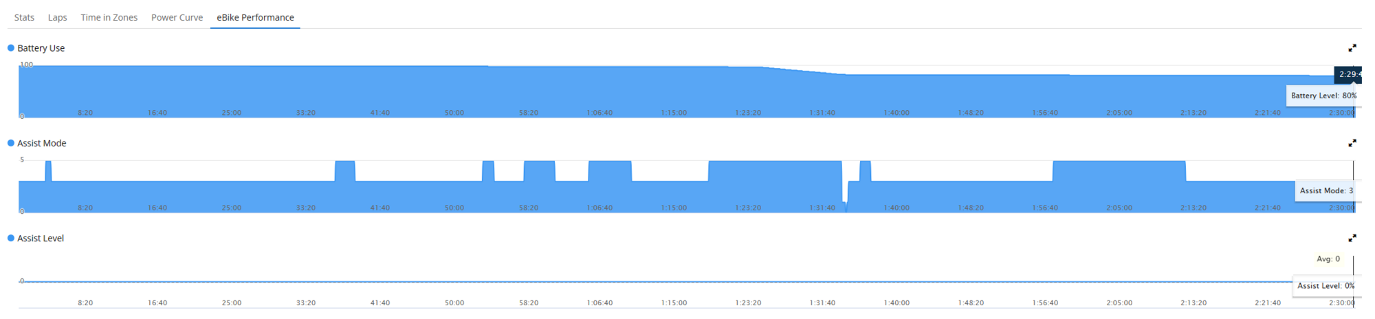

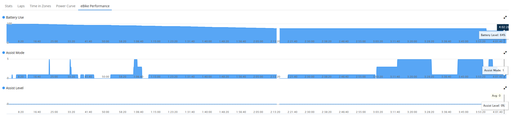

There's one section that's a 10 mile climb with an avg 5% grade that I could burn through two of my REs (eco+sport+turbo mix). It started to make me question if the 3 RE's I have are worth the cost/weight.
As a test I went out again setting the discharge to both and remained between sport on flats and turbo on the climbs. My overall battery was higher while using one less RE.
