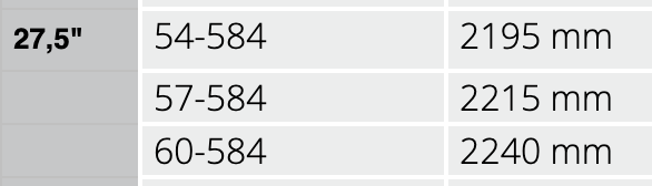

I'm running Super Moto X in a 27.5 x 2.35 so I went and found circumference here:
Tire Dimensions - Schwalbe Professional Bike Tires
Even when I changed it to 2240 it seems to have made no difference to the accuracy - it's still consistently 'faster' - It's not the end of the world but just frustrating I can't seem to get this dialled in more accurately.
