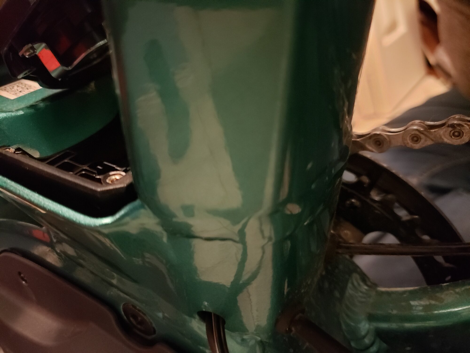

The rear light was very difficult to fish around the drive unit. I ended up having success with removing my speed sensor and using that cable to fish my rear light cable to the desired location. This took a lot of swearing, finessing, and care not to damage the important bits. On my bike, this cable went from the back 'left' of the frame/drive unit, under the drive unit, and pops up right next to the lighting connection. By taping my light's cable to the speed sensor wire, I could carefully pull the speed sensor cable back towards the drive unit connection, and the lighting cable showed up before my speed sensor cable length ran out.

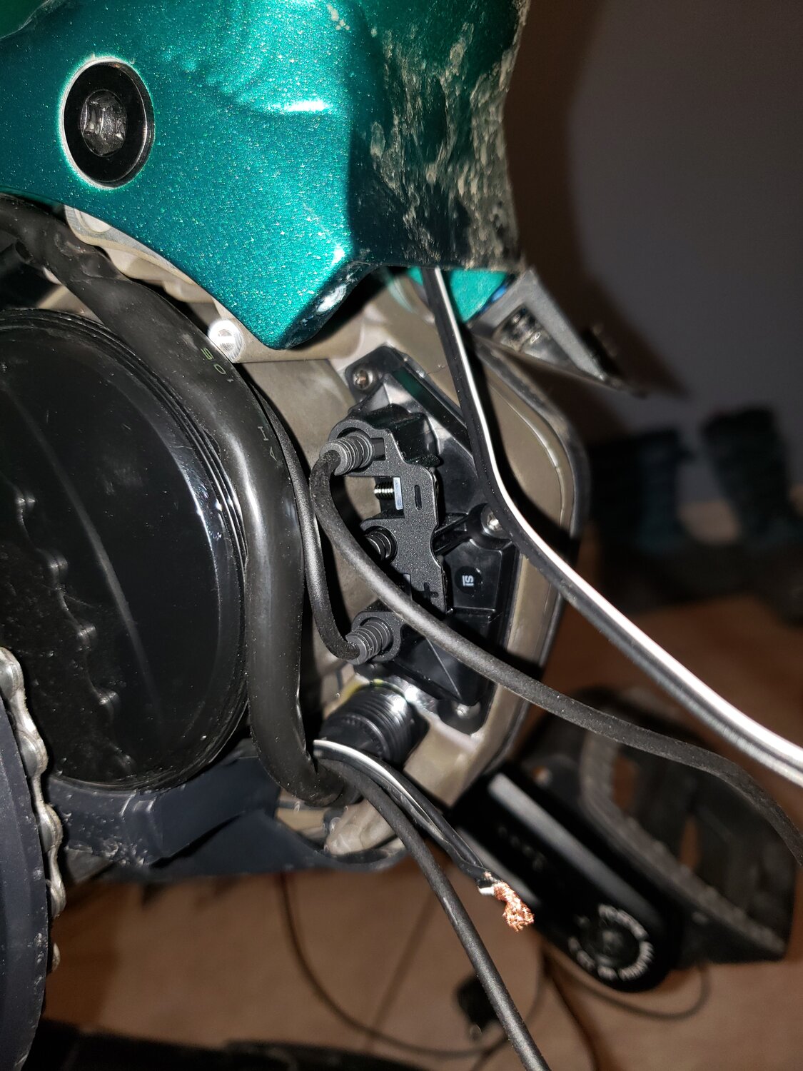

The front right cover off with the front lighting cable strung. The lighting connections are easy to see and use. Other major cables-the big one is the cable between the battery and the motor, the two that connect right next to the lights are the computer cable and the speed sensor cable.

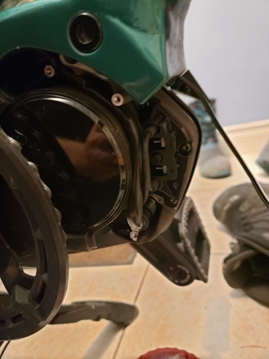

The left rear of the drive unit. I have removed the plug around the speed sensor cable to allow me to thread the lighting cable in.
Here I have used the speed sensor cable to pull my rear light cable through. A bit of tape held the lighting cable onto the speed sensor cable. Easy does it!

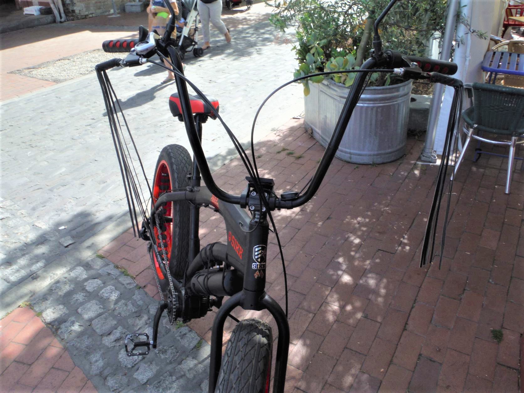

I made a monster today! Frankenstein. It needs a stein holder. 120 Nm. Throttle. The HB wires are relatively clean for a Bafang build. Most are a mess. It is light kit ready, but USB lights will be cleaner. Those are 4" tires. Next is 4.7 inches. Not my thing, but who am I to say. She likes it.
