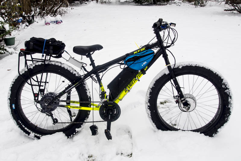

I've done this before on a 26" fat tire bike. Old fashioned. Two controllers. Two batteries. Two throttles. I used only throttle to run the front wheel. I found it rideable on dry ground, but a bit unwieldy. Basically use PAS for the rear and throttle for the front, but the traction in snow flipped me over a few times. I did one long ride like Howard Hughes did for the Spruce Goose. Then I came home soaking wet from all the falling down, took it apart when summer came and went one motor again. The front, by the way, was only a 36V 500W motor that came off a rear wheel bike and had the 135mm axle spacing used on a fat tire bike. All I wanted was traction,

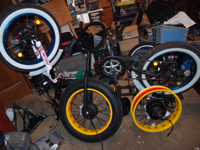

A few years later, I decided to try it again, only with my Ecotric 20" fat tire bike and only for dry pavement. I had a hard time finding 20"x60 rims. I wound up with yellow ones, 20x100'. Huge. I spoked up new motors for both. Here they are ready to go, using the original solid fork. Disaster came next. The new rear wheel axle was too wide for the Ecotric. I guess I could have just done the front drive, but my heart was no longer in it because of different wheel colors.
I would have used two controllers, but one throttle and only one display. The front controller could run w/o a display, but turn on with the rear. The front and rear controllers would have separate batteries and a common ground. I was going to put a Y connector off the throttle and run only the signal and ground to the front controller. Tested on bench, it worked. I had the option of a second PAS sensor frunning to the front controller too.
I would have used only a 17A controller in front. They're small. My Ecotric 20" is 36V. I had plenty of small 36V packs that would fit somewhere on the bike.

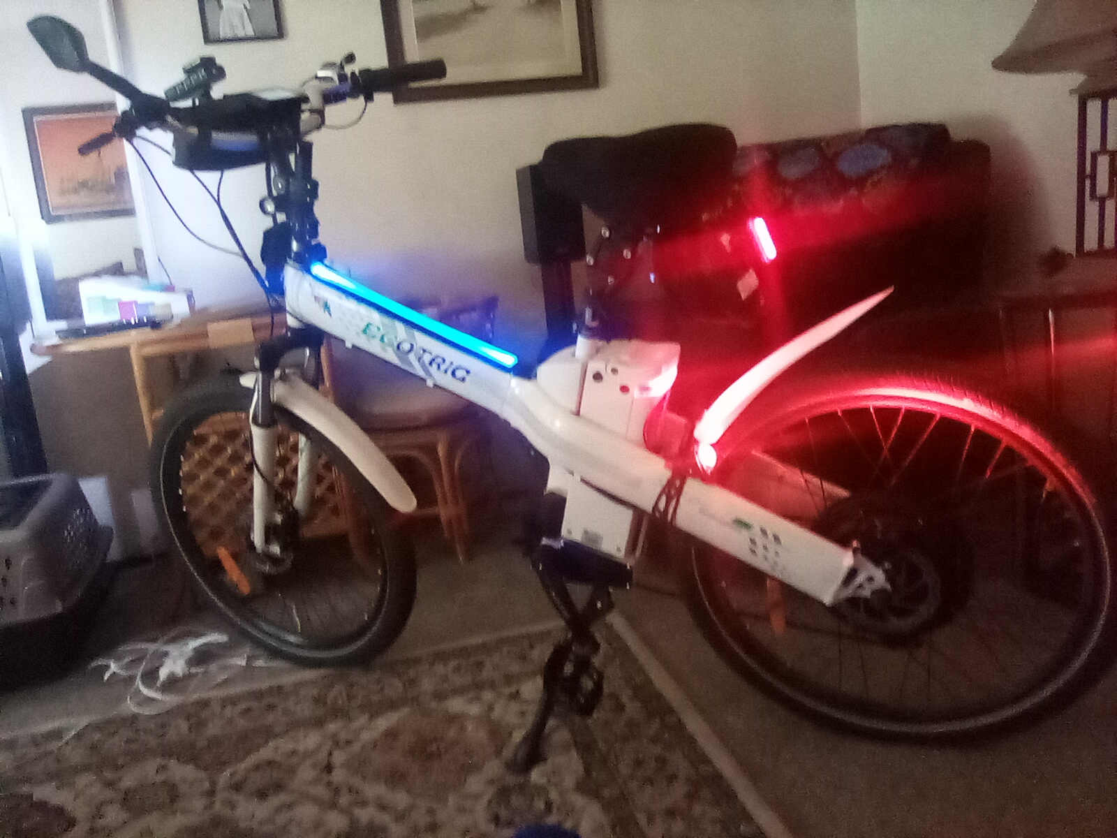

What's wrong with the styling? I did modify it some. Raised sweeping double handlebars, big seat with added suspension, Schwalbe tires, and lights for night riding. I love my Seagull and it gets alot of love from others.

It looks like you are riding a rectangular alloy tube, BTW I was not dissing the bike, some get offended over the least little thing, sigh, that competitive Dragon is rearing its ugly head again. take this from this discussion" Words are only words! No one was putting your bike down, if you really want to see goofy styling look at some of 20" folders( had 3 so I know what I am talking about.)
Not to worry. I know what a bad-ass ride I put together. It's faster than I need to go and looks good getting there. Very little upkeep with a solid, smooth, quiet ride. I turn on the mp3 and cruise right along. 1000 watts of fun. I can tackle any steep city street and we have many here. Great bang for the buck and a "style" that people like. Until now, a "turnoff" to none. To each his own.
