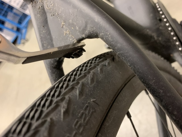

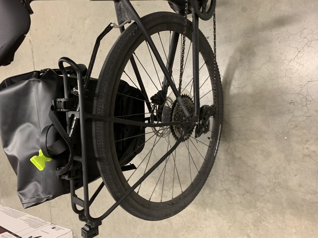

i have done it but I had to get a different brand rack as the one from specialized that was meant for this bike had to have fenders attached
Hi Jay...
What brand did you buy? Could you post a picture? I looked at pages of racks and it looks like none of them could easily tie to the fender mount point...

The thread below has some photos of another method to attach a generic rack and fenders. If you are using panniers you could leave the light on the seat. The seats on the EQ and non-EQ are the same but the light is on a bracket attached to the seat. The SL 5,0 SL EQ light is on the fender in a different package than the seat. I assume it can be ordered as a replacement part. The fender light wire just runs along the inside right edge of the fender and then in through to the bottom bracket in a typical manner. The Specialized fender has a channel for the wire but on other fenders I've used aluminum furnace tape (not duct tape) to hold the wire inside the fender and protect it.
