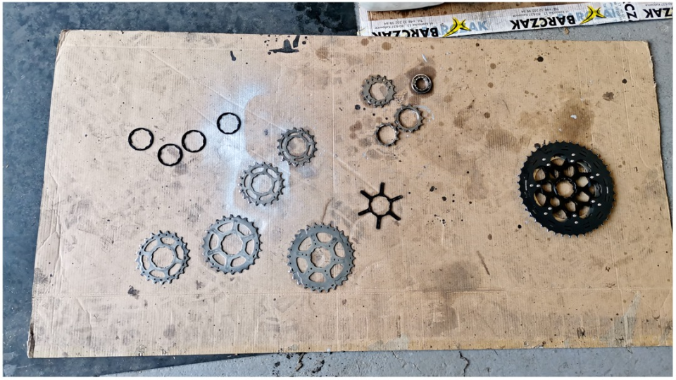

1. Why should you change the cassette in the first place? If you want to do this, it is the best to buy a whole set of professional bike tools. To remove the cassette, you actually need two tools: the chain whip, and a special tool for removing the cassette lockring. You place the chain of the whip on a cog of the cassette, and use the lockring tool to remove the lockring. Now, your cassette will fall apart into small bits and pieces...
Parts of a disassembled cassette after being washed in white spirit. See the spider with the big cogs at the right.
Basically, it is not reasonable to replace the entire cassette as it is expensive. Depending on the cassette model, you can just replace at least two smallest cogs, as these are typically worn. (Some cassettes allow replacing as many as four or even eight smallest cogs).

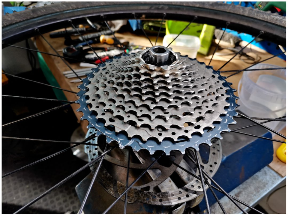

A cassette on the re-assembly, before the lockring has been put on and tightened to the spec.
It is reasonable to leave the work to the LBS.
