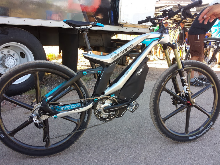

You would truly love the M1 Spitzing.
It's like Opti with PAS. 120Nm of torque and phenomenal acceleration. They have decided not to bring it to the US market but you might be able to get it in UK. PM me if you would like their EU contact.
I had so much fun on this....Riding this thing was like bikegasm......

That may be the answer to my dreams. I have the Nuvinci on my fatbike and I am amazed that they can feed 120Nm torque through it, it is rated for much lower torque. I would go for a normally geared version. I will continue to look into it. So much depends on the feel of the torque response of the peddle system. I will PM you if I cannot find the distributor.
