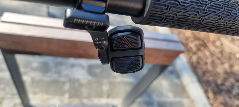

@Prairie Dog: Could you tell me more about the SRAM Reverb AXS? What size have you used? What travel? Could you take a pic of the lever?
P.S. I did a little research. The long travel Reverb AXS seat-posts are deadly expensive. However, I could buy a 50 mm travel AXS XPLR at a reasonable price. Oh, but the Remote is not included?! :D

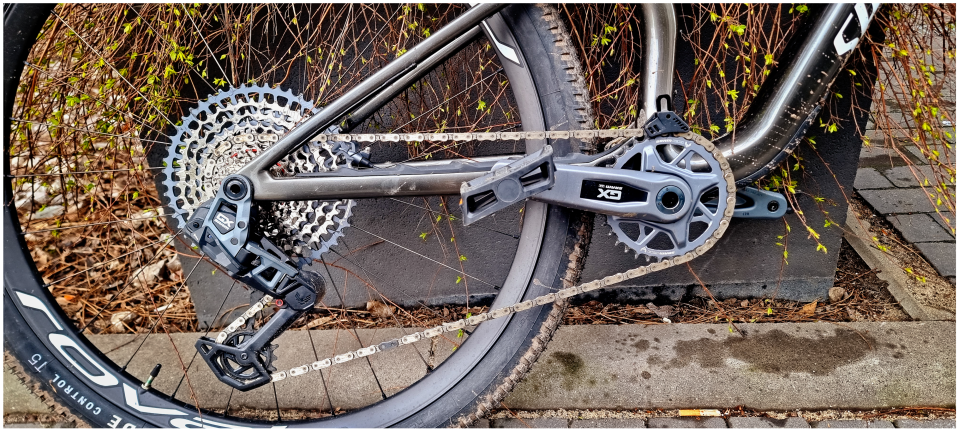

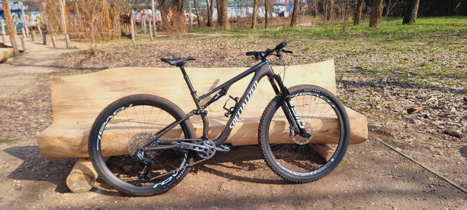

I have demo ridden an Epic 8 Expert, SRAM GX AXS Transmission. A wonderful experience. Perhaps in the future :)
