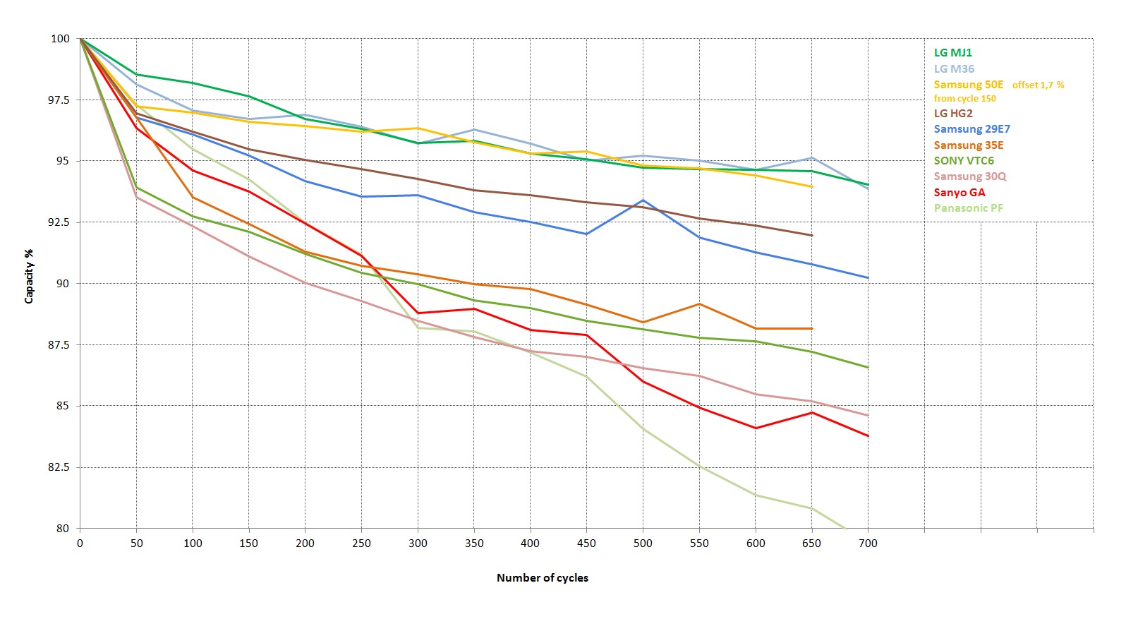

Hoi Banjo !
Charge it up full, ride and repeat.
Because: ' Articles ' are old anecdotes about battery packs with various quality of manufacturing.
Here's the data: Negligible capacity loss for Samsung over hundreds of full cycles.
Ref. https://endless-sphere.com/forums/viewtopic.php?f=14&t=103092&start=425

Hoi Banjo !
That pretty much flies in the face of every resource, everywhere unless you put some context in. How long was the 100% charge held, for instance? If you charge to 100% and immediately go for a ride, there's far less damage to the internal cell chemistry than there is if you charge to 100% overnight and let it sit from 2am until noon when you go for your ride. Or 3 days later. What was the charge amperage? 1 amp? 5 amps? Do you think that matters? What was the discharge? a steady 1 amp? 30 amps? Do you think that matters?
This is a far more complex subject than you are letting on. I agree that if someone wants to go out and enjoy their ebike, they should. Charge the bejesus out of it. But be smart about it and don't piss away your investment. Li-ion batteries have a finite life cycle made shorter by certain behaviors. Blowing that off is not giving responsible advice.
EDIT: Spend just a bit of time reading the posts in that thread and you'll see even the test author is acknowledging these are lab tests and not real world tests. Its good data but not what @Mike_V is representing it to be. For the record I have a Samsung 25R pack whose life is well over 2000 cycles and still appears to be at full capacity... but I have specific charge protocols that are WAY more involved than normal people want to get into messing with to get a pack to live that long. I have another 25R pack not treated so well - and not built so well (thanks for nothing UPP Battery) that degraded significantly in an annoyingly short period of time.
