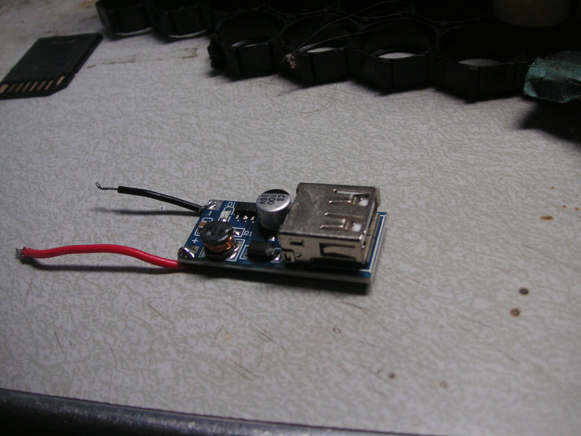

I bought a couple of these bare USB supplies. They run off 12-60V. Not really thinking about it, I attached one to a 8.4V 5AH power bank, and it ran it down over night. I checked the current draw and it's 200 ma at 8.4V.
I don't see why your model would be any different, except that at 48V, it probably only needs 1/6 the power or 30 ma. Thus in 24 hours, it would drain .72 AH. If you store the bike for 2 weeks, you could drain the battery if you left the battery on.

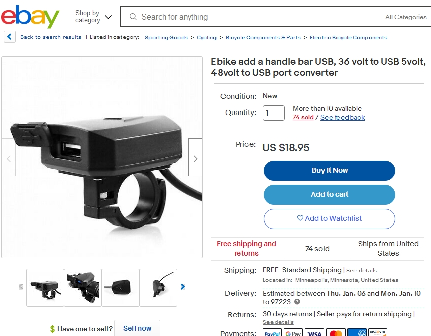

By the way, it appears eBay also has these USB ports.
