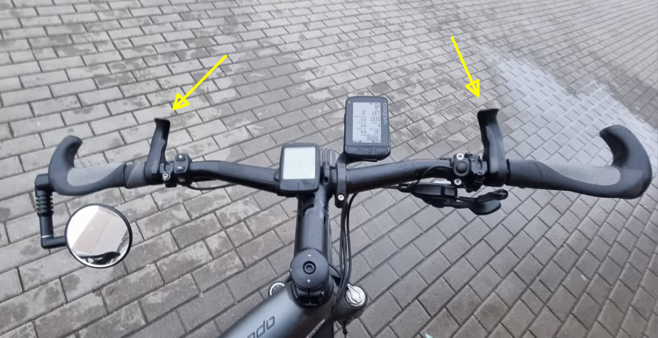

I rose the bar height on my Vado and Trance E+ when I was a noob. It took me a very long time to realise it was all wrong. Eventually, I have become my own bike-fitter for the Vado and Vado SL. Installing SQlab Innerbarends was the first step. I was gradually decreasing the bar height, and also installed pretty long stems on both e-bikes. All that put me into a sporty riding position with almost flat back. All my pains have gone.
