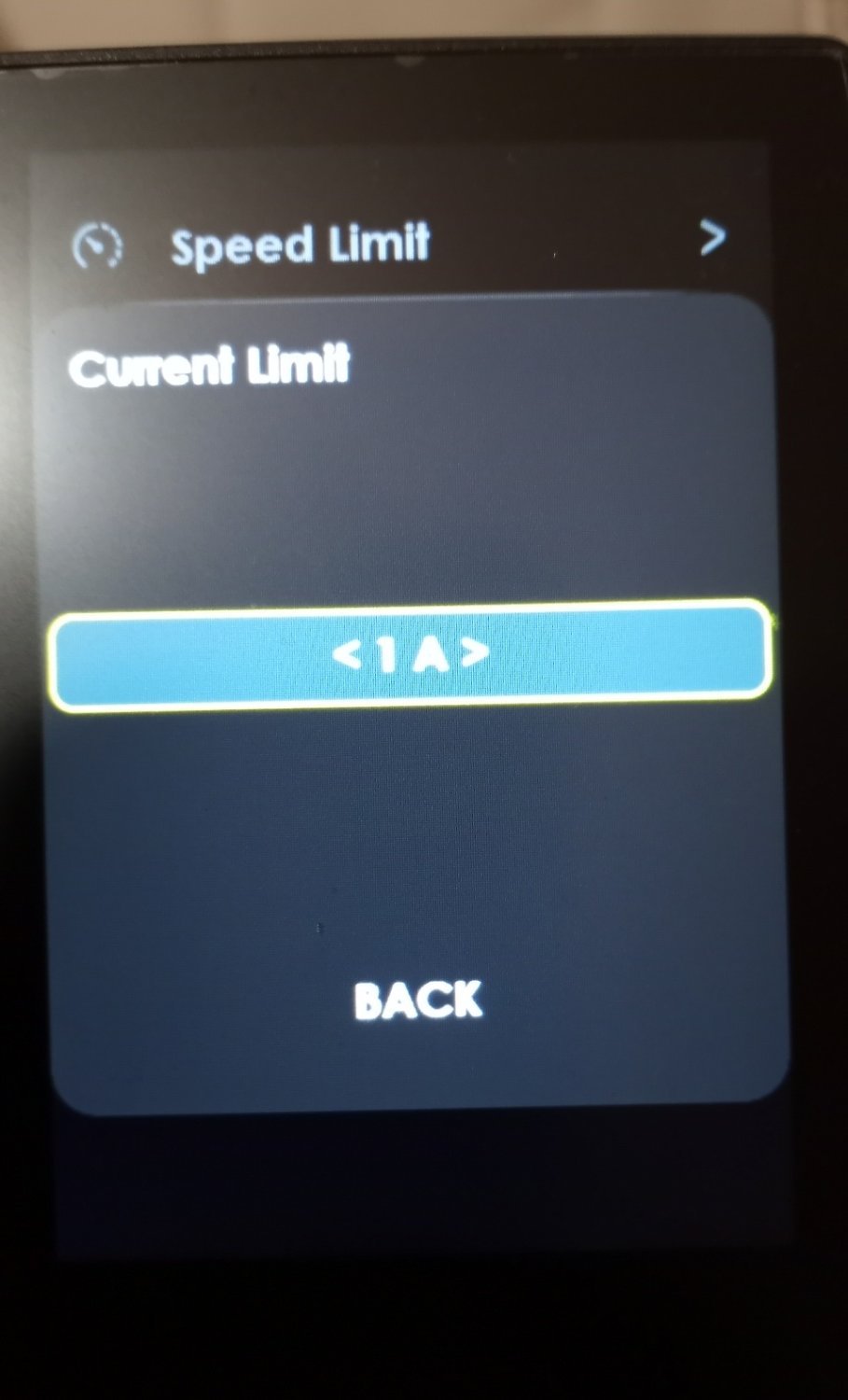

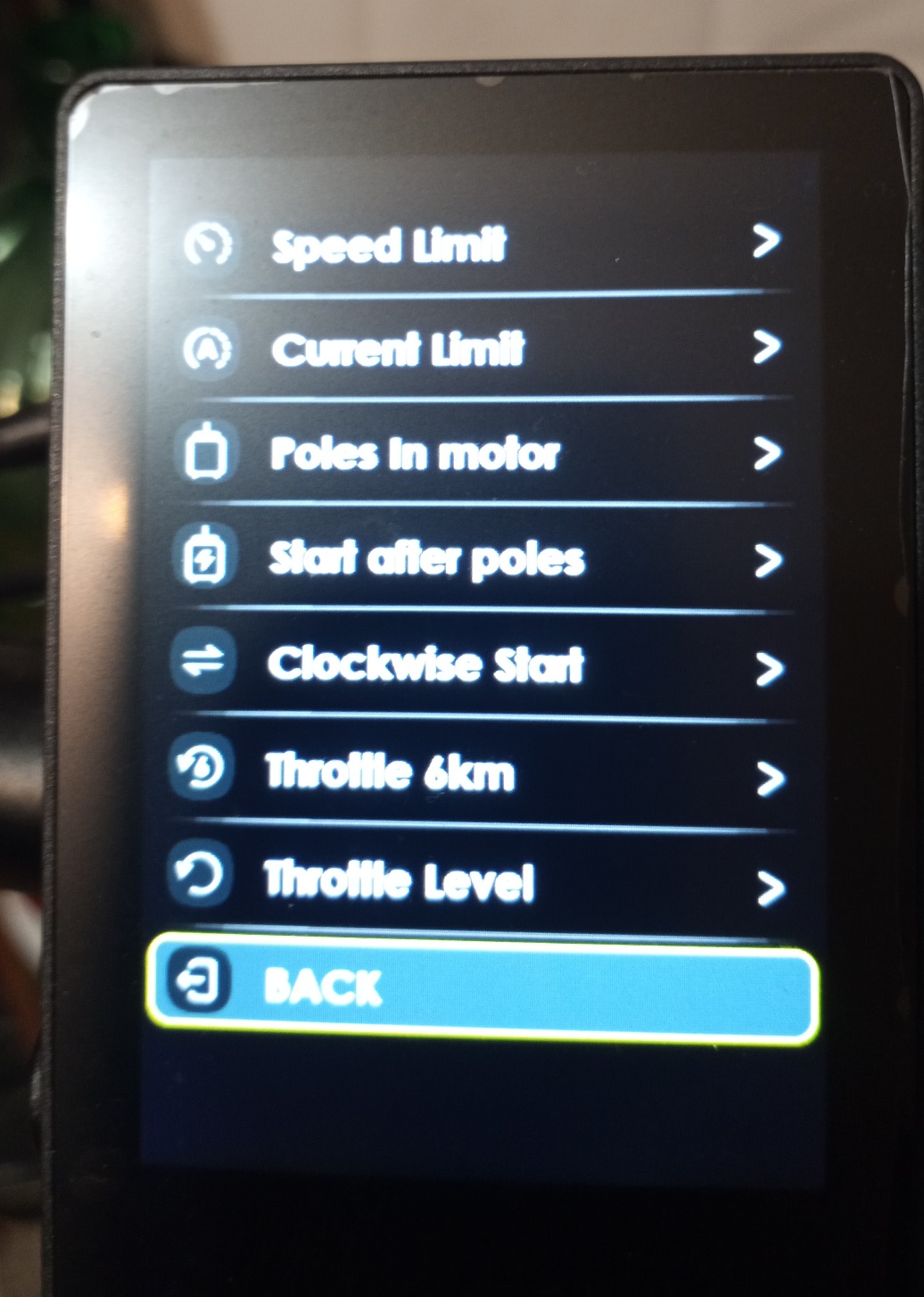

I have what I think is a UART Bafang programmable Controller/Display and rear hub motor?
I tried to turn down my maximum current and it doesn't work.
I set it to 1 amp and the current meter would still read up to 21 amps.

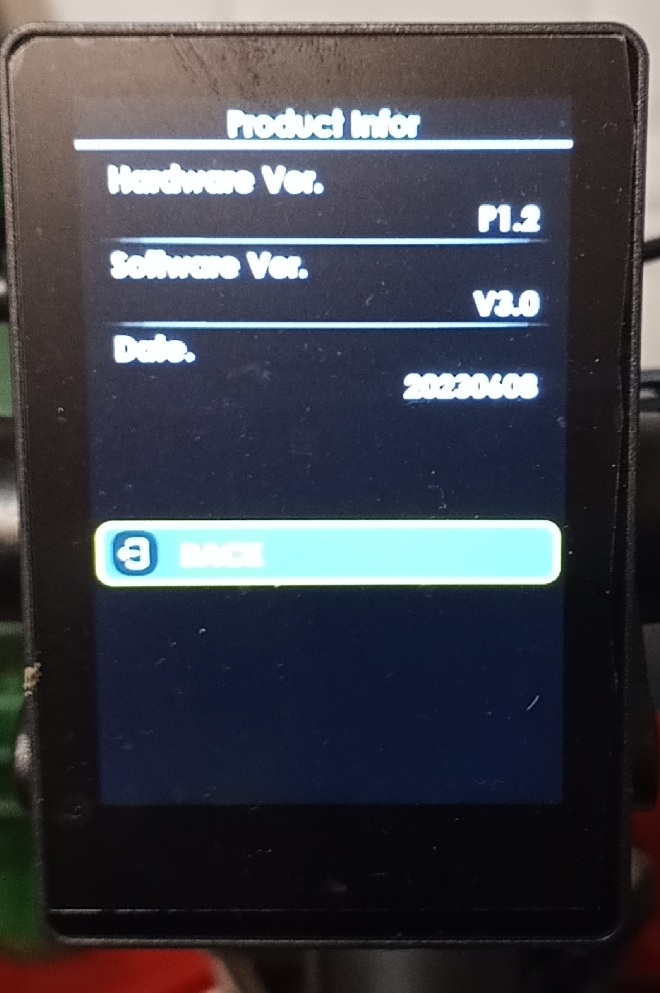

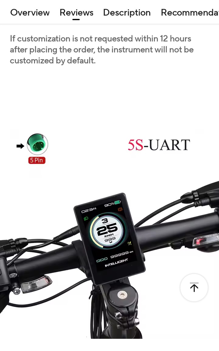

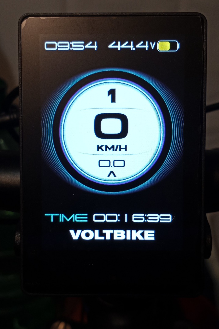

I have a Voltbike with what I guess is a proprietary display, but it looks exactly like the Bafang P860C display.
I was wondering if I could enable the maximum current adjustment with some sort of software update and a programming cord. (my display has a USB port, but I don't know if it's a two-way communication port?)
I found a Bafang programmable display with the male 5-pin connector, and was wondering if it could reduce my maximum current, or if it may not work with my controller?
Does anyone have any advice or information that could help me?

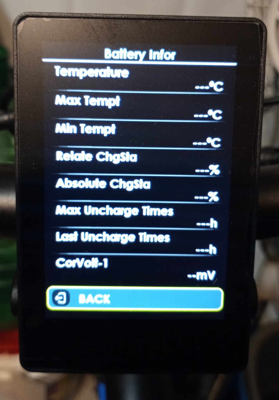

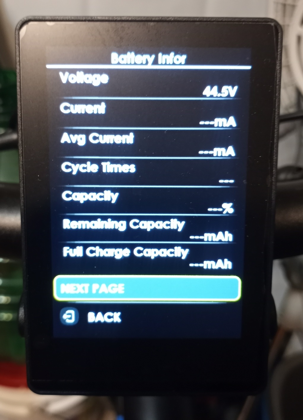

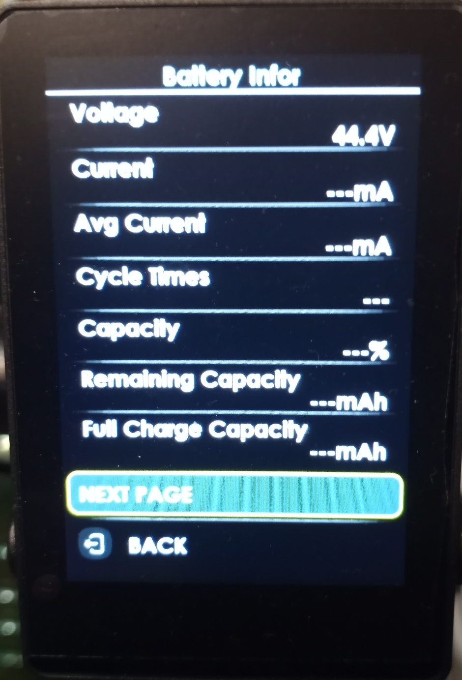

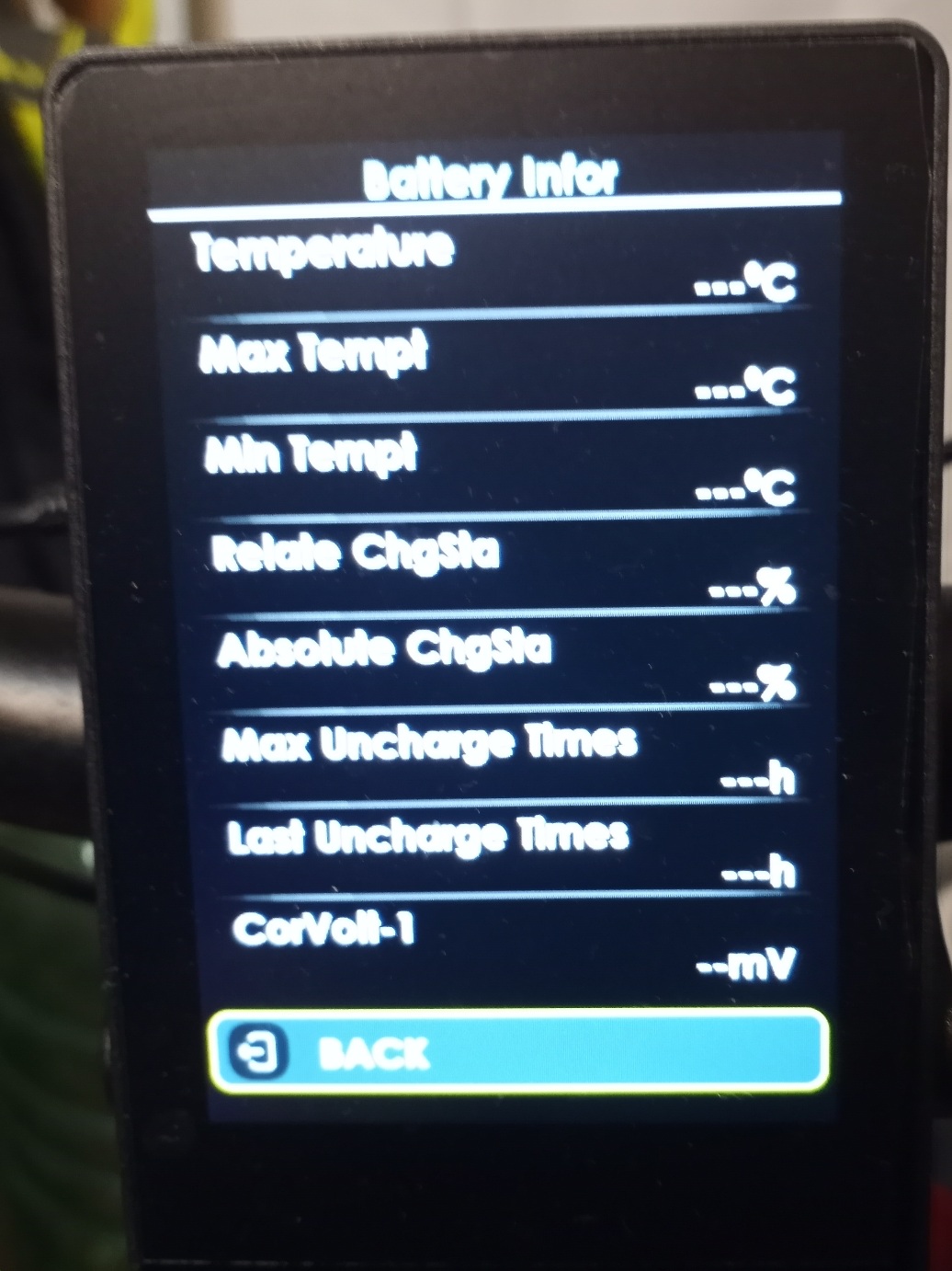

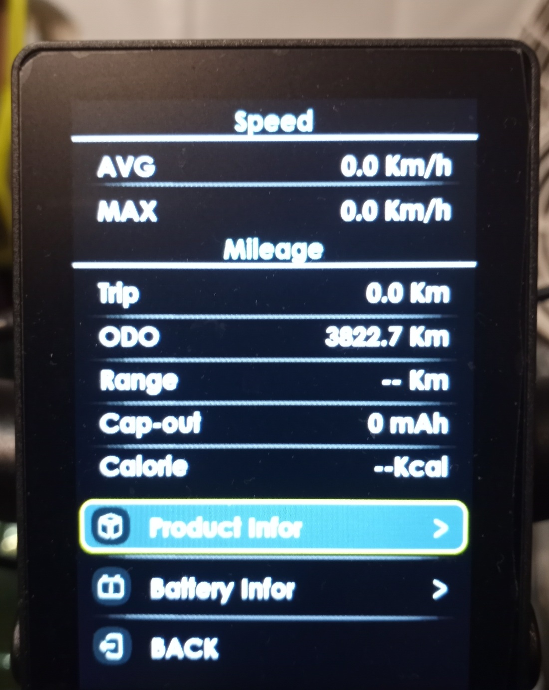

All the battery information on the display is blank, but I figure that's because I don't have a data wire going to my battery?
I do all the "programming" with the display itself, but I don't know if I need to program the programming to allow me to turn down the power?

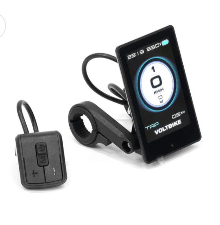

Unlike everyone else that wants to "smoke a Vado" and go Really Really FAST, (😂) ,.. I just want to micro-dose my current flow to go easy on my e-bike and all it's components.
I don't need 21 amps to go 20 MPH, unless I'm pushing into a headwind.
I want to turn down the power so it's not pulling 21 amps continuously if the headwind demands everything from my controller.
As far as I know the UART Bafang mid drives are programmable... Don't think the hub controllers are... but not really following the hub scene.
On the mid drive the current settings are done thru controller programming not at the display.
The 860 display isn't manufactured by Bafang but by 3rd party APT

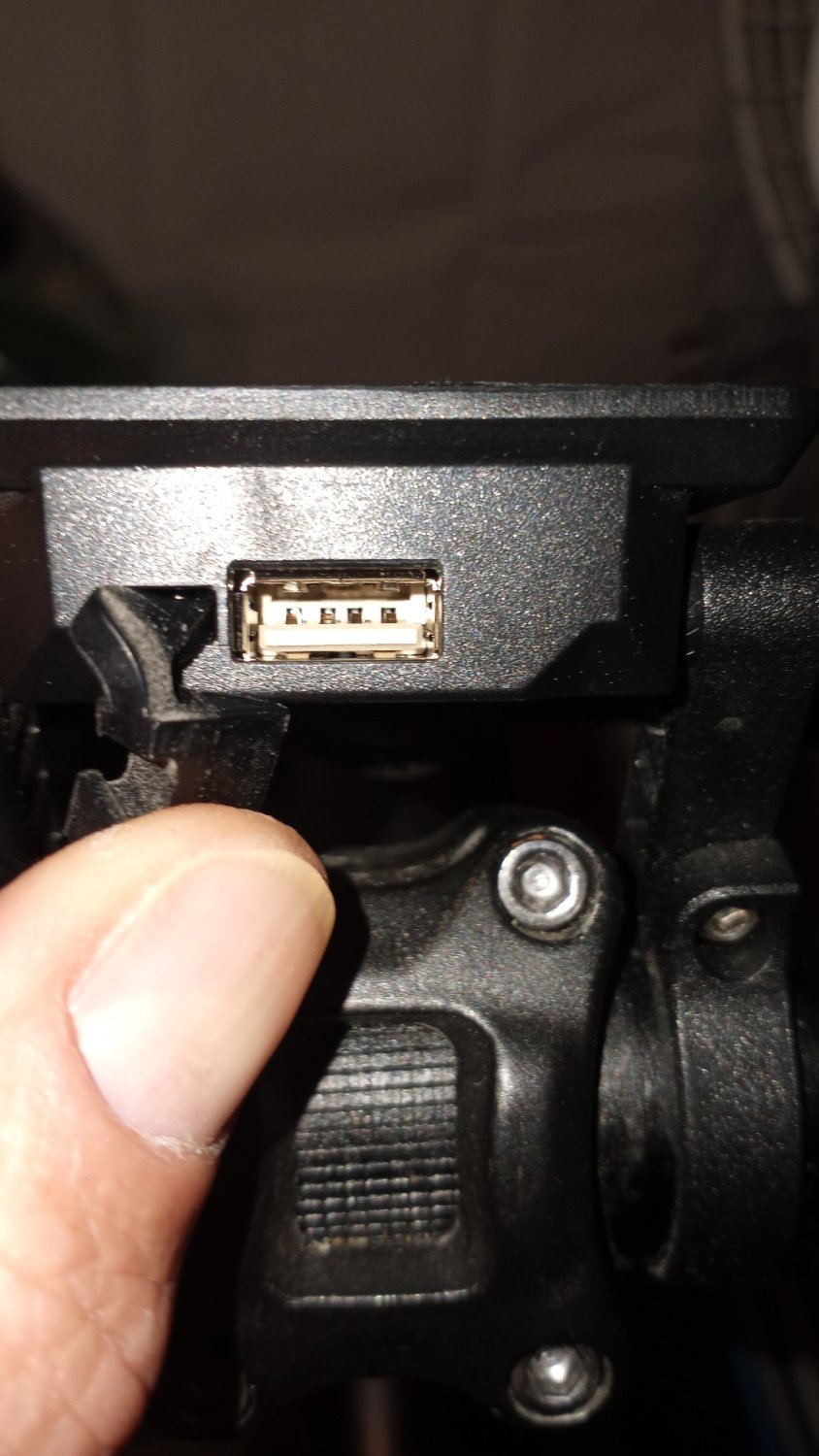

The display USB port is power out only, no communication.
Programming of the the display is done through the 5 Pin connector for such things like the brand logo.
Display Battery info requires a Bafang battery with a communication capable BMS... No third party batteries.
You might want to look into what Grin has to offer. Again not where my interests are so I'm not certain but I believe their phase runner might be capable of what you want to do..
