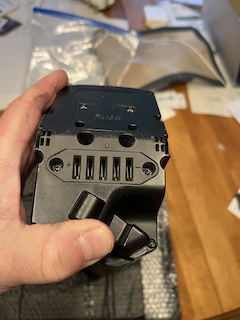

What I would like to warn folks about caused a situation that arose as a result of my riding through muddy/salty/slushy conditions. My 52V 19.2Ah battery has an exposed (unsealed) area, shown below, at the bike’s bottom bracket — when mounted on the RCS, that is. I’m talking about the 5 rectangle area in the picture which is next to the fuse compartment (which is sealed and is not a problem). I believe this area is some sort of charging port, but I’m not sure since it is unused for any purpose on the RCS.
Anyway, what I have done on my battery is duct-taped over this section to prevent contaminants from getting into the port. As, below:
What happened is that a fire started in the circuitry which ruined the battery, but luckily didn’t ruin the bike. I don’t think any Lithium got ignited, and I was able to quickly put out the fire which started shortly after I pulled the bike over after riding through some salty slush on the trail and then on the road. The taped-up battery shown earlier is not the one that had the fire.
A picture of the one damaged by fire is below. This battery is kaput.
Anyway, I strongly urge folks to cover over that port so nothing can get in the battery.

It’s weird, Jeremy. The battery is a wonderful piece of technology, but leaving an unsealed area like that (which exposes circuitry) I don’t understand. I also exacerbated the problem by riding without the fenders, so I partly blame myself for the situation. Easy solution though! I just wanted to let folks know.
Perhaps that “port” is a diagnostic port or a fast-charge port. The reason I think that is that after the fire the battery worked fine but the charger no longer works. Also, the plastic has a “+” and a “-“ on it. Anyway, I’m disposing of the damaged battery.

I found out what this “port” on the Juiced battery was meant for… It was designed so that the G2 battery could be plugged into their docking station for charging the battery and other purposes, as I suspected. The idea was a good one, but unfortunately this should’ve been done with some sort of sealed connector. Oh well.
So, FYI, the only information I could find on the docking station was in the link below. I have no idea if Juiced ever released this to the public.
