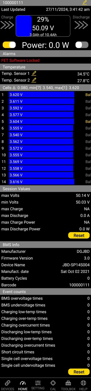

The BMS seems to be working, showing all settings, can see it balancing and settings are editable via xiaoxiang and overkill bms apps (overkill so much clearer, without erroneous, double entries [multiple "cell num" entires, I'm looking at you], so based on OKB now. With some balance help I manually got all the cells all within .100mv (see img).
The 2 key things I need help with:
1. The BMS isn't allowing/showing any charge input. This could be due to my settings, that my cells were too far from each other, or something else - I'm charging with a 54.6 3a charger as I try to find the laptop power supply that i will canabilise/step-up to a 52v charger.
2. Any advice, gotchas, etc on my BMS battery settings (see img)?
