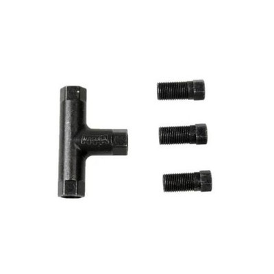

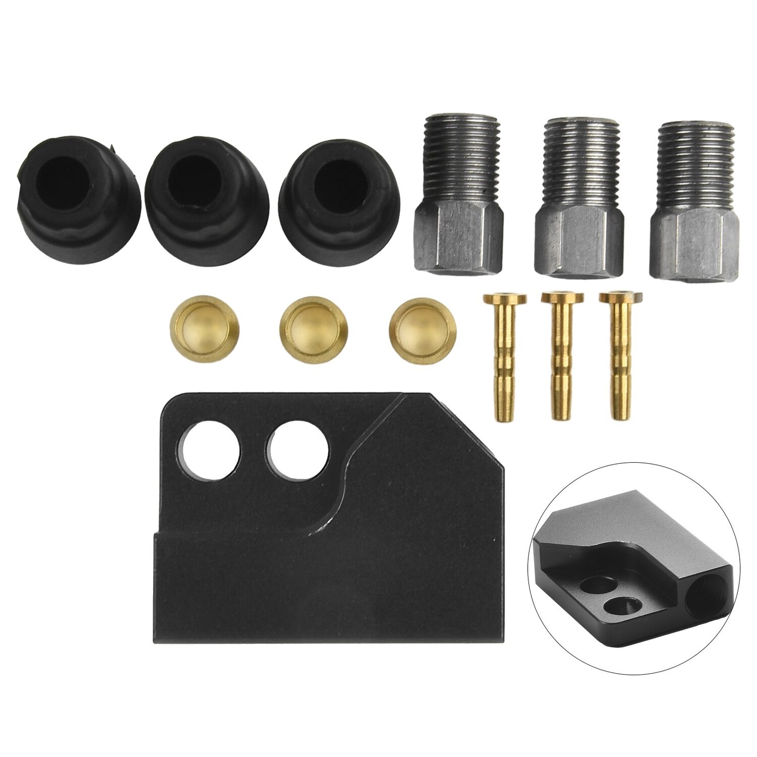

You may be able to get both brakes to function with one lever with something like this...
or
https://www.ebay.com/itm/315019239514?_skw=Bicycle+hydraulic+tee&itmmeta=01JCQGA04AHKDZ3F19EDFQNA2B&hash=item49589c205a:g:dXIAAOSwolVlc7tJ&itmprp=enc:AQAJAAAA8HoV3kP08IDx+KZ9MfhVJKmAquPREx7KUed1TeYO9/UJ1Cd4SffSqEMDcKPZ+o6mRO3yaqIlIf2+vR2dwRlDzi1icfhKwYG6HP32mbIawV4P1bEJcH5VK477Qb1hUonDm1c+aR26YRRXT2vLUWyNN5wo09iQX46gKuaS1SRBCZtZtPPFOGiOWJk+1VVFa8OVarWrz+UHmmBgYYiRodW6W5i2BulP0g2bGFH8YqEDdlaTQe2FPKMFJWjekdBrZIwBZBMbU/EZZqKFmcu0z0FSqT1AZEdl/8qSC606GpwQ+O8NlRvFiOOoijFlZsBjif7wzw==|tkp:BFBMsIKo8OVk&var=613503194290
but that would involve professional installation and adjustments to balance the breaking force.
I would assume centering the Tee so that both front and rear lines are equal legnth would give equal braking force.
You'll have to match tubing diameter to the Tee fitting so any brake manufacture information you can provide will be helpful
or

So then @Extreme1 suggestion to swap the levers is a good place to start. Having dual rear should be adequate.
If not you can duplicate the rear installation that has a tee to incorporate the front as well.
If you're unfamiliar with how to work on hydrolic brakes, have it done by a professional. It's not difficult at all but does require some special tools and needs to be done properly to eleminate any air in the lines.
