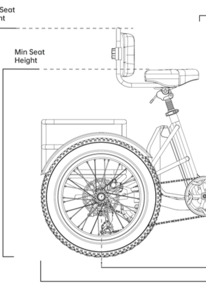

tricycles, is it possible?
Hope Tech 3 DUO Lever
Anything is possible but these are designed to work with their calipers and brake line. So you may have to replace the entire braking system if it can't be easily adapted.
Your current brakes most likely use a standard 5mm plastic brake line with standard fittings... though there are a few variations by manufacturer.
See if you can find out exactly which brakes are currently on your trike. I'm guessing you have a very basic entry level braking system like those made by Zoom
Thank you
2 calipers, I need 3 calipers(tricycle) 😀

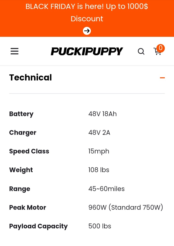

Q1. What ebike do you have, make and model? A photo would help.
PUCKIPUPPY, Husky Plus, with dual batteries
Amazon : https://a.co/d/5Nkqg1W
Q2. Do you have disk brakes
Yes, hydraulic disc brakes on both the front and rear wheels
Q3. Is the bike in good repair — especially the brakes?
New
Q4. How much do you and the bike weigh together?
200 lbs(me)+Bike Weight 108 lbs= 308 lbs
Q5. How fast do you typically ride?
Slow, 20 miles per hour
