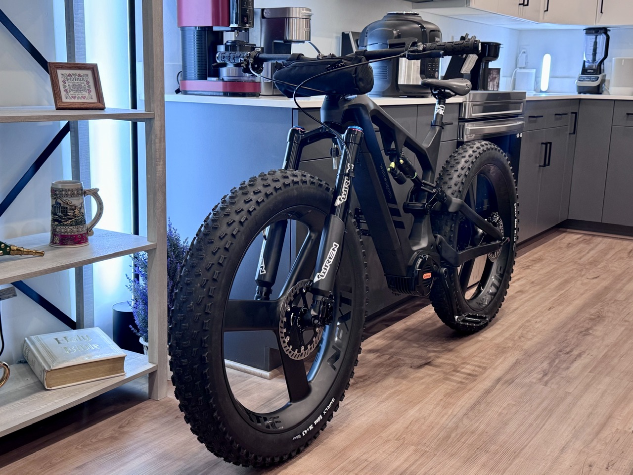

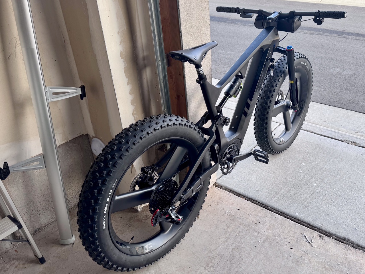

Project Fat Hydra Revive has begun! I’m not getting into the background story because it’s just too long and I’m past it now. I‘ve had the frame and motor from this bike sitting around and collecting dust and I’ve been wanting to do something with it so I’m not out the money I spent on it. In my research I found that the frame is a Dengfu e22 frame. See links below. With this info I can now get a new battery to use in the bike. I’m still going to use a 52v 17.5ah battery. The motor itself I’m looking into dropping the power for reliability and better range. The motor is the 2300 watt version and I’m hoping by changing the controller I can drop it to 1500 watts which is more than enough power. At the 2300 watt level I feel it’s just too hard on standard bike parts that aren’t built to take that much power. Plus it should increase the range greatly. Luckily I saved most of the parts from the bike so it should be easy to duplicate except for the handlebars. They are on another bike I built so I’ll use standard MTB flat bars on the rebuild. If the controller swap won’t work I’ll get another Bafang Ultra motor from Hi Power Cycles @ 1500w and a battery as well or the Luna Z1 is the same exact frame so their replacement 48V 17.5ah battery should work but I’d need to change the voltage on my motor.
If this works it could also be a way to go for other Hydra owners who are having problems and can’t get any support from WW as they are now out of business.

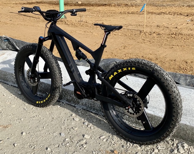

So I‘m keeping the power level at 2300 watts. I’m using a chain so hopefully it will hold up. I did find out the frame is a Dengfu E22 with a different rear triangle for the fat bike. Any motor and battery kit for the E22 will fit the frame. Also suspension linkage parts you can get directly from Dengfu. It’s actually the same exact frame as the Luna Z1. At least with this info WW Hydra Gen 1 owners aren’t completely screwed.
Bike is done! Keeping the 2300w power level and having HPC build me a battery to support the 60a peak needed for that level. Have to wait for the battery until after the holidays but man it will be good to have this beast back on the trails.
Pretty badass-lookin' bike! Love the wheels.

Looks good.

Looks good.

Hi Power Cycles is building the battery. I have their 1800 watt Trailblazer which is an awesome bike. I know they will make a battery thats more than capable of handling the power.
What I’m stoked about is now that the frame the bike uses is known owners can get motor/battery kits from multiple vendors with power ranging from 1000w up to 2000 plus. I’m not sure what frame the Gen 2 uses but I’m not sure how many of them were built.
