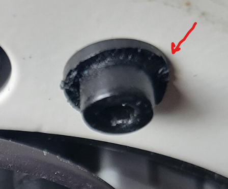

The cover, which is technically the cover for the wiring, has come completely detached. Before I pull the crank arm to really investigate, has the occurred with other Photon Pro users?
Will I need a new cover because it was attached by the screws? Is there another method to attach this cover?

More than likely it was over tightened when installed. . My experience is they use power tools when not appropriate.
There should be a little blue thread lock on the screws so they can be just snug enough but still won't back out on there own. A small plastic washer or even an O ring can be added to the bolt to keep things snug without being over tight
You'll need a new cover as it looks as it's broken at the bolt hole.
Assuming the area shown is the only one that is broken just fill the hole with silicone and it will glue it in place. Will at least help until you can get a replacement. When you do get it you can just peel out the silicone. You might want to back off on the other attachment bolts and do as suggested with the loctite as well.
I’ve had good luck with the two part super glue (lepages in my case) on plastic that refuses to bond with other glue. I would try that perhaps along with the silicone too after it’s all back together. No need to have these overly tight as it looks like it’s only a weather shield?

The details on this photo appear on review to show that a part of the cover may have broken off from the cover. Perhaps this piece could be epoxied back onto the cover? This may salvage the cover and get you back on the road.
This is the first thing to try. Taking the screw out will reveal a “ jagged washer “ piece of the cover that should be a good fit back onto the cover. Epoxy is a great option if the plastic in question will bond with it. If not then the CA glue with the second part called “activator “ might. This glue is the best type for my pp model plane that I seem to enjoy crashing into many pieces.
