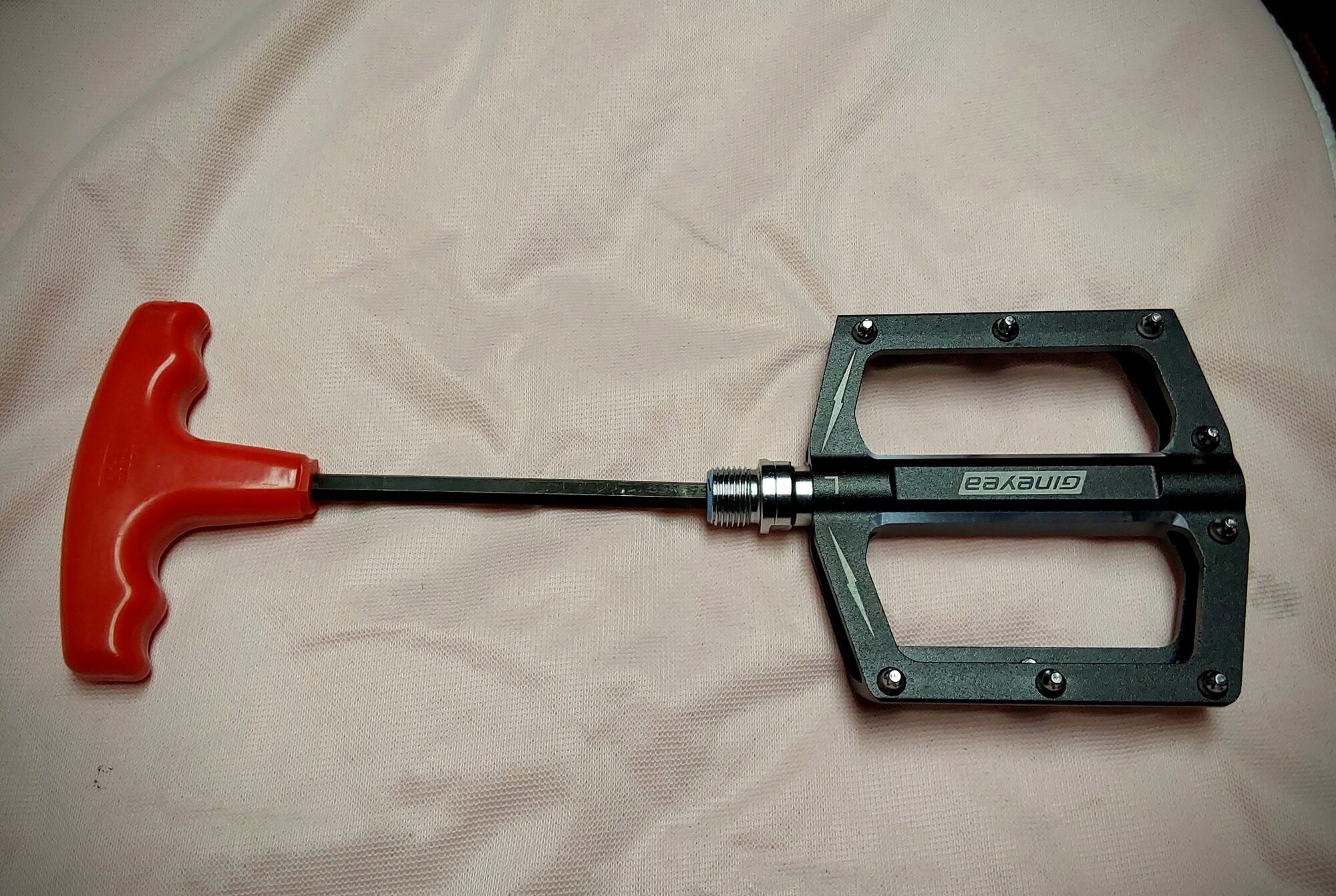

Most pedals have an Allen key on the backside of the shaft... That's all I've ever used.
I usually just use a crescent wrench. I’ve never tried using the Allen wrench on the back like that. I should try that and see if I like it better. I swear, there really is more than one way to do everything.
I have a few pedals that use allen heads, but most are 15 mm and it usually needs to be thin. I think you can get one for under $10 at Lowes.

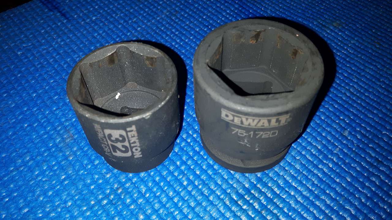

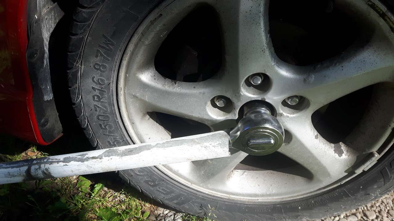

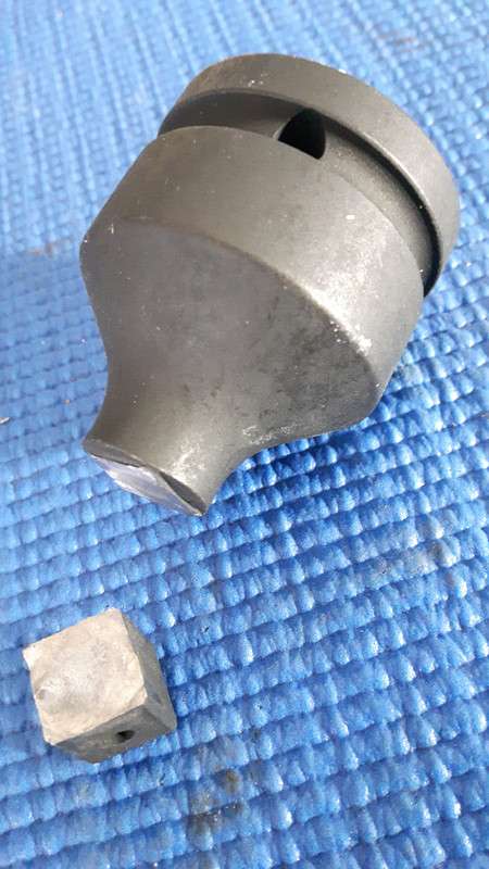

I over torqued my axle nut and broke my ¾" adapter trying to remove it.
I had a 4' pipe extender on my ¾" socket wrench and jumped on the handle.
I had over 600 ft. pounds on the nut. 😂
I had to wait a month for a ¾" drive socket to arrive.
I spent over $100 on sockets and adaptors. 😂

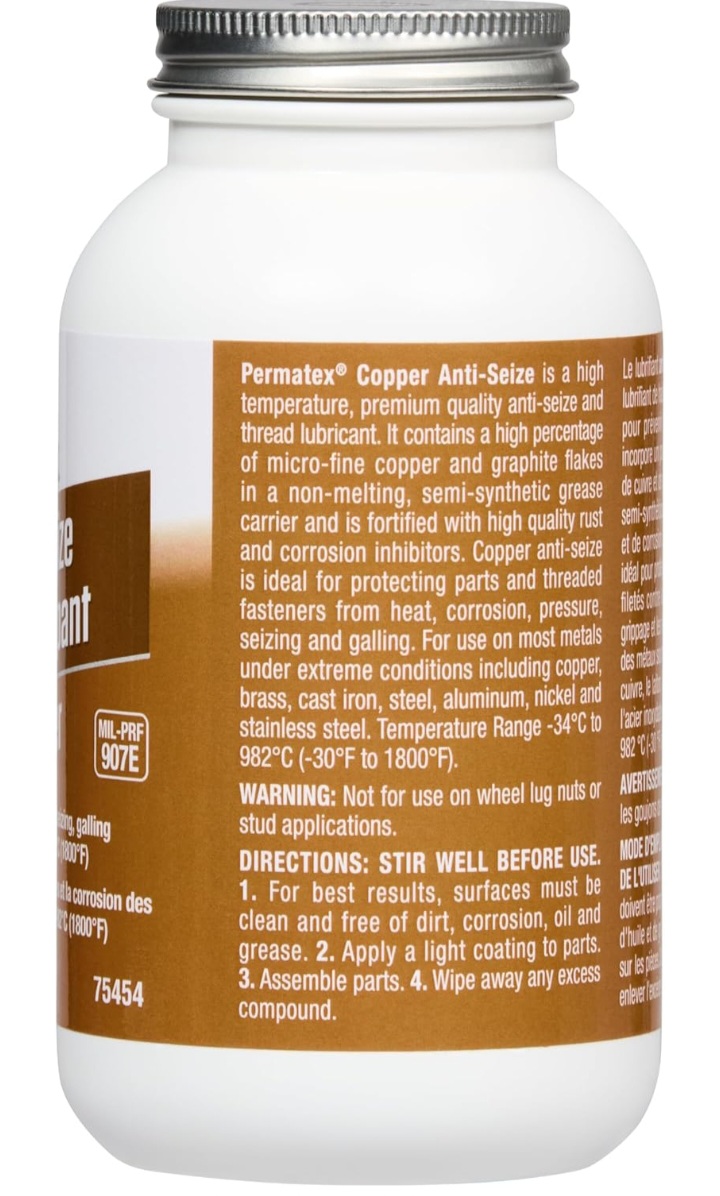

The anti-seize paste is even better :)
It's time for me to buy more anti-seize.
My little can from the 80's is almost gone. 😂
I noticed that there was copper and silver anti-seize.
The silver is rated for a lower temperature than the copper.

I'm gonna get the silver.
I think it's thicker and I doubt my e-bike will get hotter than 1600° C.

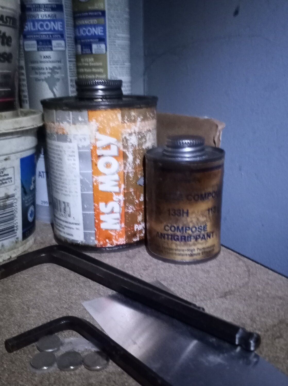

I have a can of Permatex silver anti-sieze that is 30 years old. It is used up. I have not seen another for sale in an auto supply for 30 years. The auto supply is selling copper anti-sieze from somebody else. I have a can of that out at the summer property.
Had to cut a clutch adjustment nut off the rod of a tractor with a file this summer: Turned the ears of the nut off with a tubing wrench I bought special to match the 17 mm nut, even after heating. 4 hours on my back of wheaky wheaky wheaky. It is the wrong distance off the ground to use a grinder. Too high to lift the grinder up from the ground: too low to sit up. I do not have a lift for tractors. If I booger the rod threads I could order another, maybe, from Japan, which might ship in a year.
My friend gave me that beat up half used can of MS MOLY 20 years ago but I don't like it, and never use it. It's labeled anti-seize but it's not the same.
I'm hoping that a new can of #133H Permatex Silver will be the same as the my old stuff.
It's got the same product code.
I hope they didn't change the recipe?
