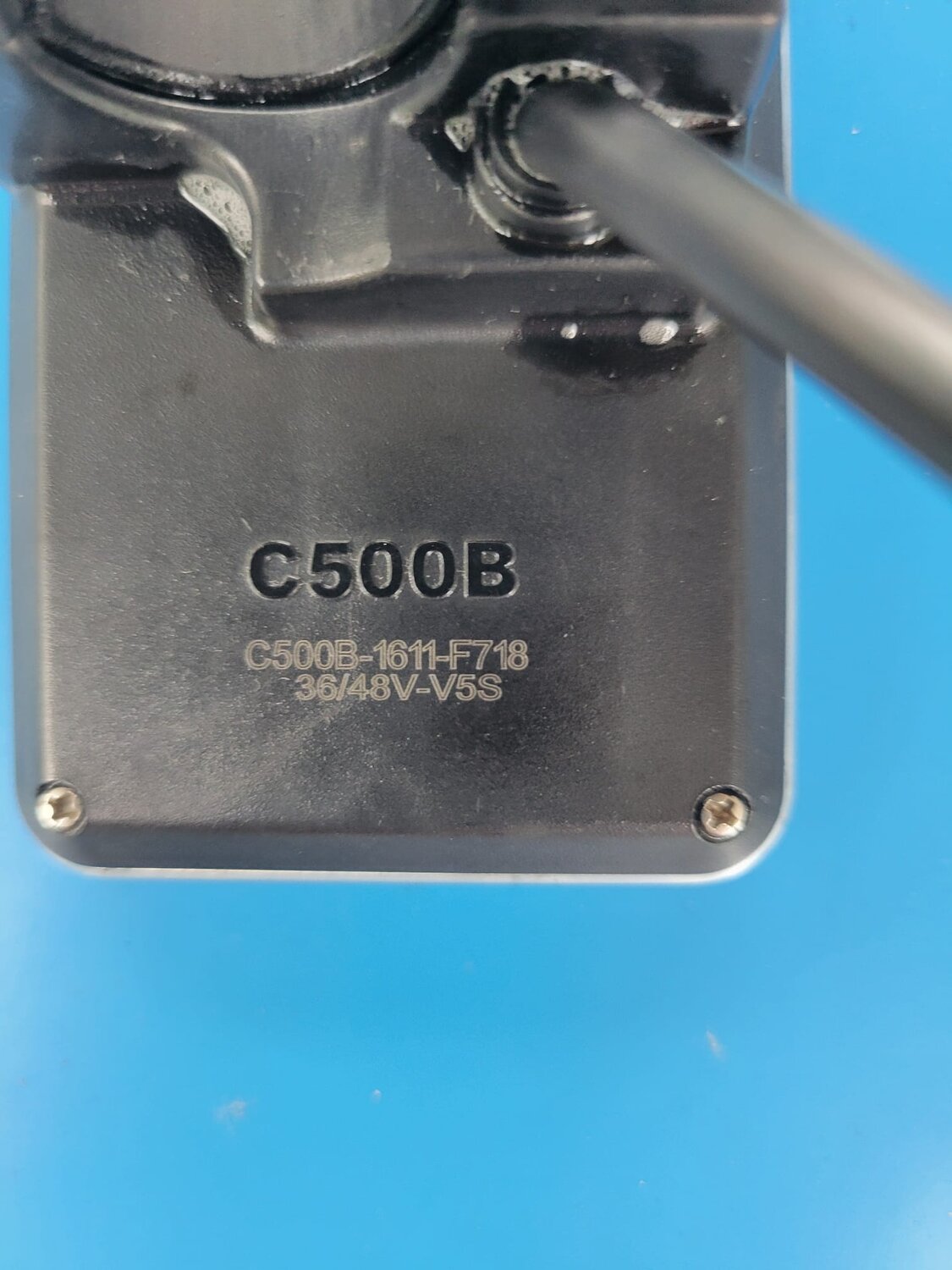

Hello forumers, I have a Green Bike GB1 bike bought in 2017. The display is giving an error code 9 and the motor doesn't get power. The battery is charged.
I'm trying to find information to service it like wiring diagram, error codes list and anything else that could help.
The controller is a LSW905-27-1.
Thanks for any help.

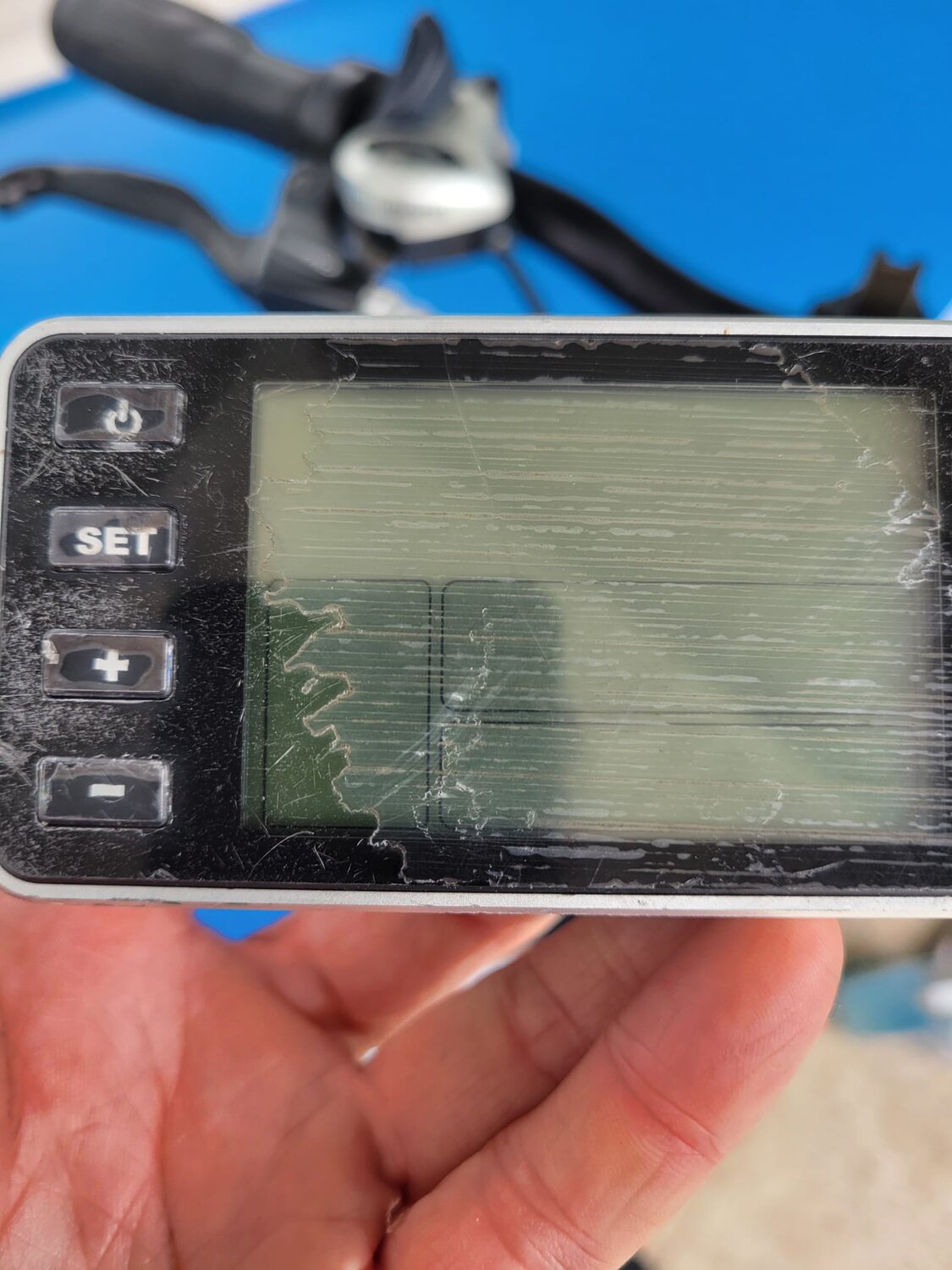

Error codes are specific to the display. Look at your display model and google for a manual on it. Being that your control starts with LSW... that is probably a Lishui controller/display. Then you can see what Error 9 means. I see no display on your handlebars though, It must have one to flash an error code.
It must not be a popular display because googling Error 09 gets no hits.

The display says C500B-LCD, for which I found a manual in manuals.lib with the following error codes table:
0 Normal
1 Current error or MOS damaged
2 Throttle error(Start detection)
3 motor no phase position
4 Hall error
5 Brake error(Start detection)
6 Under voltage
7 Motor stalling
8 communication controller receiving error
9 communication display receiving error
My error is 9. Should the error be 8 if the problem were in the controller?

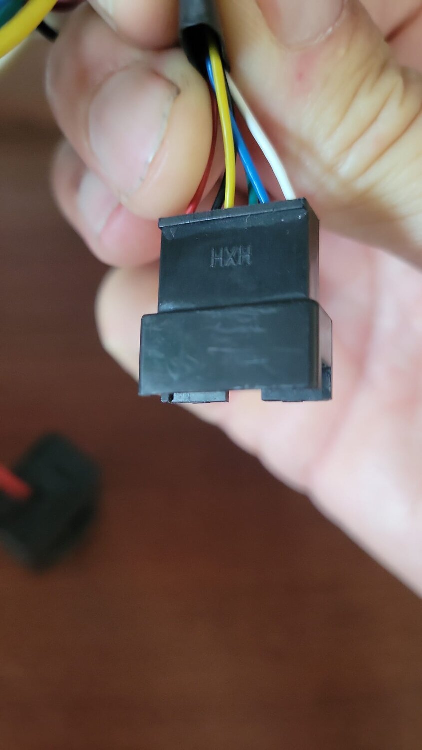

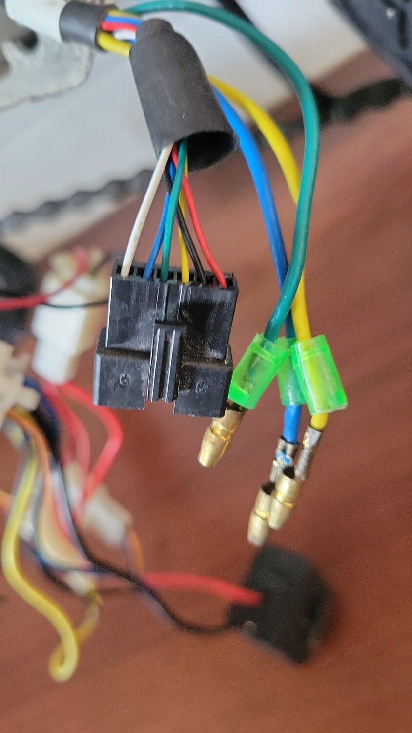

Now I'm trying to do the phase sensors test but I can't get the terminals out of the connector. that comes from the motor, and unfortunately I already managed to cut one of the six wires, so I may have to get a new cable anyways.
Does anyone know this connector and where to find a diagram or instructions to pull out the terminals?
Thanks!
1x6 JST connector. Terminals go in one time, and a tiny barb on them prevents any future removal. Often used on commercial ebikes. Third party replacement controllers use a 2x3 rectangular connector or use the 9 pin molded plug,
Don't try to pull it apart, Motors only burn out windings if you melted them and the phase wires would have melted before the windings anyway, Keep it intact, When you buy a new controller, you will probably have to transfer the old six pin connector to it and mate it to your motor cable. The alternative is to switch the motor cable to the controller's plug,
If you really want to verify the motor's Hall sensors, get some jumper connectors to slip over the pins in the motor connector. WIre them to your tester.
thank you very much! I'm learning as I go. I already pulled too much on that 1x6 connector and cut the thin wires, so I will need a new connector there anyways.

The speed sensor must be inside the motor if there's no magnets on the spokes. The connectivity is via the white wire on the above six pin connector. Hook it up in place of a hall sensor and it will pulse the tester when you spin the wheel.
^^^ What he said.
You can count the pulses for a full wheel rotation to find out how many speed magnets are in the motor.
Usually 6 I think, sometimes just 1.
