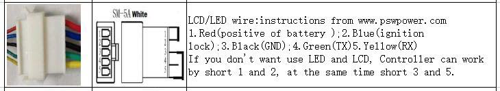

The KT controller doesn't need a display to run. They usually ship it with this jumper. That gives you throttle and one level of PAS. Is that how you originally ran the Cheetah?

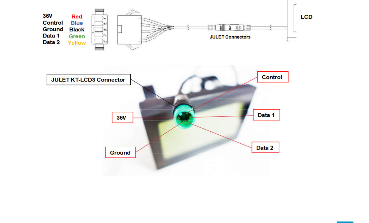

I see the CHeetah did come with an SW900 display. Did you use that? It turns out that displays usually use the same connector. Tis would apply to the S866 and KT displays. I've owned all three.
How they work is the display powers up on battery from the red/black leads. It sends battery power back on the blue lead to power up the controller. Data is sent on the yellow and green leads. The problem is everyone use their own data commands, so you get Comm errors when the display cannot understand the controller responses to its commands. Nonetheless, the KT throttle will be active, as long as the controller powered up.

First off, thank you HARRYS for replying. I think you are prob right on the money with one of the possibilities you said. I found out last night upon returning from a test run that now with the S866 connected, the throttle worked without the display on. Since now after swapping the blue and yellow wires (something completely illogical to most manuals) and the throttle working for the first time since this started, I'm trying to not only find out if or which module got toasted, but what electrical component can be replaced to fix said problem. If I got that far it would teach me so much about most controllers in general. Now since I swapped out the original "display" which was/is the LED B10 for the S866, it's never got full connection and always has given the E10 code along with the comm icon. So idk if I am even getting one way let alone two way communication. Being that I need this bike back on the road at full speeds, I'm prob gonna order a new controller or see if I can return this one. This is a KT, but only has the weatherproof juilet plug on the motor wire. Everything else is bullet for the power or DST for throttle, brake switchx2, lights x2, 5pin display and PAS.
