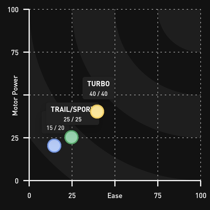

These are the same X%/Y% settings, only presented graphically and under new names. You can set the Assist (Ease)/Motor Power as you wish per a level.
These are the settings for my Vado 6.0 for the gravel group ride of today. The Eco is set for average traditional riders, Sport is for a little more diffiult surface, and Turbo of only 40/40% is for emergency situations, such as checking where the tail of the group could be and then going forward to join the group co-leader :)

"power" is the power output by the motor relative to the maximum possible; if the bike is capable of 500w of power, but you have the "power" set to 50%, you'll only get 250w no matter how hard you're pedaling, how fast you're going, etc.
"ease" is how hard YOU have to pedal to access that power. if you put the "ease" at 100, pedaling lightly will result in the motor delivering lots of power, up to the maximum specified in "power."
if you set the ease very low, you have to pedal much harder to get the motor to provide large amounts of power. this gives you multiple ways to tune the bike for different situations. let's say i want to go really fast, but get a really hard workout: high power, low ease. let's say i want to go fast and not work hard (like a commute, or i'm sick) : high power, high ease. let's say i want to do a long ride, not burn myself out but also maximize range : medium ease, low or medium power.
it's a good system (used by many other manufacturers) which allows you to dial the degree to which the bike acts like a non electric bike, control range, speed, your workout, etc.
you can assign different power and ease to each of the three modes, which are selectable from the buttons on the bike. you can also modify three different profiles, which are selectable from the app. each profile is a set of two values for each of the three modes, so really there are 9 combinations of "ease" and "power" which you can set.

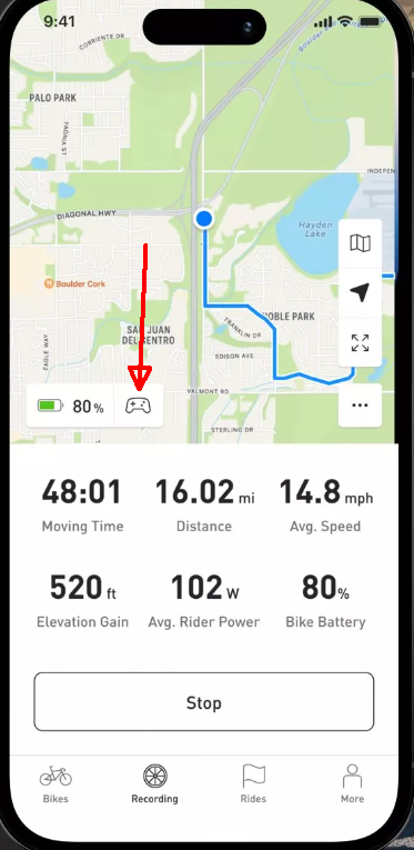

It does and can be activated in the new app, too. Please click the "Record" in the bottom toolbar. In the next screen, you will find a small section containing Battery Level and a gamepad icon. That gamepad icon is Smart Control.
Also gone are sliders for “Acceleration Response” and “Shuttle.”
These two features have only been valid for Levo and Kenevo and are invisible for other Turbo e-bike models.

In their animation they show Universal, Battery Friendly, and Racing--and they show single dots for Eco, Trail, and Turbo moving around as the 3 aforementioned tabs are alternating. But as we know, each mode has two settings, Ease and Motor Power.
Plus, what is this business about a "fourth" preset?
My prior assumption was that essentially you can customize 9 presets:
You have Eco, Trail, and Turbo--which while riding you can quickly jump to with your thumb. (And each of those can have any combo of Ease and Motor Power preset.)
Then you have Universal, Battery Friendly, and Racing--screens for which you can set up combos for each of the Eco, Trail, and Turbo settings.
3 x 3 = 9.
Thus I find what they wrote confusing.
And whoever wrote the sentence "Tapping a selected preset will deselect it and change all settings back to the custom values." should win the word-salad award for the day!
Trying to translate: "Tapping" means selecting, so selecting will deselect?! And that will change your settings back to "custom values?" Whose custom values? Yours or the bike's default values? Since when are default values called "custom?" o_O

they show a single dot for each setting because it’s a dot on a two dimensional chart. the two numbers you’re recalling are the X and Y axes.
there are three preset “sets” of values. if you move the dots in any of them, it becomes a custom set, which is essentially the fourth one. you can switch between the three they give you and the customized fourth one by tapping any of the standard three.
it works, just a little differently than the old system. more intuitive for some, less for others it seems!
