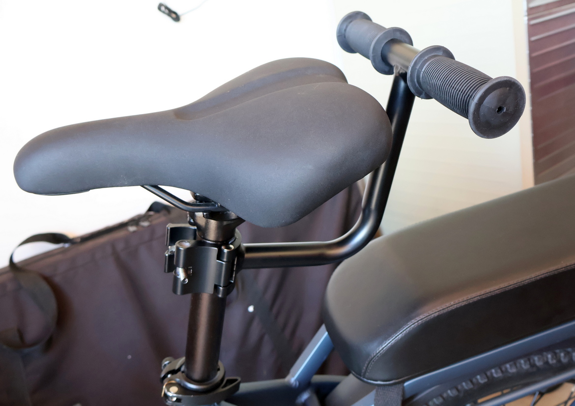

This is my first e-bike and I did a bunch of research on foldable ones and decided on this one. Only a few minor complaints. I got the upgraded battery and, IMO, the overpriced, passenger seat kit for the grandkids. I did get $40. off for signing up for their mailing list, more spam. They do NOT though give a miltary discount.

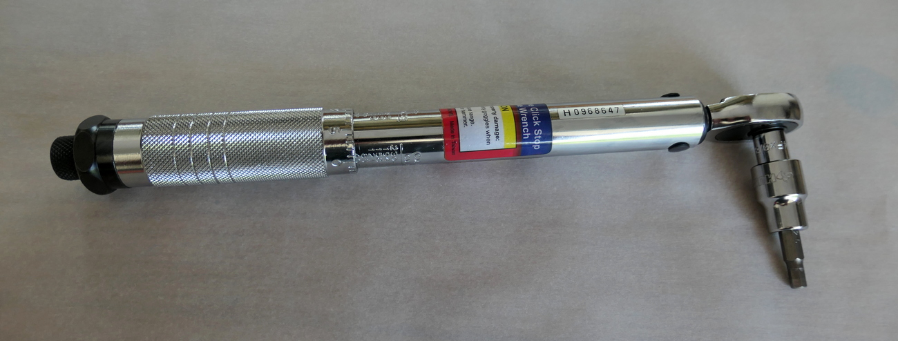

I used an in-lb. torque wrench/allen socket to tighten the stem cap bolt, 7nm=62 in-lbs. I have no idea what 7nm of torque, from owner's manual, feels like using the supplied allen wrench, snug?

Nice touch by Ride1Up of including a strap to keep the bike together when folded but it's a real PITA to get it snapped with the passenger seat on.

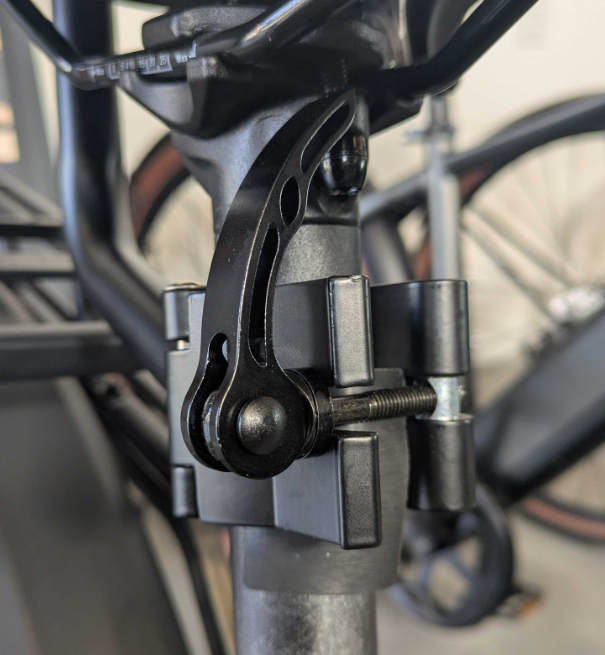

The frame latch when folded sort of flaps around and it's very possible that it could be snapped off. I purchased this velcro strap from HD to secure it. It's 18 inches long, ok, but a shorter one may also work. I sent Ride1Up an email about this and they said they were aware of it and were working on a solution. The solution is to include a velcro strap similar to the one I use.

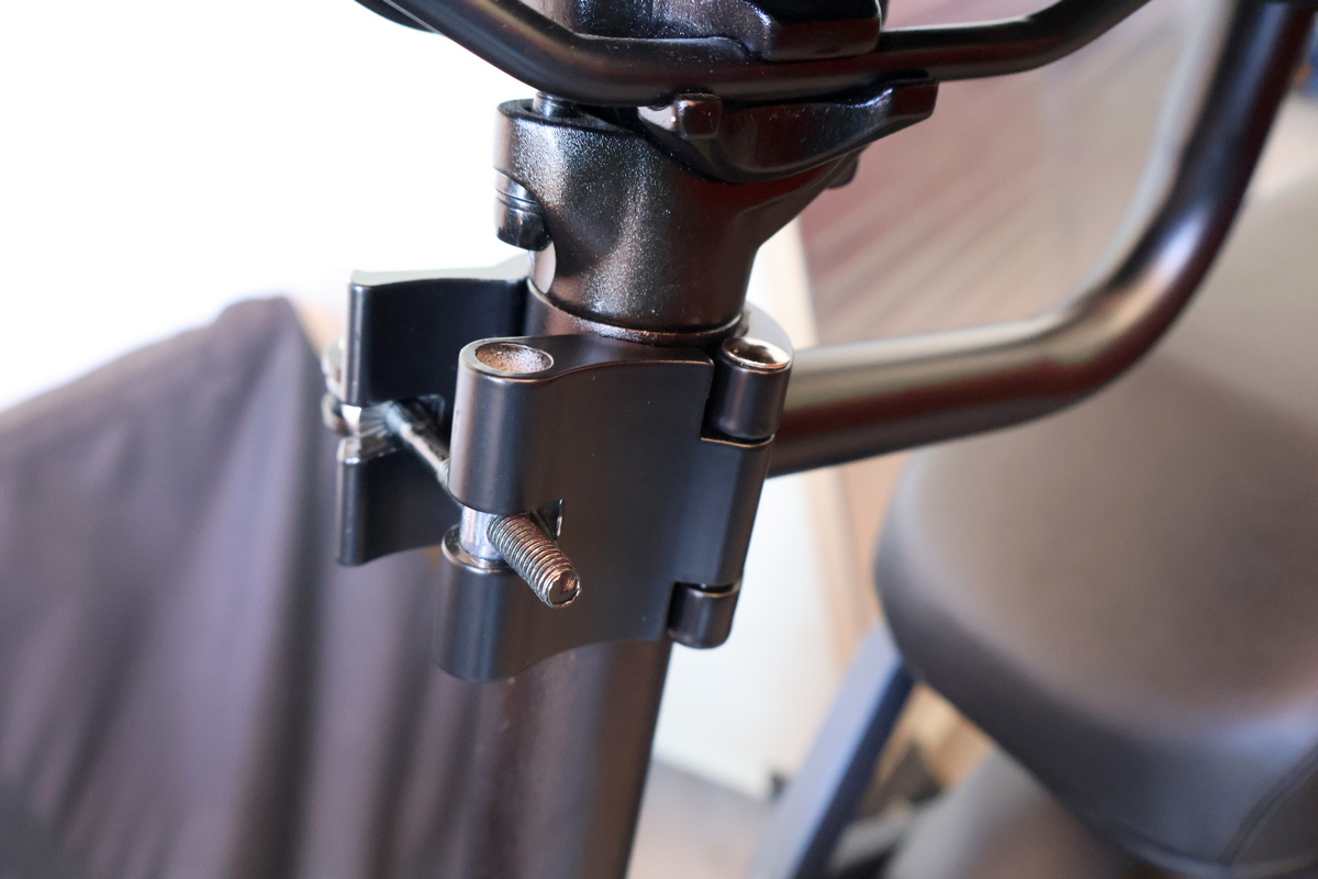

There are instructions on how to install the passenger seat but not how to uninstall it. I loosened the screw, pushed it, the latch, forward and lifted the seat off the back and up.

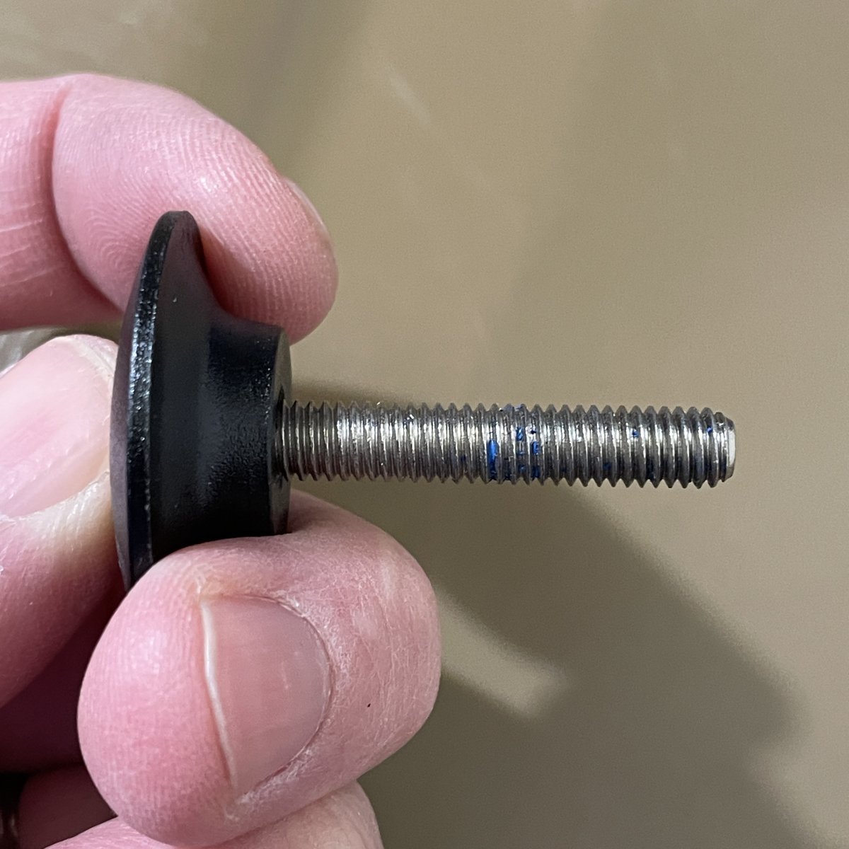

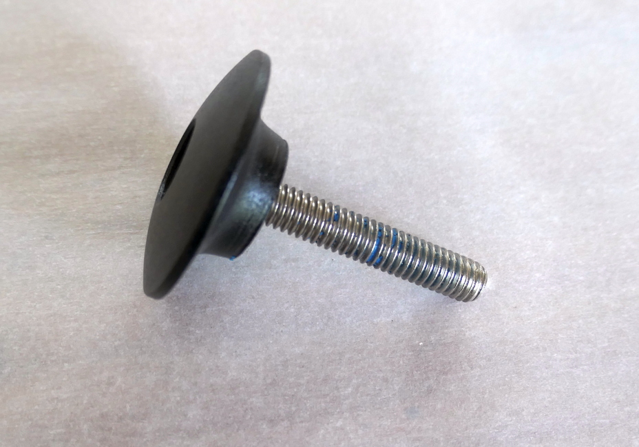

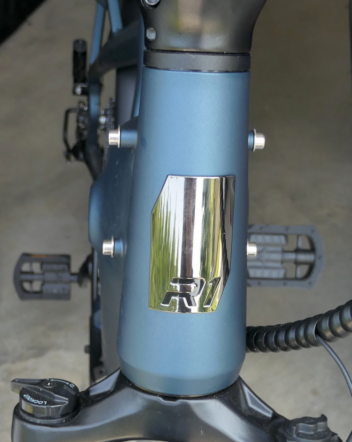

I was going to take the bike out for a ride last night when I noticed that there was some up and down play in the front stem post, not the shocks.
I checked the stem post screw, and even though I had tighened it during installation to 62 in-lbs with a torque wrench, it was very loose. Ride1Up had put some threadlocker on the screw but not enough.
A member of another forum also found the same with his Portola stem screw, not enough threadlocker on it. https://ebikesforum.com/threads/ride1up-portola-thread.5915/
I applied Permatex threadlocker on the screw and re-torqued it to 62 in-lbs (7nm) with an inch-lb torque wrench and a 5mm allen socket. I'll give it a few days to set before I ride it. Hopefully that will fix it but I will be keeping an eye on it. I suggest you do the same.

Glad to hear your Portola is running ok. Mine, except for the issues I pointed out, is now running great. For those that purchased or going to purchse this e-bike, make sure when you assemble it that you first put Locktite on the stem bolt. I also put Loctite on the derailleur guard bolt. Check that all bolts are tight. My front fender bolts, and one of the pedals, were loose. There is a Ride1Up factory tour video that praises their QC. Hmm. And, as I pointed out in my previous post, when folded, secure the frame latch with some type of strap. A shoelace will work. If you snap this off the bike is unrideable.
