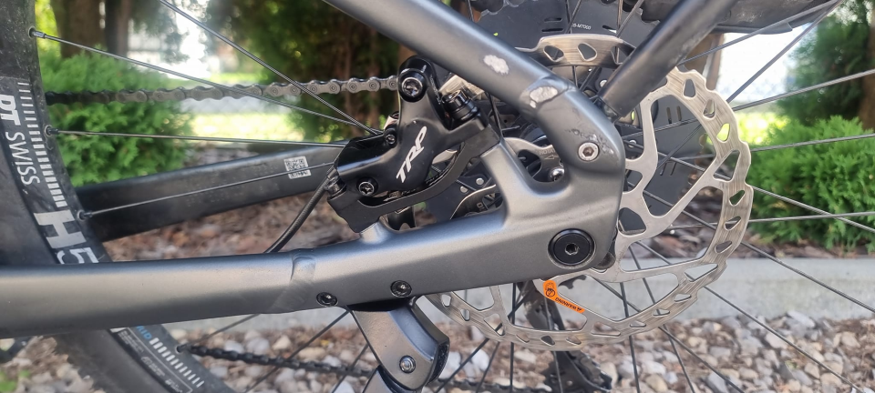

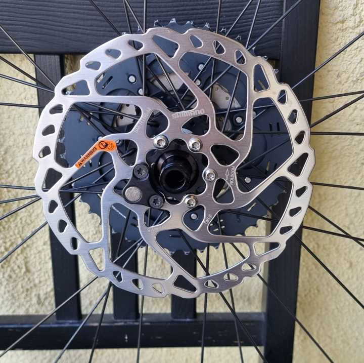

Currently, my Vado 6.0 has a TRP Zurich front brake, and the TRP Slate on the rear. These brakes are of the Post-Mount type, and I equipped them with two different 180 mm rotors front/rear. It is a Shimano SM-RT86 (Ice Tech based) for the front and a little less advanced SM-RT66 for the rear. Both are the 6-bolt type. The reason for installing the less advanced rotor for the rear was to ensure the speed-sensor-magnet-bracket would fit. I consistently use high-end TRP Q20.11 semi-metallic brake pads.
The SM-RT66 with the magnet bracket.

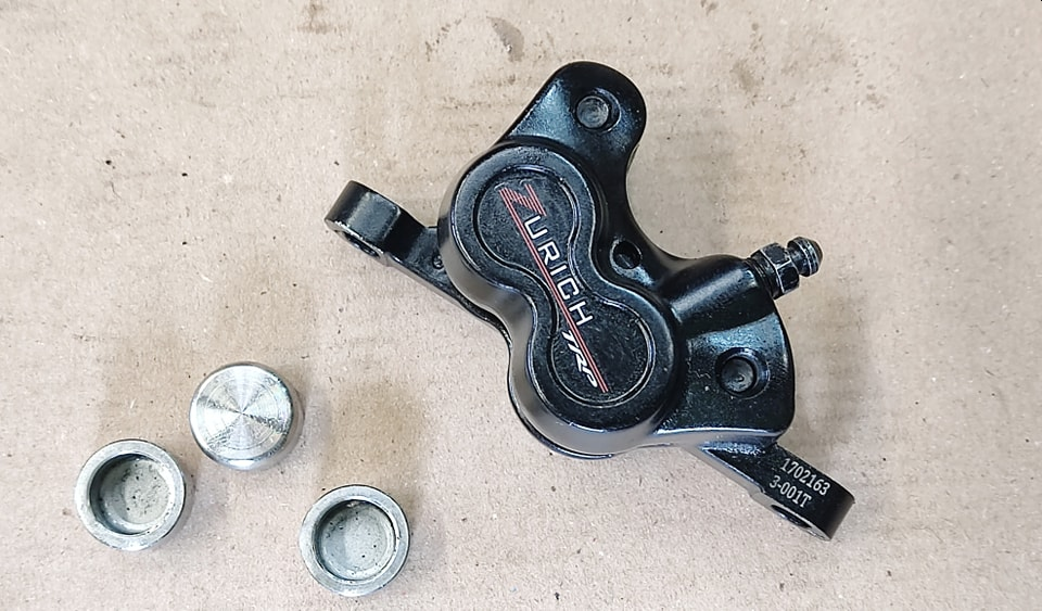

A TRP Zurich e-bike brake (discontinued) as dismantled for service and cleaning. The brake lever includes a sensor for the STOP indicator light.
A TRP Slate HD-M807 brake. Both Zurich and Slate are Post-Mount, 4-piston hydraulic disk brakes.
