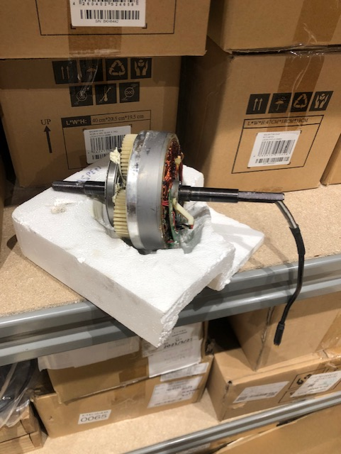

Another question, NCM said they could ship this without the case and this requires to remove spokes as well. However according to the video it doesn't look like you need to, am I right?
That should install in your old motor.
Your current freewheel will have to come off your old motor core and that requires some special tools.
Once the freewheel is off, you can get the motor end plate off to swap onto your new motor core.
There is a REALLY good chance that all you need is the planetary gears if NCM can sell you just the gears.
You won't know for sure what's wrong with your motor until you open it up, but the planetary gears are described as "wear items". The rest of the motor can last "forever" unless it rusts out or overheats.
It would be good to replace the wheel bearings while you have it apart, but the motor core doesn't look like it includes the bearings.

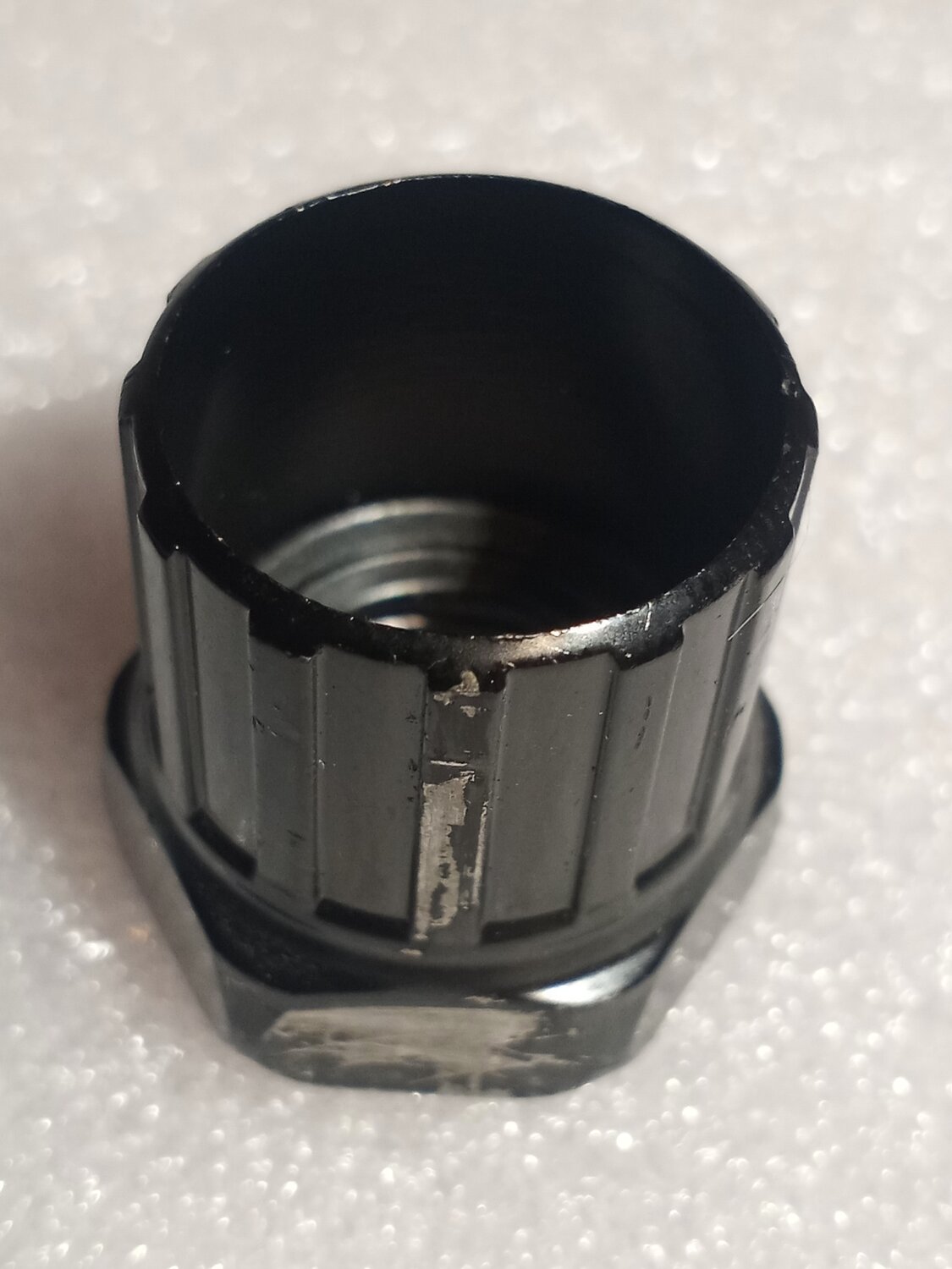

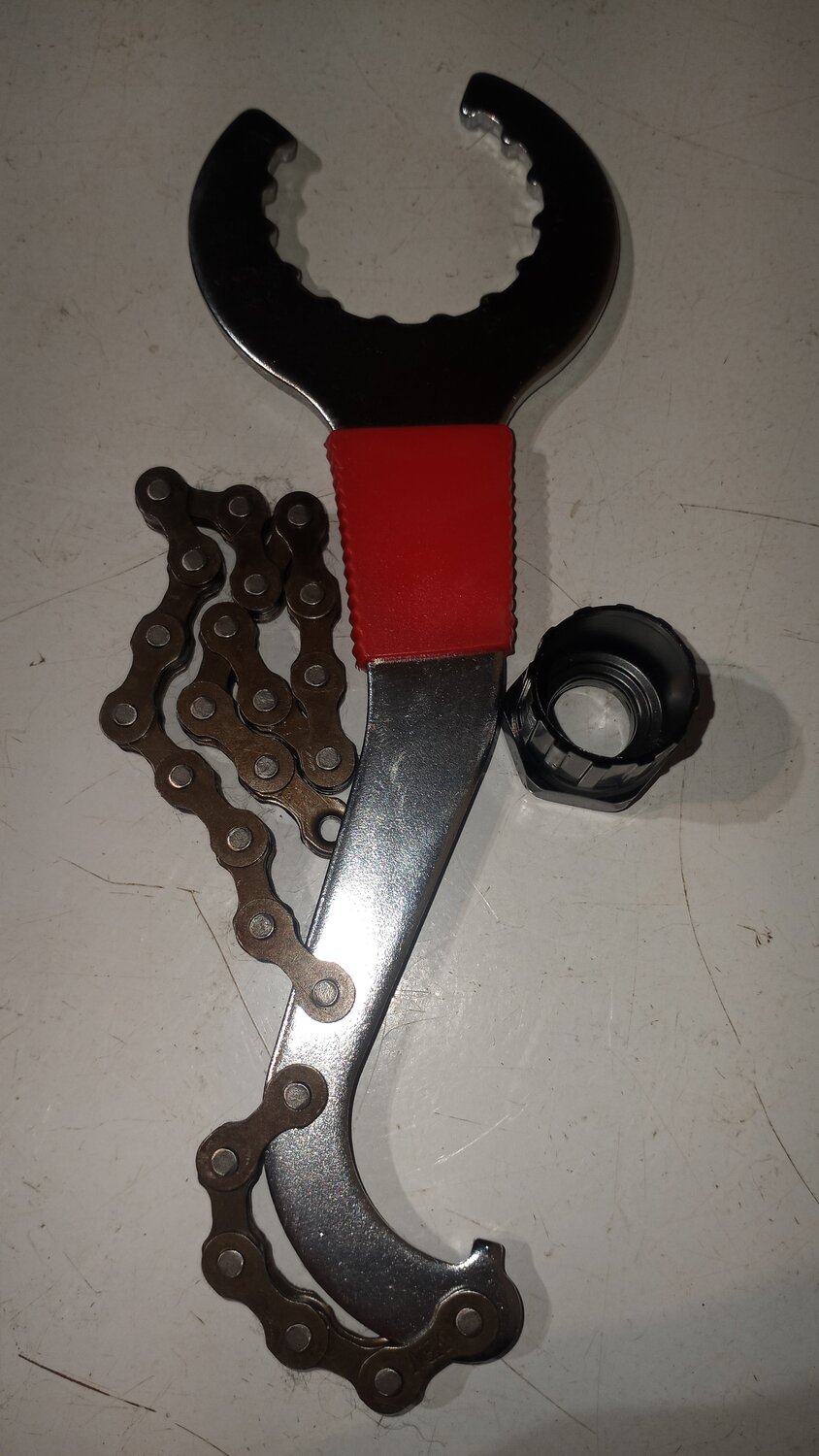

These are the freewheel removal tools that I have,.. (I haven't used them yet.)
They are cheap crappy tools, but the chain whip should work fine.
I would never use this freewheel socket though,..
It's a piece of crap that they painted black to make it look like hardened steel. 😂
That thing would snap and could leave the part of the tool broken off inside the freewheel.

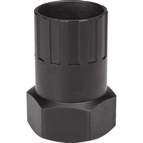

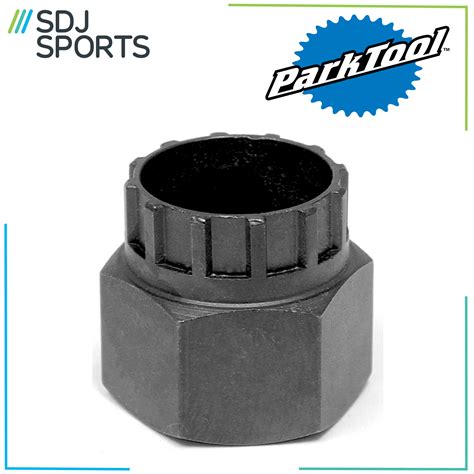

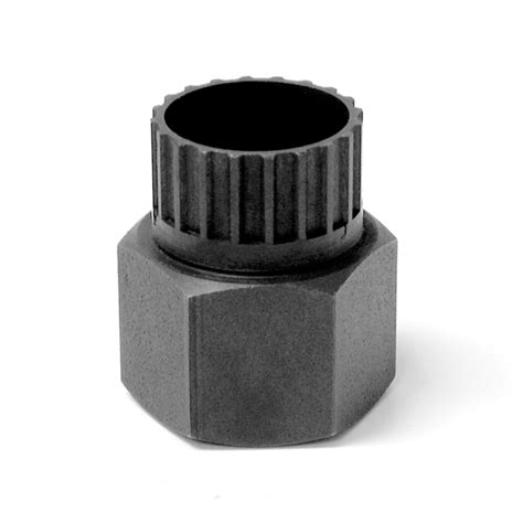

Get a proper Park Tool freewheel remover for that job. They come in a few different sizes and dimensions depending on the freewheel that you have.
