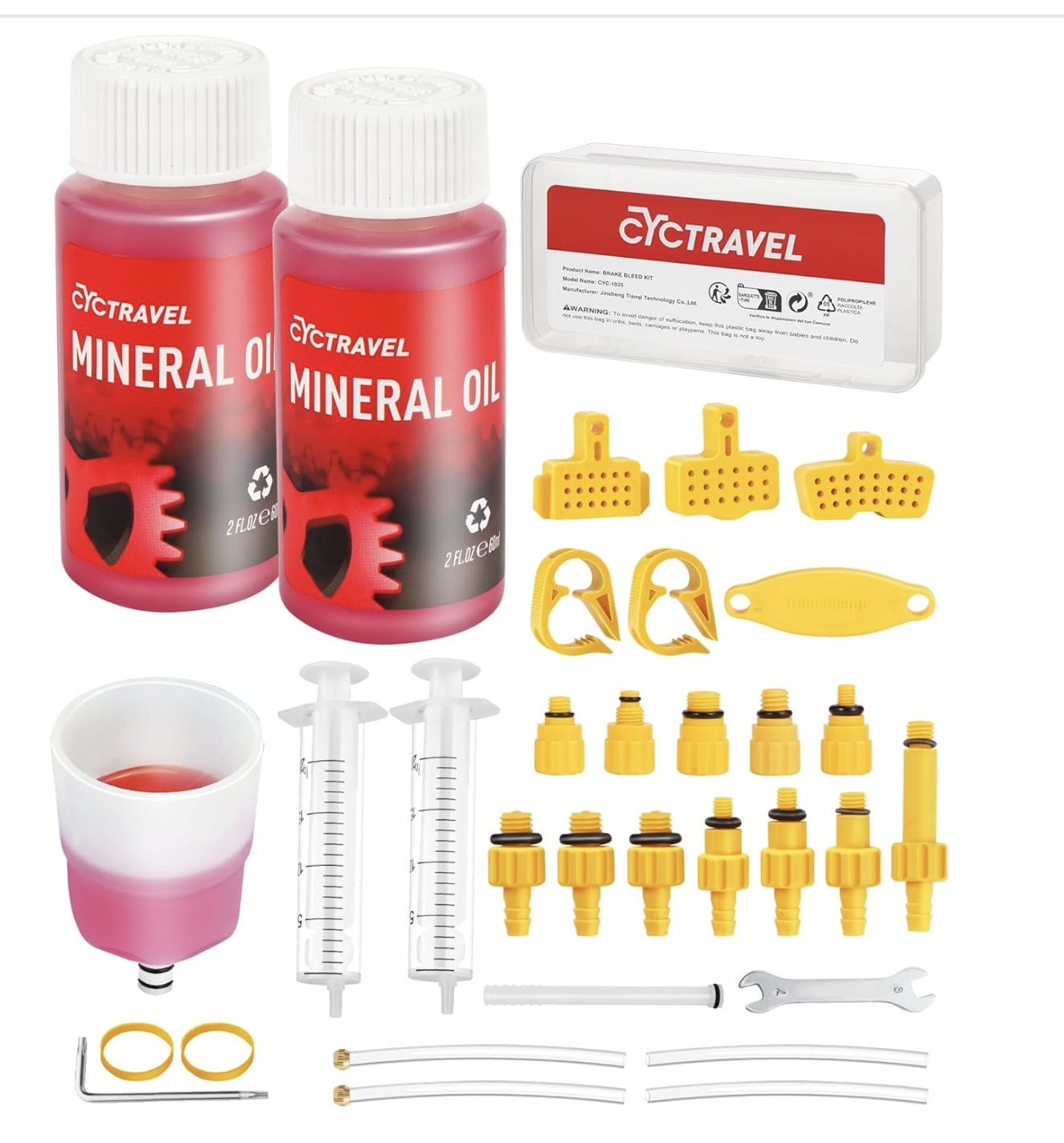

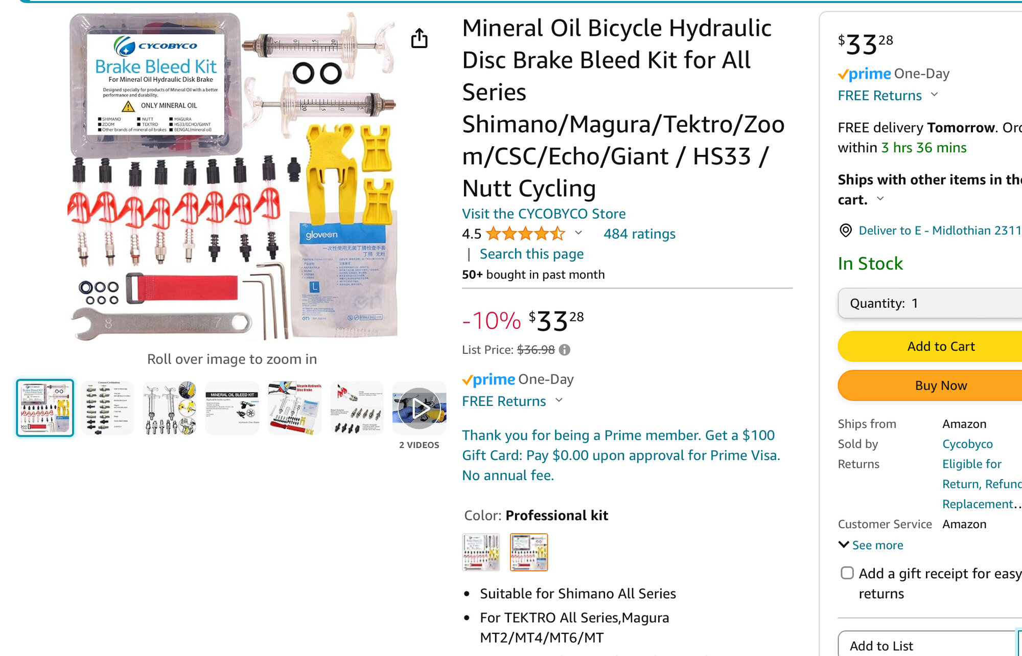

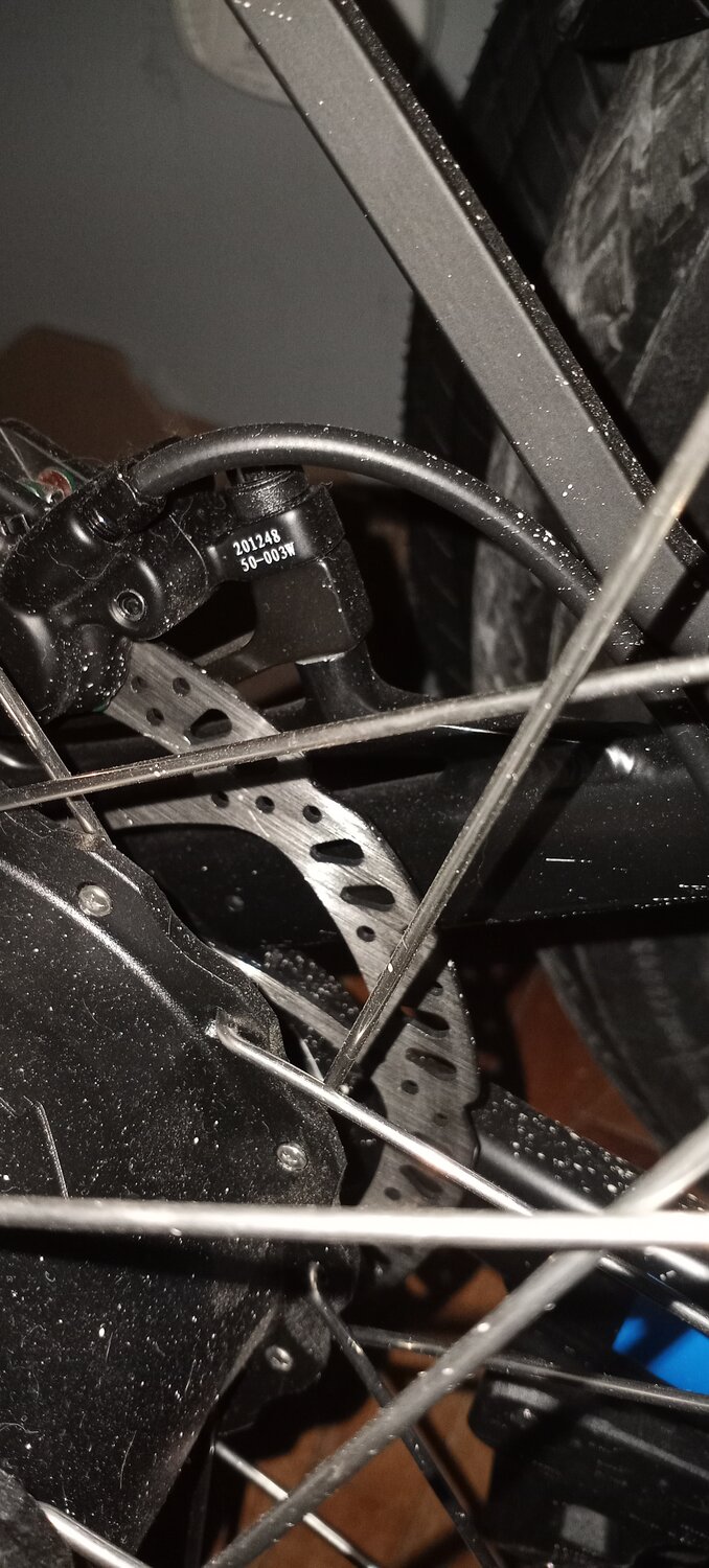

Ride1Up Cafe Cruiser. Rear brake is very soft, it gets hard if i pump the lever 4-5 times, reminds me of my old cars with air in the brake lines. I bought a service kit from amazon and have tried several times to bleed the brakes, but it’s not working. Need help.
I watched a couple of videos, here’s what i’m doing: i attach a full syringe to the bleed screw on the brake mechanism, remove the screw from the hand lever, push the oil up into a catch cup.
Is the problem the zoom parts? Should i consider replacing them with a better brand?

it looks like really short hose that may make it harder. plus you want the little clamp that slides over the hose that clamps it on the barb on the caliper. the hose may be in that bag but you really want the hose clamp to keep the hose on the slipper. they pop off so easily. see that oval part that slips over the hose and onto the barb. a clear cup is better so you can see when clean fluid comes out.
