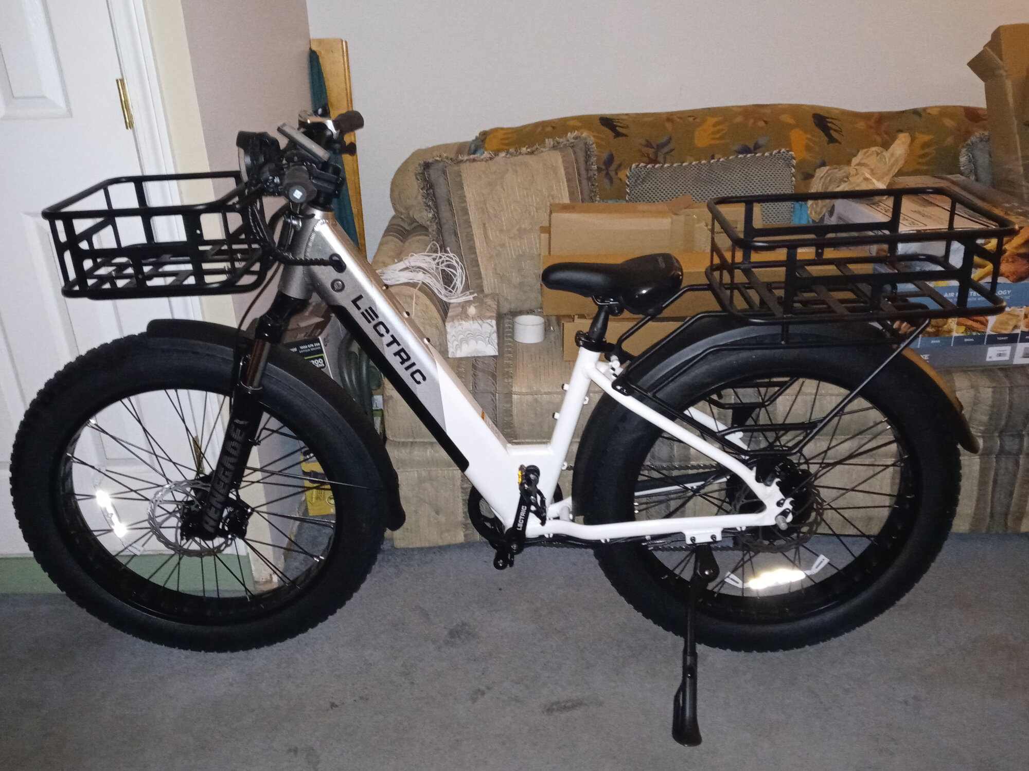

Looking to hear about everyone's first ride on the new X Peak e bike, I'm having a big problem with Mine and want to see if anyone else is having the same problem,without saying what the problem is for now. Thanks in advance

My problem is the bike has a very bad wobble or a shimmy so bad it feels like the bike is going to fall apart or it's going to throw you off the bike I know it's new to the market and I was just hoping someone else that got one if they were having the same problem it's only when the throttle is engaged if you are just peddling it doesn't do it. It's going into the shop on Friday but Lectric only covers $60
For front end wobble. I know of one fix to air up tires and dial the front suspension stiffer.

Can't tell if the wobble or shimmy is in the front of the back the whole bike shakes they told me to check the air and the tires and that the front through axle was in correctly and to dial in the front suspensions all the way I did all that and it's still shakes like crazy I thought it might be my weight cuz I weigh 300 lb so I had my daughter do it who weighs 140 and it was doing it with her too so that's when they said bring it to a shop that they recommend and have them look at it and they would cover more than the 60 but get a quote First if work needs to be done

Are you within the weight limit for the bike? Secondly, you say the bike perform normally under just pedal power? Then the implication is that the motor somehow is causing this--but how is that possible?
At first I thought perhaps it was a wheel out of balance due to the goop inside the inner tube clumping in one spot, but that would show up under pedal power also.
I really don't know it seemed to run better under Pedal Power but I was also told to remove the cargo package and I did that and it ran a lot better. I am a big guy but I had my daughter try out the bike too and she's 130 lb and it was doing the same thing with her. I have been working With lectric on this and they've been most helpful great customer service
