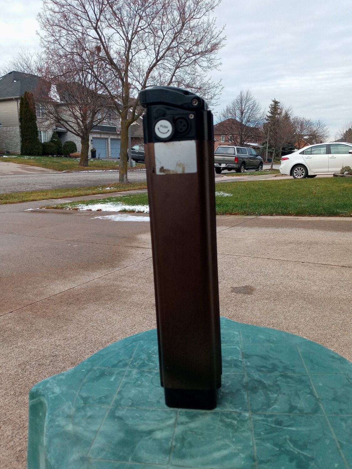

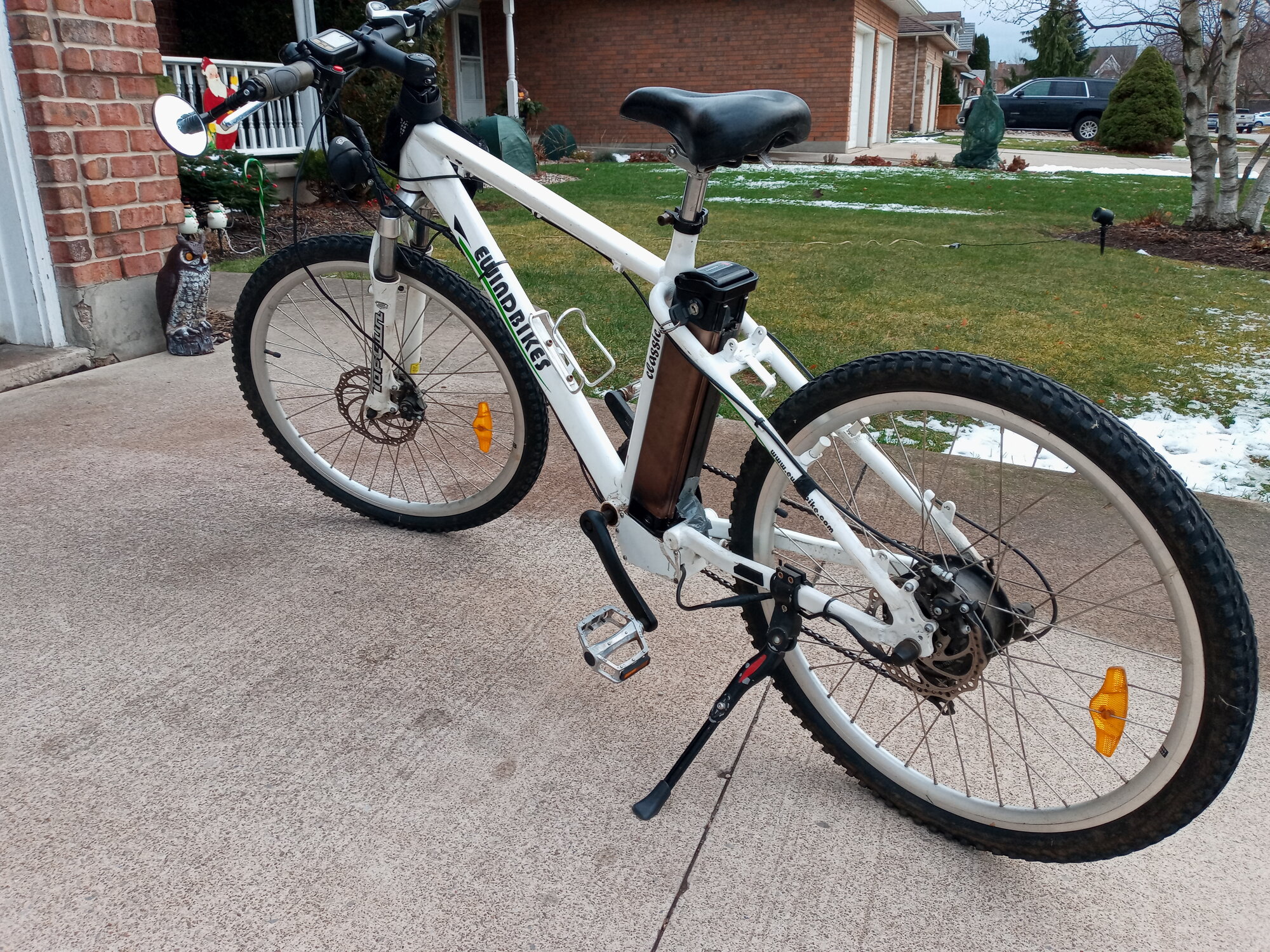

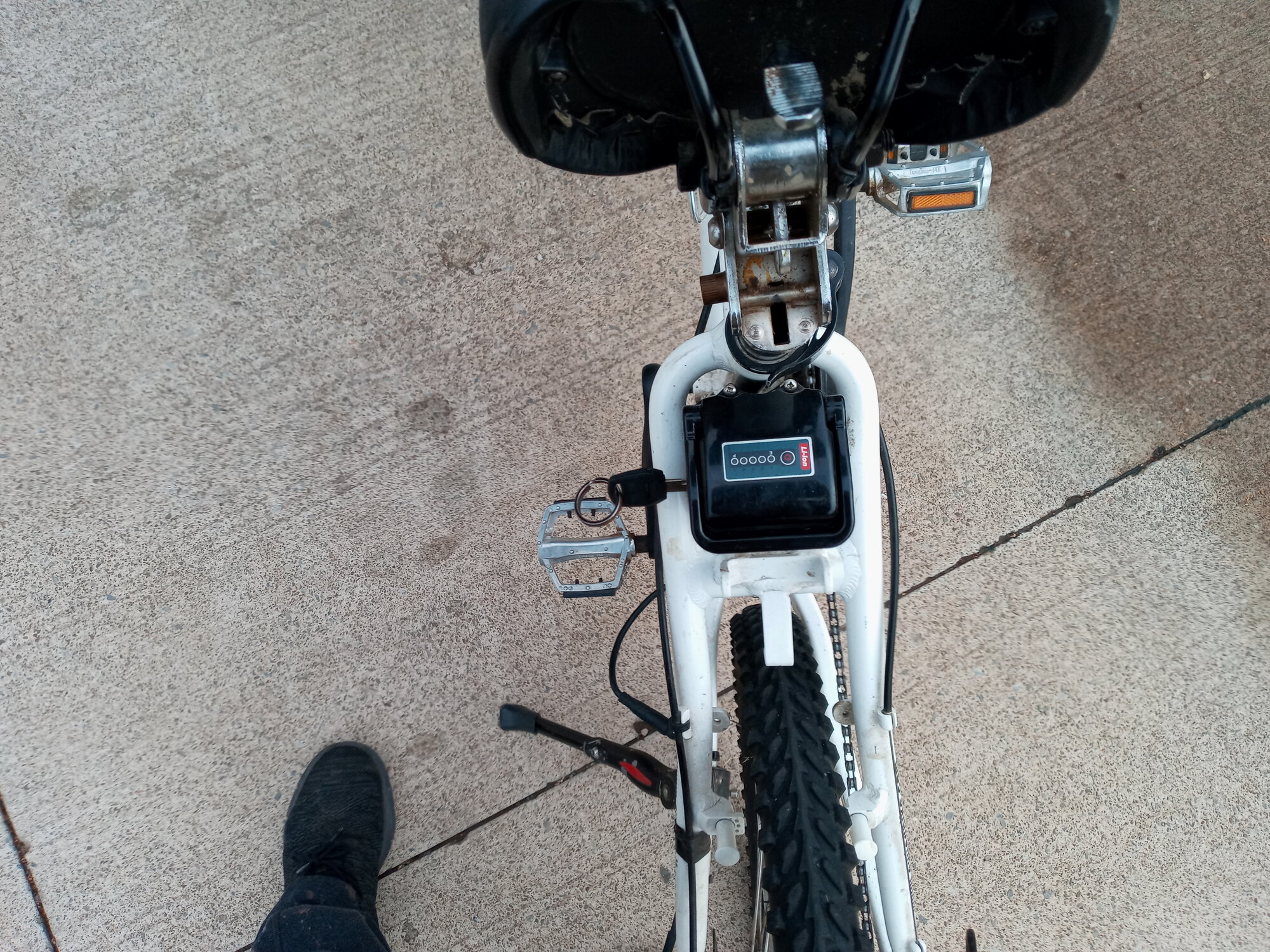

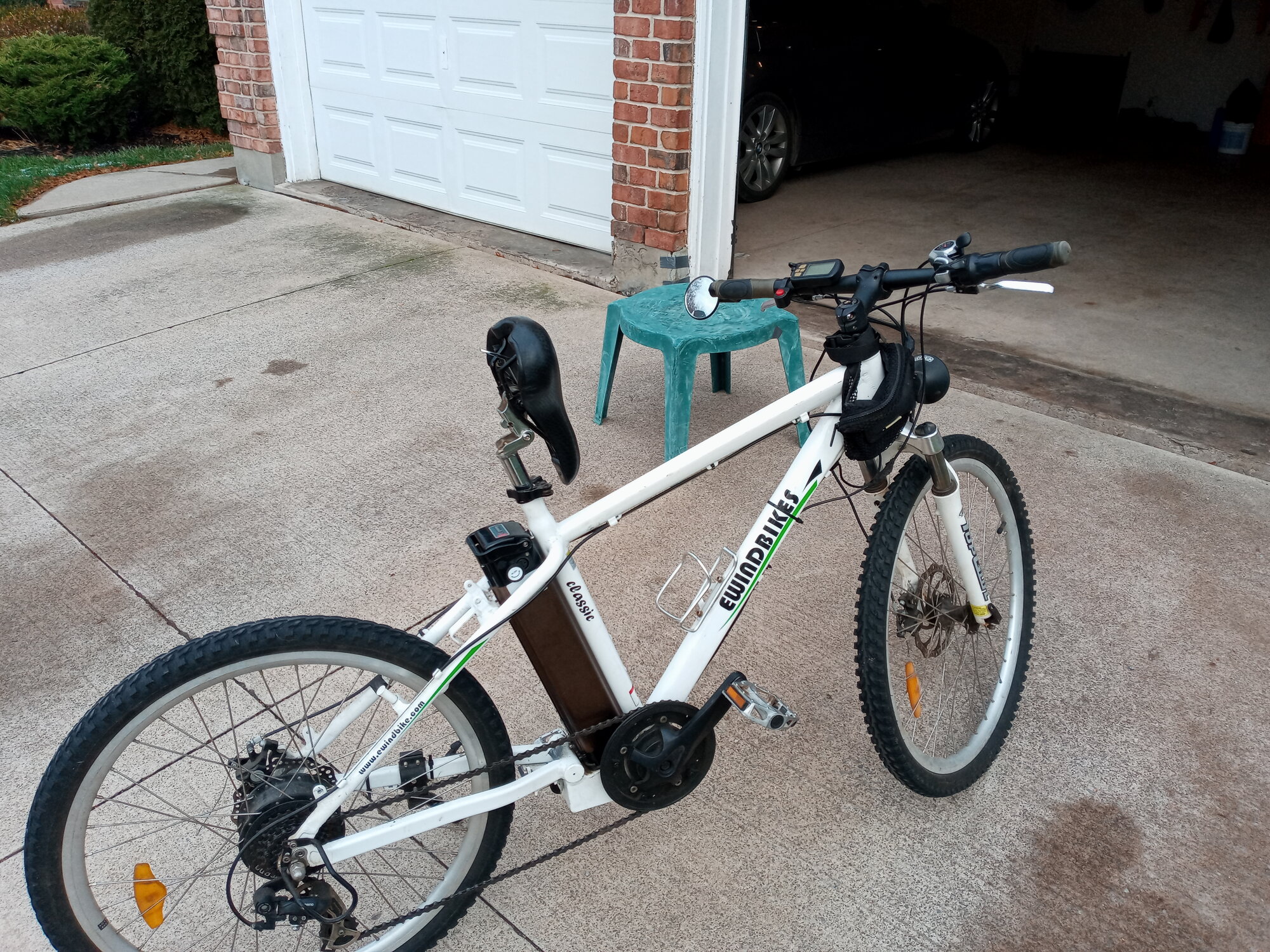

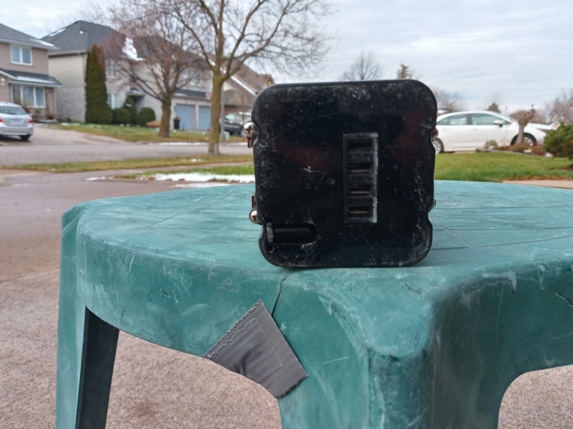

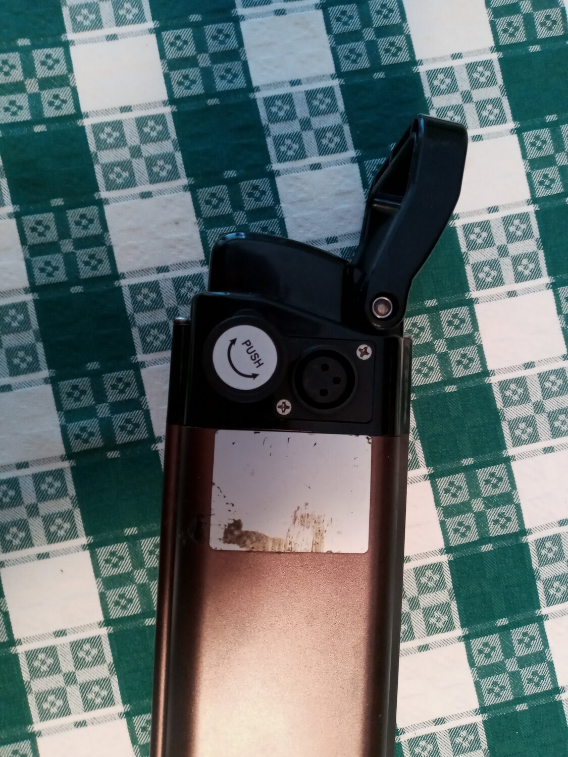

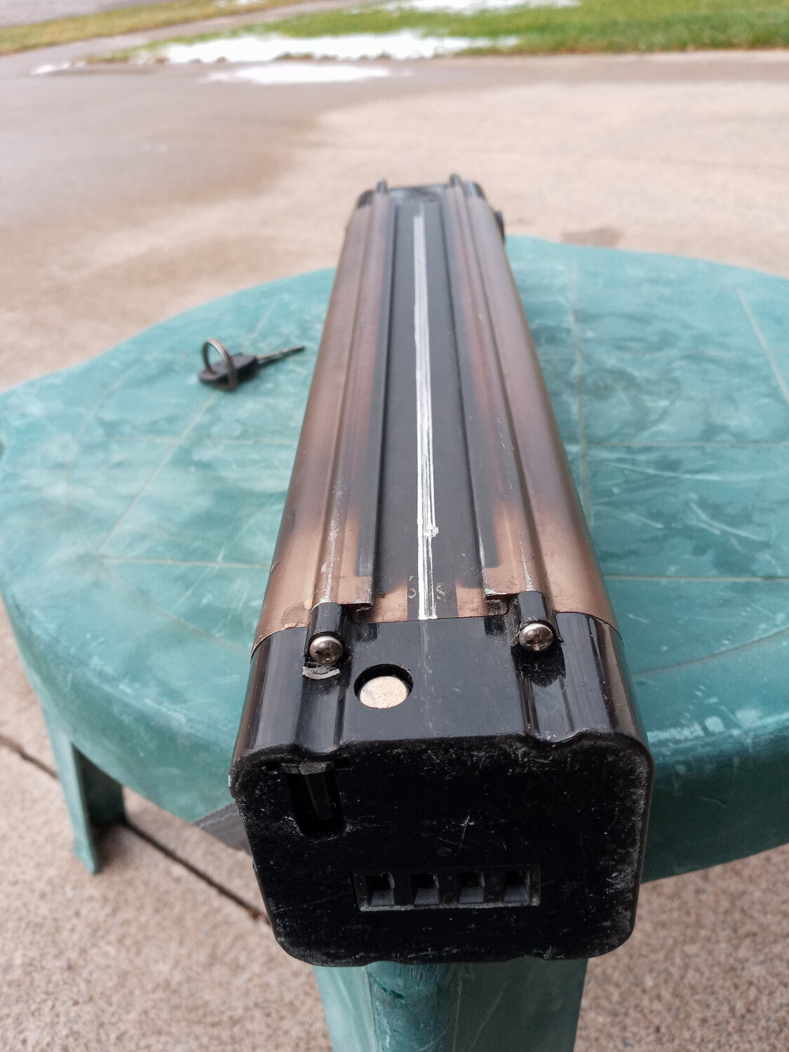

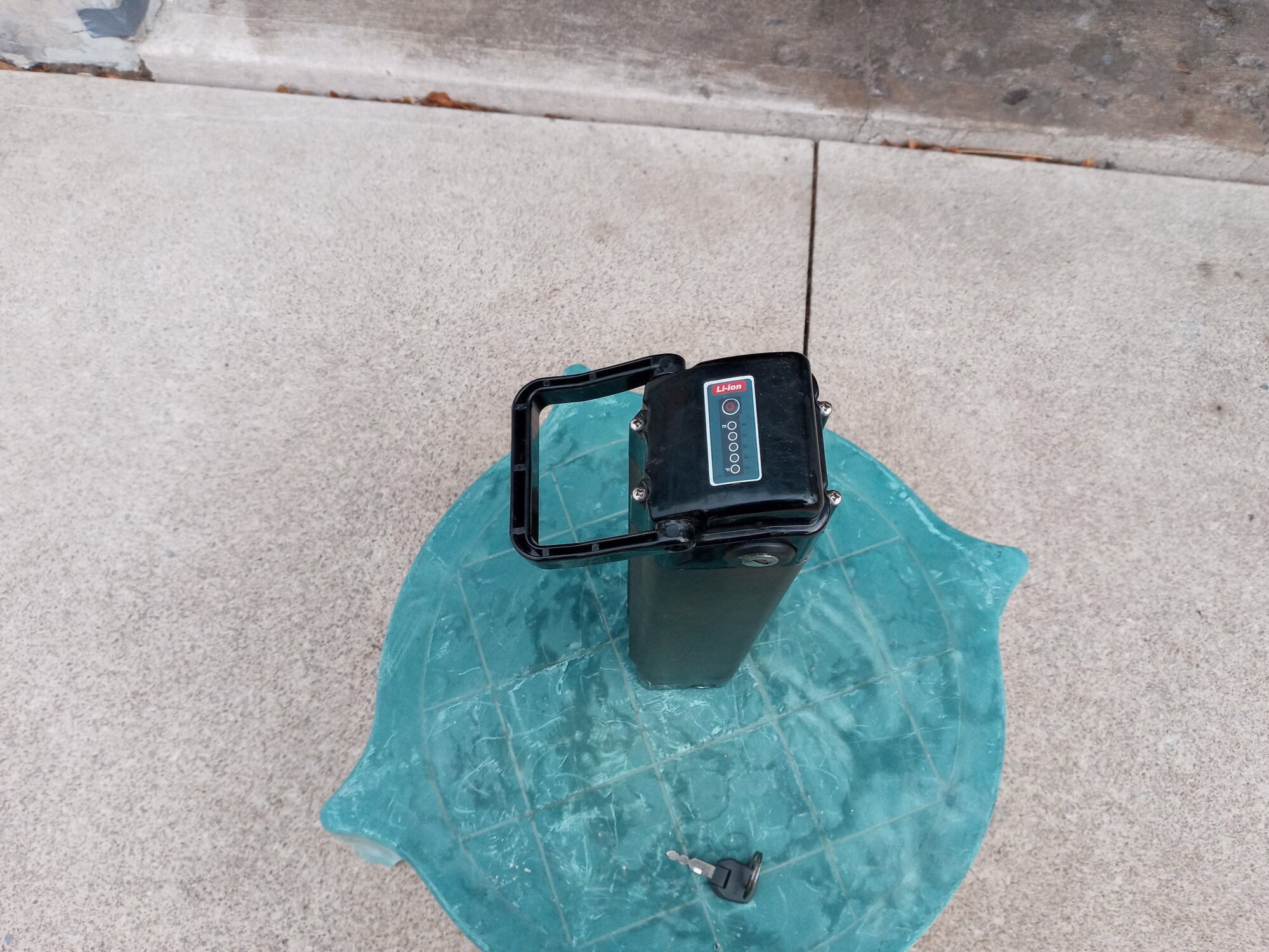

I privately purchased a used E-Wind e-bike however awhile back. Now the battery will not hold a charge and requires a replacement. The E-Wind bike manufacturer in China no longer exists and I do not know how or where to find a replacement. It sits vertically under tr seat so it must fit into the slot to slide down and into the 4-prong connection to the controller. This is also a problem as many I have see on-line are to long (back-to-front). I have 85mm and all I see now is 110mm. See pics.
Can anyone help please ... ?!?!?

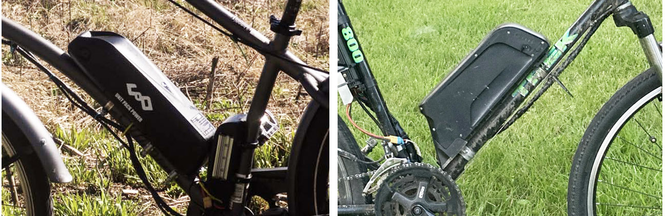

You can always scrap the original battery, Get rid of the water bottle cage, and switch to a downtube battery. The left handone is your typical Hailong and the right hand is called the dolphin. They are usually sold with cradles which can be mounted to the downtube.
The dolphin is a better constructed case, but is a old design and many sellers only carry the cheaper Hailong cases. If you add some additional fasteners to augment the water bottle screws for attaching the cradle, they can be secure. They have keys to lock them in the cradle. Just a matter of removing the prongs in the box under the present battery and running wires to the new cradle.

shoot, go 40 volt going to feel a little better for a bit,however if the ops picture is correct he has plenty of room for a 110 mm battery,I replaced a 10.4 ah silverfish battery with a 20 ah one time not a problem,the only trouble I see is maybe having to remove seat if battery needs to be removed( have used ryobi adapters with 18 volt batteries to power lights and accessories on bikes before, no problem)

I guess I should be more detailed regarding the dimension. You can see battery in my pic, so:
Dimensions Batt. my Bike:
Height: 390 mm
Width (side to side): 80mm
Depth (back to front): 85mm
Dimensions I've Seen on-line for these types of batteries:
Height: 390 mm
Depth (back to front): 110mm
It is the depth that is the problem. 110mm won't fit in the opening to slide the battery down into. So I will have to mount it somewhere (likely the diagonal down tube), and somehow extend the 4-prong connection from top of the controller to the new location ... assuming the battery works for this bike.
