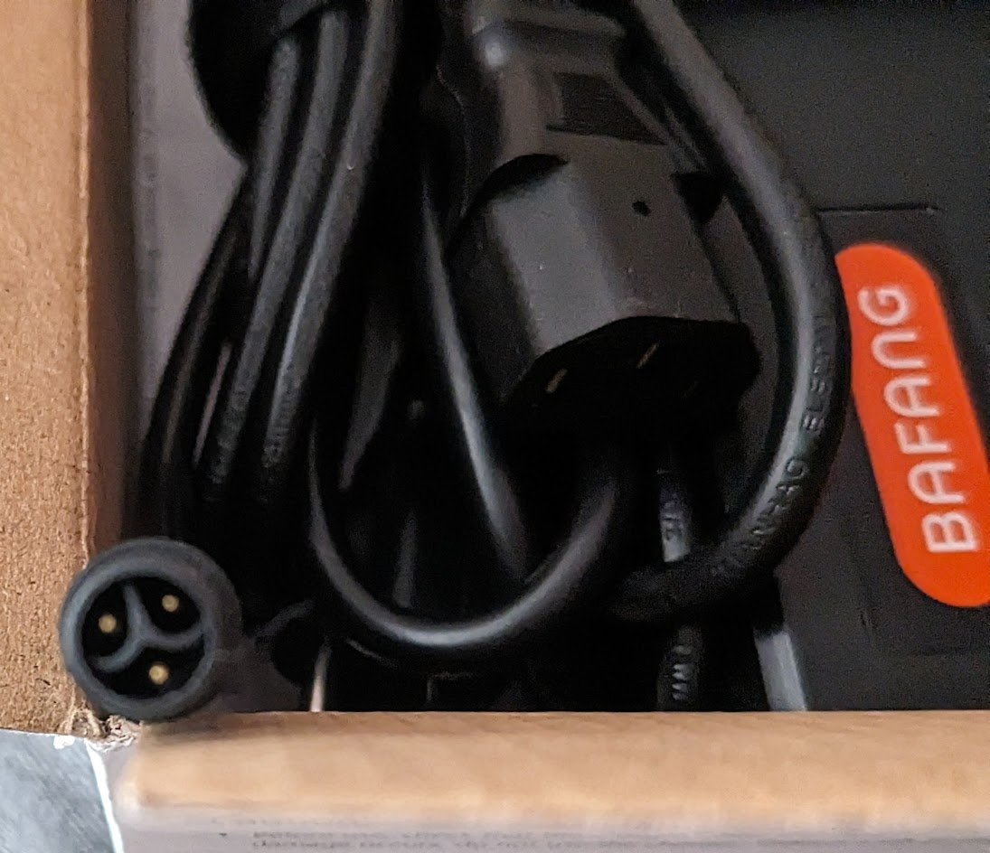

I can't seem to track down an XT60 adapter to fit Bafang's new (?) propietary (??) charger port for its batteries (lower left of pic below).
Does anyone know what it's called and who might carry it? I hope to use my 80-90-100 smart charger and don't want to splice this one to it.
The only place I know of that does conversion plugs is Electro Bike World, but those are meant for the new motor plugs (to convert to the old motor plug and in turn plug into a controller), which are round and 3-pinned but not the same as the charger plug you are showing.
And yes, its proprietary. When you bought into the latest Bafang ecosystem you lost the seamless ability to use anything but their equipment. From what I have heard (via the High Voltage channel IIRC... its been awhile) that third pin is a data path that handshakes with the battery to ensure its genuine Bafang before the battery will start accepting a charge.
And also, some of the Bafang batteries are 12S packs. Its a rare in-between stepping up over 36v (10S) and a bit less than 48v (13S). Max charge on those is 49.2v, and some people think they are 48v packs because of that peak voltage number. They ain't. Some of the new packs are 14S (52v) so there's a little bit more to pay attention to than usual with their new OEM stuff.

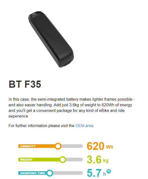

It's using Bafang's BT F35 battery (below), and I'm also thinking ahead to the day a new battery and/or charger will be needed. This far I can't find any retailer that carries it or its charger.
Thanks G for the Julet name of the port type. I did find this site that you must inquire for pricing/ordering, so it's presumably a Chinese seller: https://www.edrive-tech.com/BT-F35-pd720302188.html

I have the same issue and all I can find out is that it's a Julet

It's a Cusmade 1103B but there is still no retail source for these. Maybe they will sell directly to you?

Data communication needs 4 pins; 2 pins for voltage and 2 pins - CAN-hi and CAN-lo for the CANbus protocol to communicate with the BMS.
A single pin will not be able to make use of the CANbus, and in most cases, the third pin is typically used for temperature sensing.

I also don't think the third pin is "communication" but it can be used as a simple confirmation that the charger is connected to the battery... usually by providing a ground.
I've also seen it used to disable the motor such as with a golf cart to keep from driving off while plugged in.
This said you can still use a smart charger by providing an external jumper. In the case of my DIY Smart Charger ... I just connect it straight through without breaking through the relay. You'd have to test but you might have to provide an additional ground. A manufacturere schematic would be golden.

In your battery, the third pin is used as ground and the two main pins are rated for 5A charge current.
