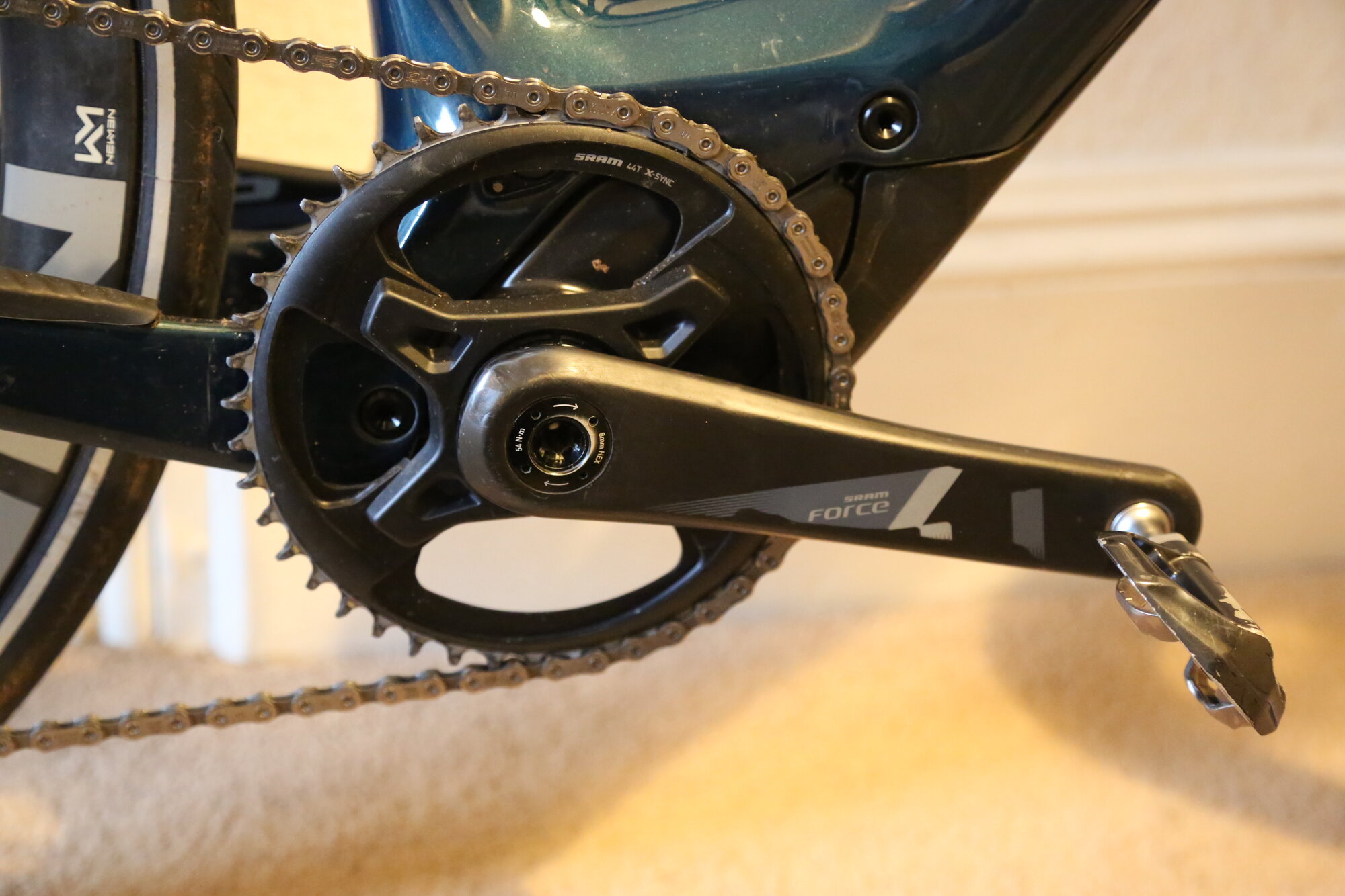

I purchased the Creo 2 Carbon Comp and this came with alloy cranks. On the Creo 1, the weight difference in the cranks was fairly minimal between alloy and carbon and I was expecting the same of the SRAM Dub cranks on the Creo 2. However, I found that the alloy SRAM cranks and weighty numbers at 260g a side. I priced up the SRAM carbon cranks and these are expensive. I found a set for £525 (but have seen then cheaper in USA at around $300.
However, I have found a extremely cheap way to get carbon cranks on the Creo 2 and save 200g. The SRAM BB30 cranks and the same interface as SRAM Dub. I picked up a set of SRAM Force Carbon cranks for £50, removed the spindle and they fit just fine. The only down side is the left side does not have a self extracting bolt, but how often do you take the left crank off?
So look at BB30 cranks with a bolt on spindle and make a big saving over the SRAM Dub ones and nice weight drop to.

Yea, SRAM BB30 and Dub has the same interface, even the bolts fit. This only applies to the Creo 2 SL 1.2, as the SL 1.1 is M30 and has different splines. Other than Praxis, was difficult to find other arms for the SL 1.1

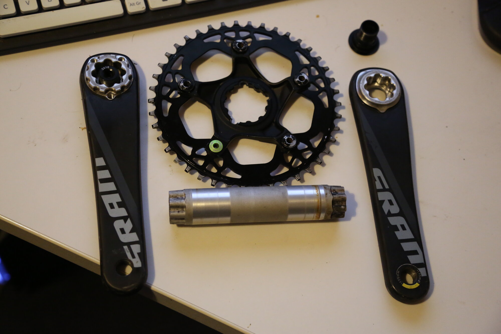

Let the Force be with me and I did not have to Force this on. On BB30 crank on the Creo 2 Dub

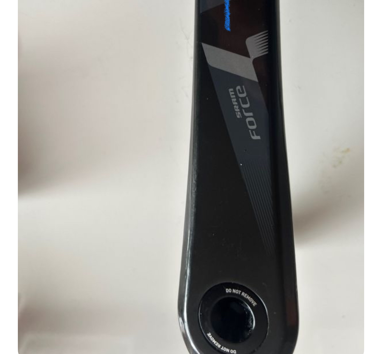

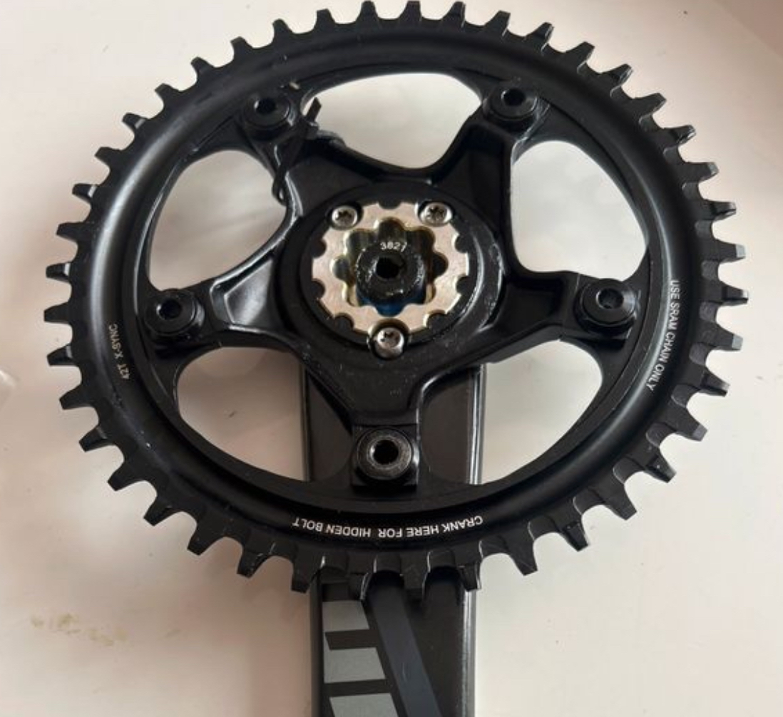

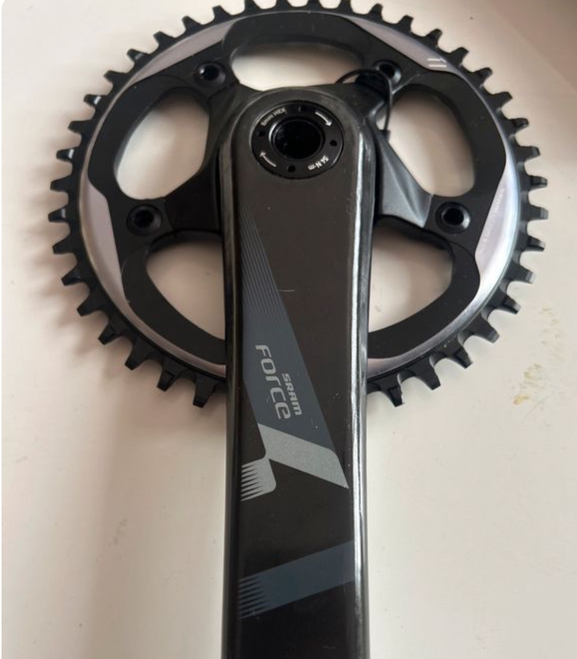

Is it the good version on the picture ?

Yea, these are the same as mine. Remove the spider as this is not needed and knock out the spindle from the non drive side as you need 2 separate arms
Ok Thank you for this Quick answer.
But on picture one the white are a around the screew. I think y dont need this thicker party to be ok White the Creo Axle.
Sorry for my english
No worries. When the the cranks are dis-assembled, this is what you end up with. You need just the crank arms and these fit on the the motor as same as Dub interface. The drive side is a self extracting bolt, the non drive side is a fixed bolt. Grease the splines well on the non drive side and it is easy to take off should you need to

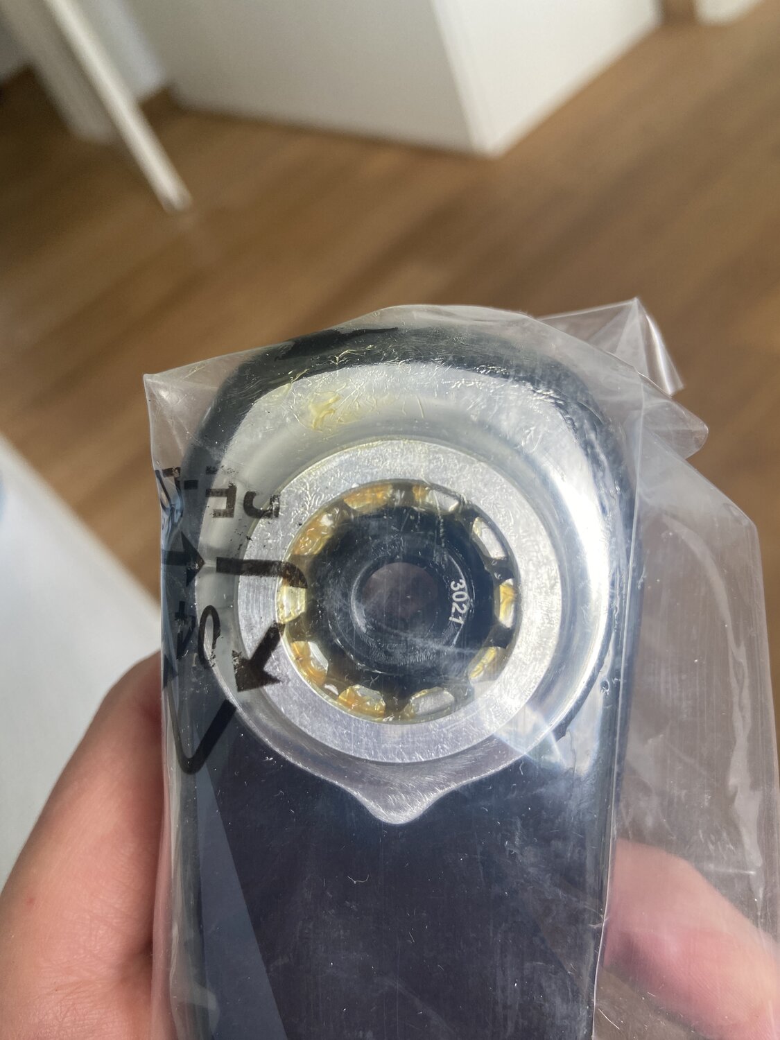

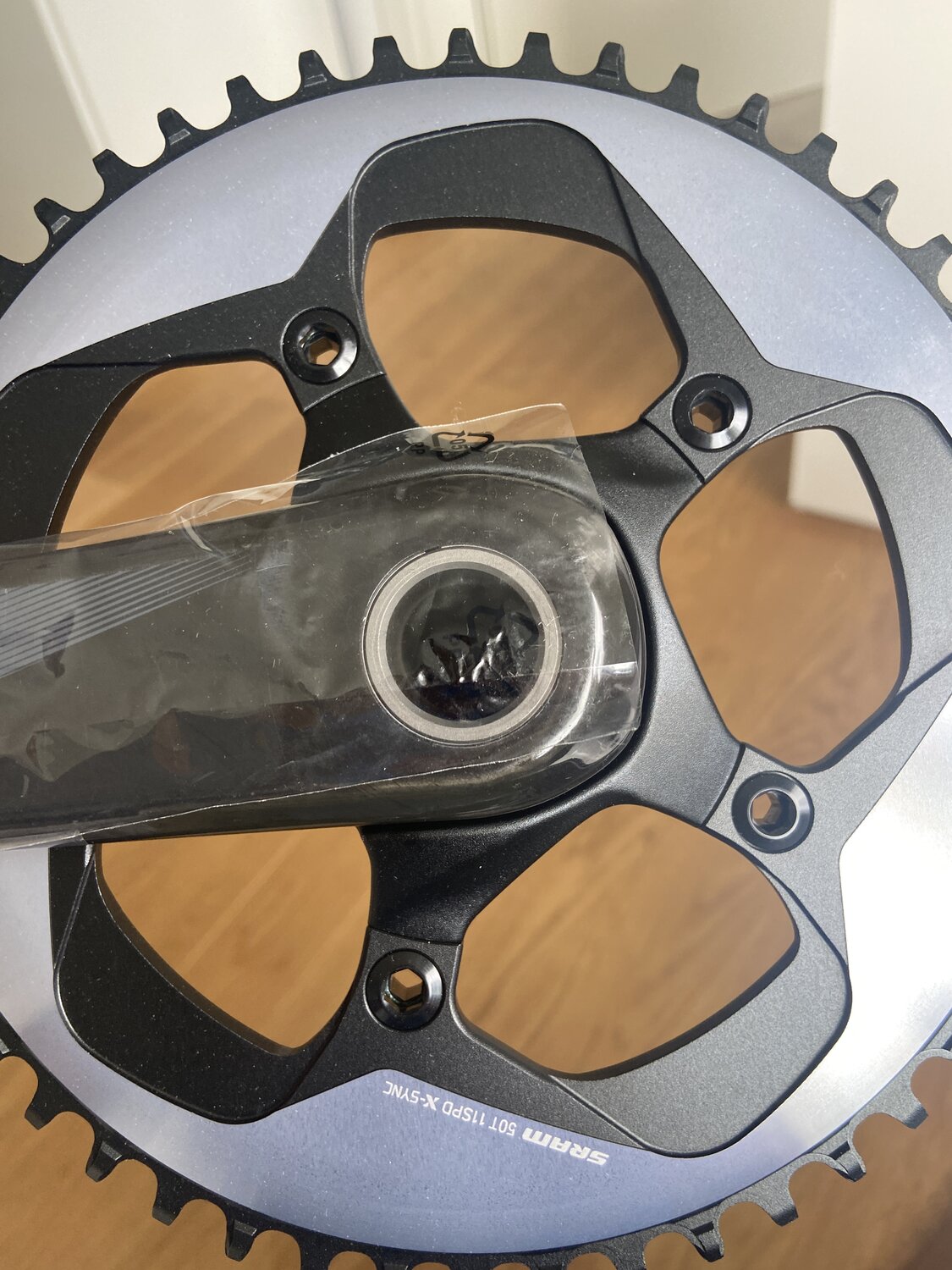

Hello,
thanks for your input.

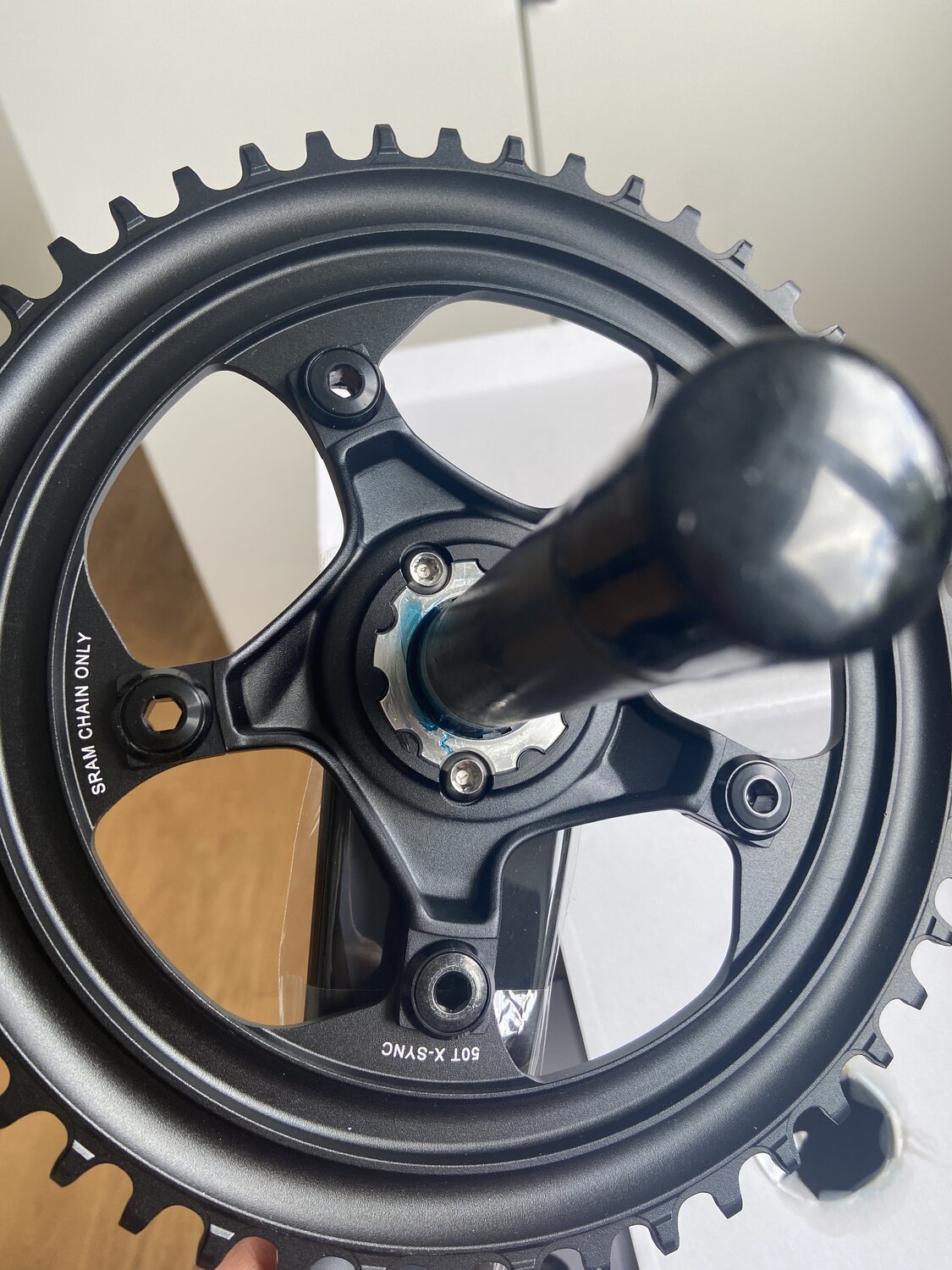

I bought this cranks (SRAM Force 1), but I am not sure if it will fit. What do you think?
Thank’s a lot!

Hello,
Thank’s a lot!
These will not fit a Creo 2. If you look at my photo above, the BB30 / dub interface is a wavy star shape. Not sure about the Creo 1 but I would be surprised if they did.
