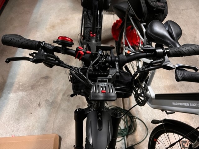

I have a Cobra Pro and the standard 48v headlight was more like a daytime running safety light compared to something for evening/night riding. I removed the standard light and replaced with one of my the NiteRider Enduro Pro 3600 lumens off another fat tire ebike. I added a handlebar extension and small bag for the NiteRider 8 cell battery. I like the feature of the NiteRider of a blinking light during daytime "share the road" riding for an added layer of safety.

Odier Handlebar extender, Amazon, $30: https://www.amazon.com/gp/product/B07CH78SKS/ref=ppx_yo_dt_b_search_asin_title?ie=UTF8&th=1
Lepeiqi handlebar bag, Amazon, $12: https://www.amazon.com/gp/product/B09Y134MJJ/ref=ppx_yo_dt_b_search_asin_title?ie=UTF8&th=1

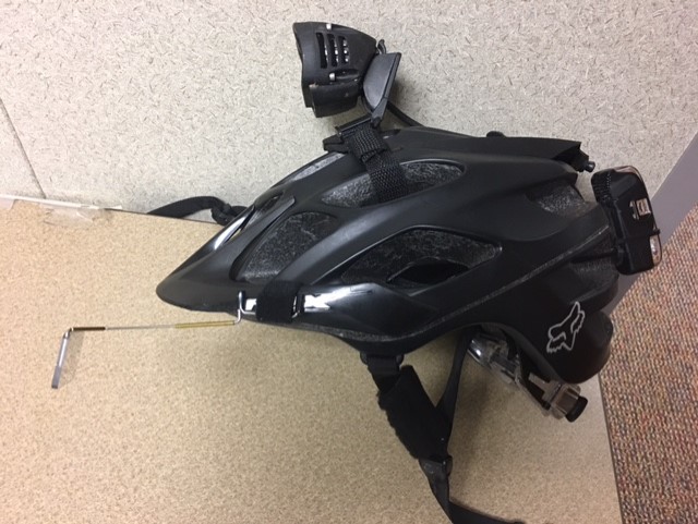

I got my NiteRider lights way back in 2016-2018 pieced together off eBay. Probably paid between 1/3 to 1/2 of MSRP back then used. I also have NiteRider Enduro Pro 2200 for my helmet I used to night ride the single-track in the foothills or near the Rio Grande river in ABQ. Having an helmet light was probably my best safety investment when I started ebike work commuting at 5am. Cars were able to see me way better driving from side streets as they approached me that early in the morning. Sometimes that kind of traffic couldn't see my handlebar mounted light as well because of vegetation or parked cars. I would check into some type of aux light for your helmet if you plan to ride at night on city streets.
NiteRider Enduro Pro 2200 with Light & Motion Vis 180 Pro:
