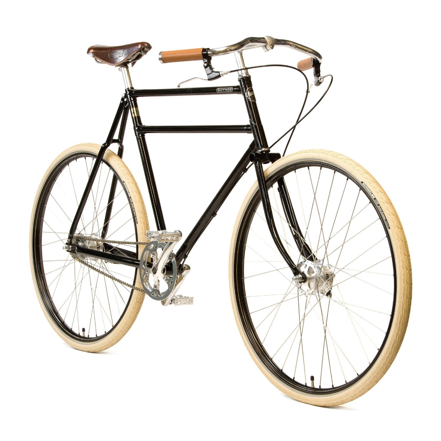

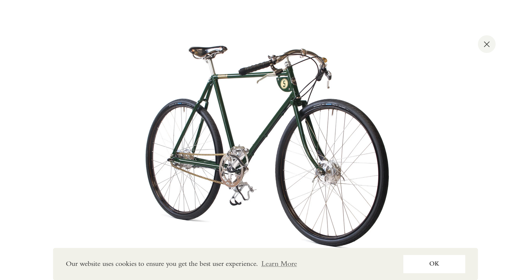

Pashley has some cool bikes in my opinion. But then again my tastes are different than most. I would ditch the white tires on this one and go for something like Super Moto X. The frame is setup to take a Gates Belt with a break in the seat stay. I would probably flip the bar for practical reasons. Who has a double top tube? Really! I would also use polished crank arms on the mid-drive, keeping the polished chainring guard. Those are roller brakes. Super clean with a hand brazed lugged frame. There is one US distributor in AZ. They are pricy but very rare. It is a head turner and thing of beauty. You are ridding a work of art.

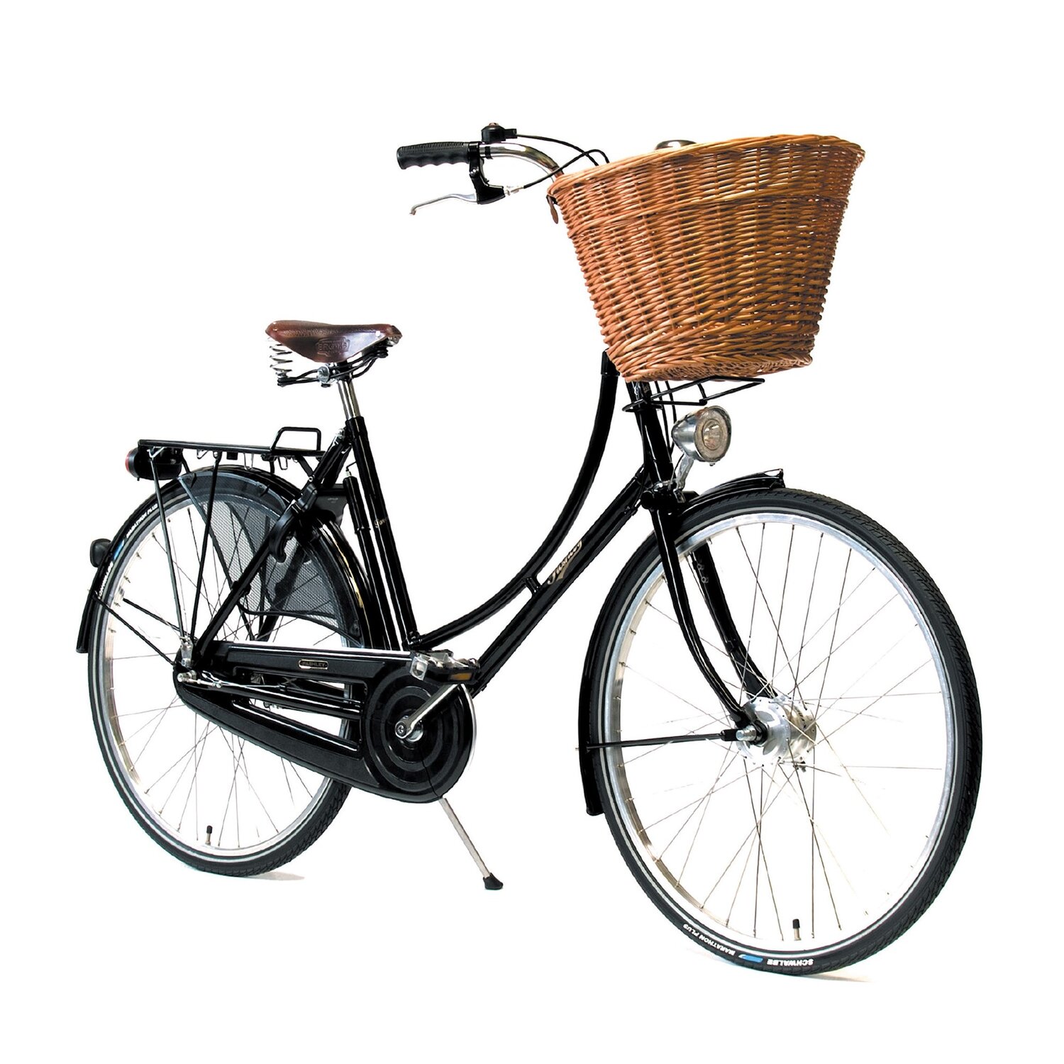

Yes, I hope they don't make them like a hunk clunky Rad and do retain some of that style that sets them apart. The Princess looks very Dutch from the 1950's. I once made a similar bike electric. It was a beauty with an IGH, dynamo, lugged frame, and integrated wheel lock. I would like to think that they really are made in Stafford but suspect that they are made in the same factories as other Omafiets. Here is a high quality steel frame being produced by Leeche in Taiwan.

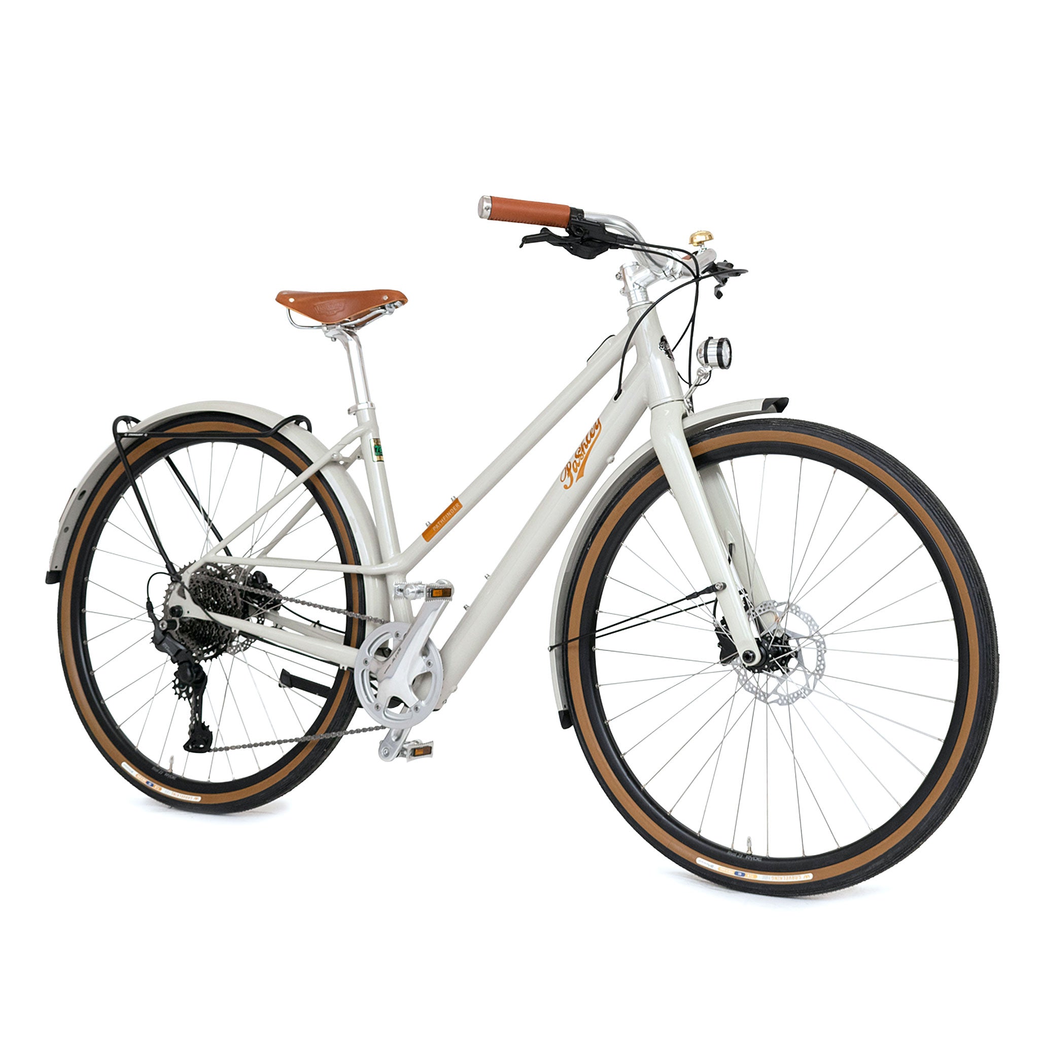

Pashley Pathfinder E

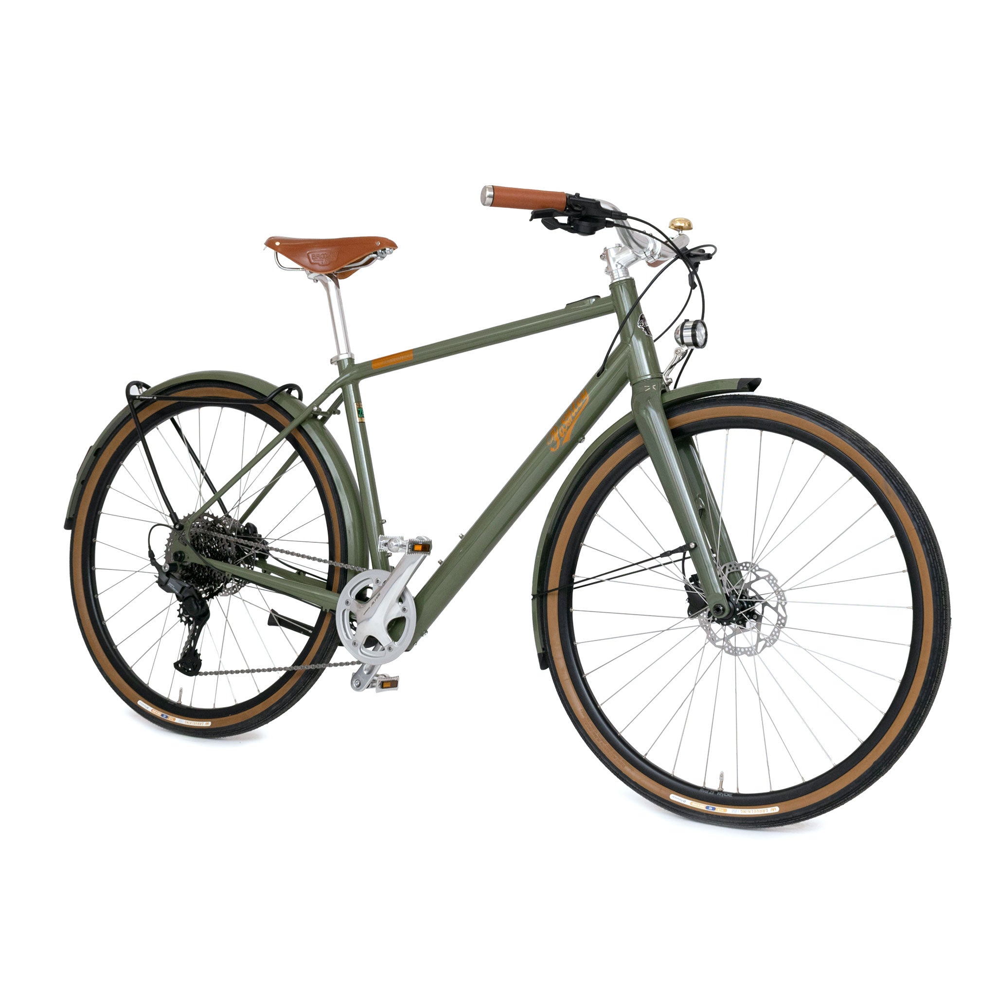

Pashley Pathfinder XE
38-40lb and uses the Mahle X30 motor

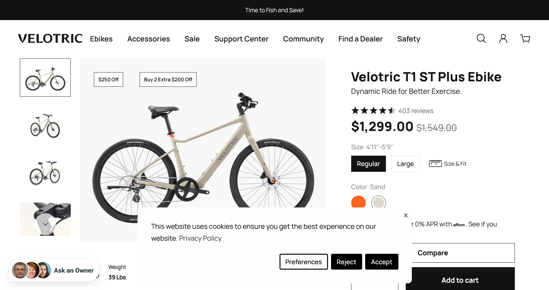

It is an Asian made hub drive. With an X35. And a proprietary fit battery, so you are so totally screwed. It is essentially a rebranded T1ST. That sucks. The tweed is cool. The bike is Walmart. Walmart in Lion's clothing.
Respectfully you are not comparing like with like. A better comparison for the Velotric T1 would surely be ebikes like the Cannondale Treadwell Neo or Momentum Voya E+. This Electric Bike Report post about hub motors speculated the Velopower E35 motor system used on the Velotric T1 may be a license-built copy of another company's system, but the Velotric controller looks different to the Mahle iWoc controller and Velotric are not listed as a bicycle brand partner on the Mahle website.
Mahle is a natural partner for Pashley as their new CEO previously worked for Ribble who also use Mahle ebike systems. The Mahle X30 system is UL 2849 electrical safety certified, with a battery pack using Panasonic cells that is backwards compatible with the 5 years older Mahle X35, the pack is internal but can be replaced with disassembly. Mahle parts are carried by QBP for distribution in the US/Canada, so they can be ordered in by any bike shop.
The Pashley Pathfinder-E can be compared with other bikes that use the Mahle X30 system and higher quality Shimano components, including the Stevens E-Strada (Germany) or Origine Montmartre (France). By comparison with those bikes that use an aluminum frame/fork, Pashley make a hand-brazed Reynolds steel frame in their Stratford, UK, factory with some 3D-printed steel parts and add a carbon fork. It's great to see the traditional bicycle brand Pashley assembling e-bikes in the UK using modern components and production methods.

For their first leisure market e-bike Pashley have chosen to modernize their in-house production strengths building steel frames. As for aesthetics the Pathfinder-e looks like Pashley instead of converting their traditional Princess loop-frame step-through and Roadster diamond frame bicycles, decided instead to take inspiration from their lighter Aurora and Countryman frames but swap out the IGH for a Shimano Cues derailleur, and add a carbon fork & hub motor. I wonder if Pashley are hoping to follow the success of Ribble and Brompton with hub drives? I’m sure Pashley will continue with mid-drives for their cargo bikes & trikes. I’d like to see for their next e-bike launch a Pashley/Morgan branded lightweight steel frame model!
