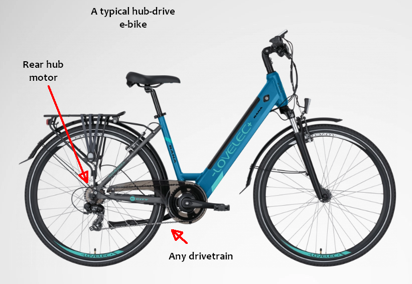

The geared hub motors drive the rear wheel directly and are independent of the drivetrain. Geared hub motors are found on inexpensive e-bikes.

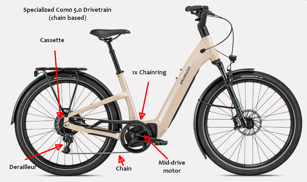

The mid-drive motor, the carbon belt drive, and the IGH are typically found in so-called SUV e-bikes, such as the Gazelle C380. Normally, a chain e-bike with a mid-drive motor has a similar motor as found on the Gazelle C380, only the pedals/crank operating through the motor drive a real chainring, which is a single sprocket. The chainring drives the chain, and the chain acts on the cassette sprockets that in turn drive the rear wheel. The gears are selected by the rear derailleur.
This modern drivetrain is called 1x because there is only a single chainring in the front but many sprockets in the cassette: from 9 to 12. The 1x system has got rid of the complexity related to the front derailleur, and is good for mid-drive e-bikes.
