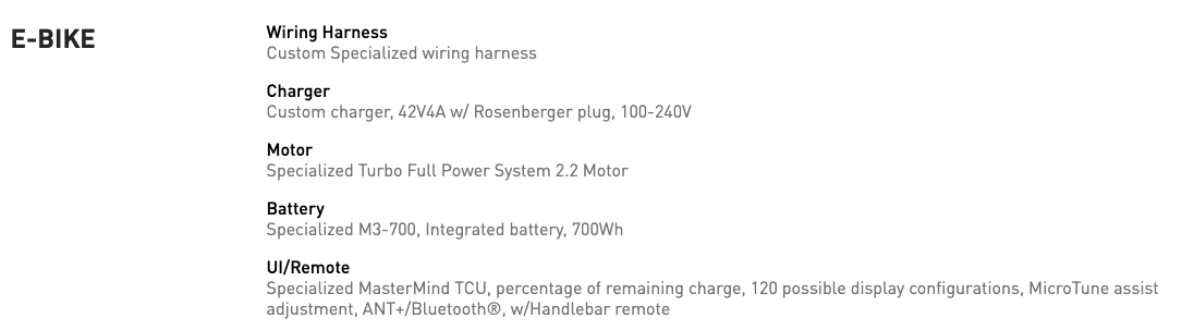

I do love the Brose on my eMTB Turbo Levo Comp Alloy - it's a beast of a motor and SO quiet:
