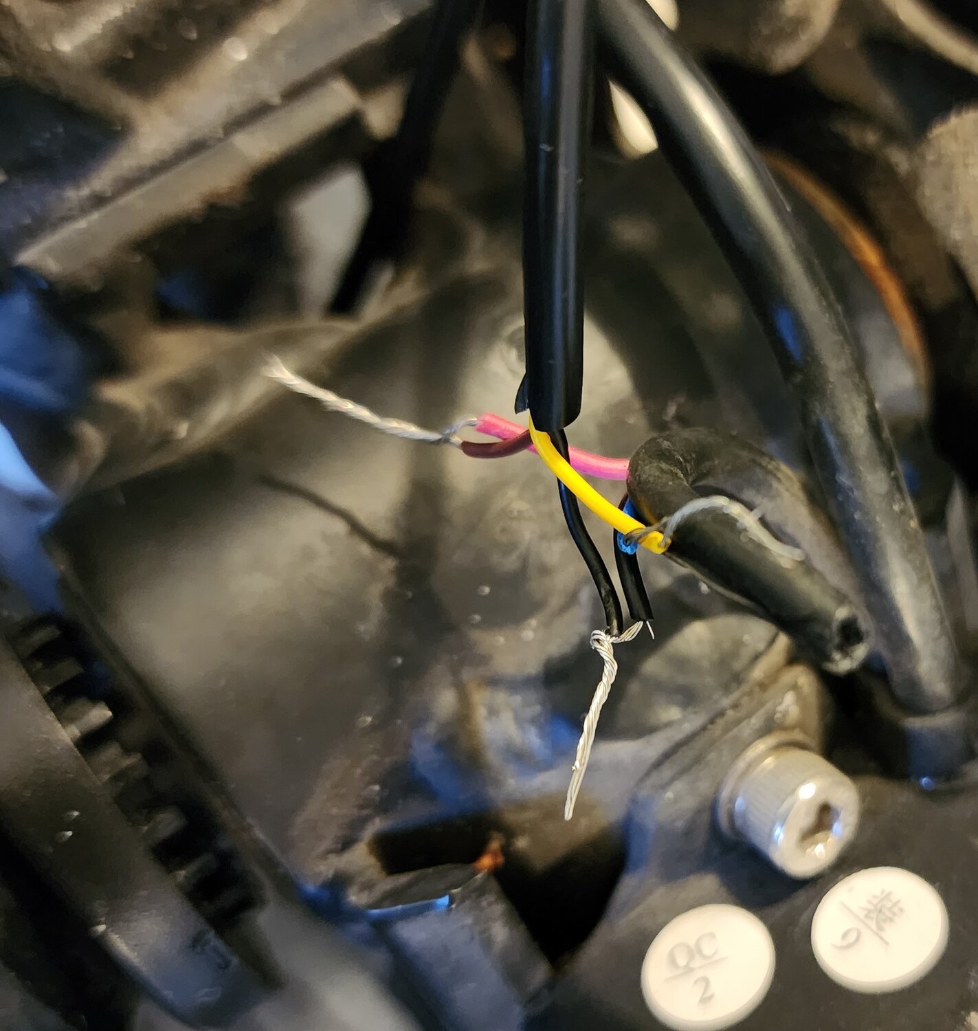

This is a picture of my PAS sensor.
I think yours is different but it's the same idea. (Mine doesn't look to be adjustable?)
You should have enough wire length to splice the wires together.
The wire colors should match because you are getting an original sensor.
It's best to solder the wires because there is a VERY tiny signal coming out of the sensor and it could be lost through a bad connection.
At least twist the wires together really good then coat them with silicone to seal them. (electrical tape doesn't seal good enough)

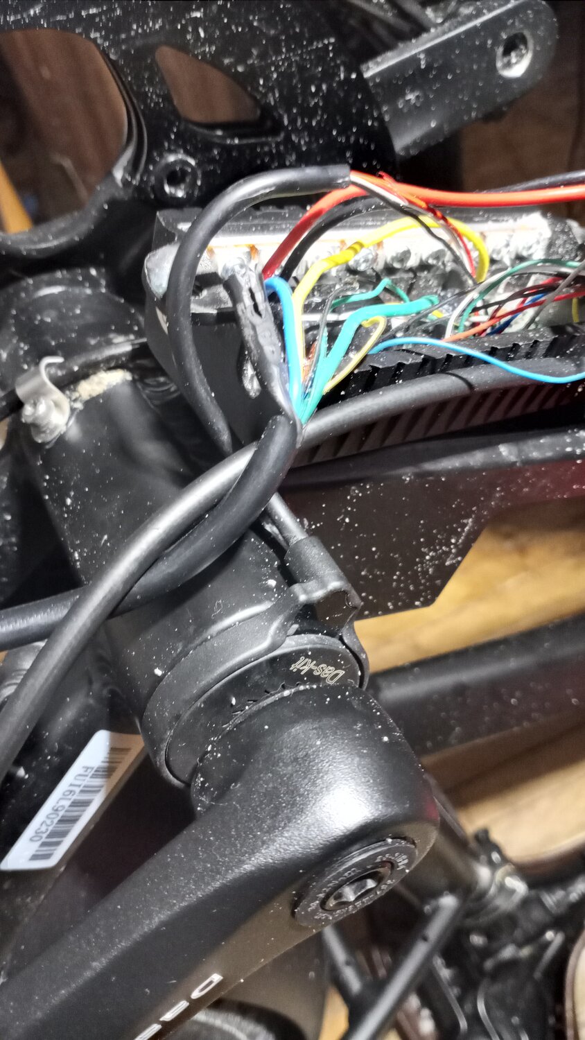

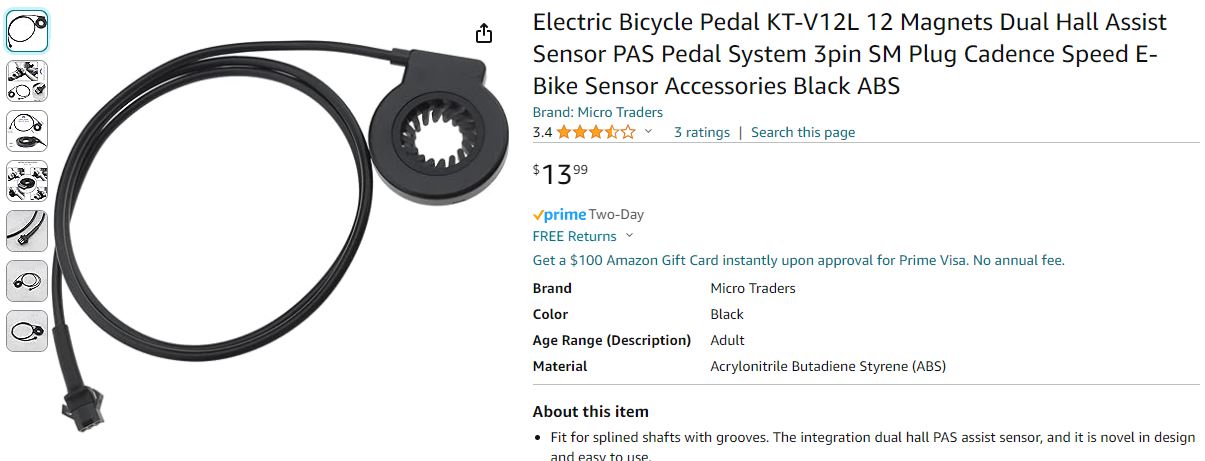

I fixed this problem by splicing in a generic sensor: My NCM Moscow was experiencing similar intermittent power cuts. I couldn't locate a replacement controller with the hardwired sensor, so I bought a generic Pedal Assist Sensor (PAS) from Amazon and wired it in. I tried cleaning it first but that didn't work so for $14 it was worth a try.
The installation involved cutting the original sensor wired to the controller and splicing in the new one. While the generic sensor appeared similar in size, it required minor modifications. I used sandpaper wrapped around a dowel rod to slightly enlarge the opening. It didn't need much sanding to make it fit.
The wire color didn't match so I had to determine the correct connections. Thankfully, the modification worked, and the pedal assist functionality returned. I'll include photos of the wiring and the sensor I bought.

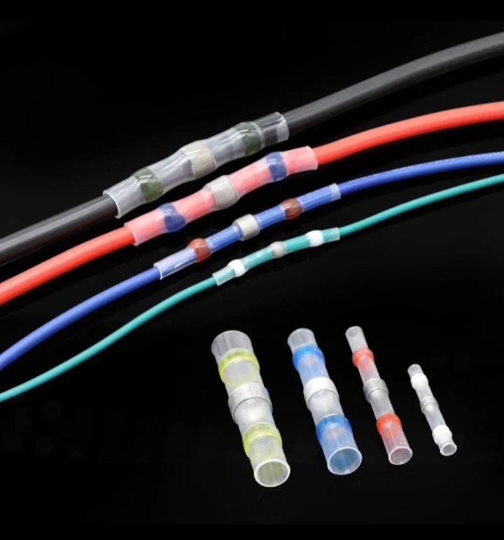

Same. Unfortunately, first PAS sensor didn't work (never got power, no matter how I arranged the connections). Then I just bought the same one you did off Amazon and it worked right out of the gate. The wire colors didn't match, but it was pretty easy to figure out correct connections, since black is almost always ground, then you only have to futz with other 2 wires. I used quick solder connectors to join the splices. Very handy, basically a heat shrinkable tube with a solder ring in middle. Just insert both ends into the tube and heat with heat gun (which I used), or even a lighter.
Like some other poster said, why the heck NCM didn't just make the sensor with a plug is beyond me, since failure seems to be pretty common.

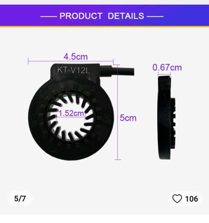

Keep in mind that a generic PAS sensor is designed to be installed on either the left or right side of the bottom bracket.
If you get the wrong one, you'll only get power to the motor when you're pedaling backwards, and swapping the positive and negative doesn't fix it.
The sensors have angled pawls that grab the axle in one direction and slip in the other direction so that you don't get power when you bump the pedals backwards.
There's different measurements for everything from the size and thickness of the sensor itself to the axle diameter it is meant for.
I'd suggest to anyone with a Das Kit PAS sensor to buy the one linked above because it's proven to fit and work properly.
Here's a link to those quick solder connectors.
I've never tried them, but they look pretty cool.
