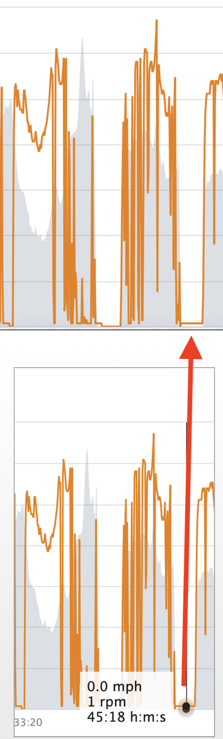

I have a Garmin 1030 Plus and it does show a cadence of 1 with no pedal movement but not always. As the image shows, there is no speed but the cadence shows 1 when stationary. As far as their being a difference? Yes, the difference is 1. Does it matter? Maybe. If my bank statement shows off by a dollar it does matter. Primarily, why is there a difference? Did I error or did the bank error? Is a hacker testing my account for something bigger? Not primarily, it is a dollar.

Here is my issue. I have a loop ride that is 6 miles almost constant uphill, followed by 8 miles of almost constant downhill, then the last two again uphill.
If the cadence would go to zero, then on the downhill my avg cadence for the ride wouldn't change (I have the Garmin set to ignore cadence zero).
As it is, since it reads 1 instead of actual 0, my avg cadence for the ride decreases and decreases during the long 8 mile downhill.
I had a Wahoo Bolt prior to the Garmin, and it read 0. So even though this may be more of a Garmin issue than a Creo issue, well, I thought I'd put the question to the Creo group anyway hoping someone might have a fix.
