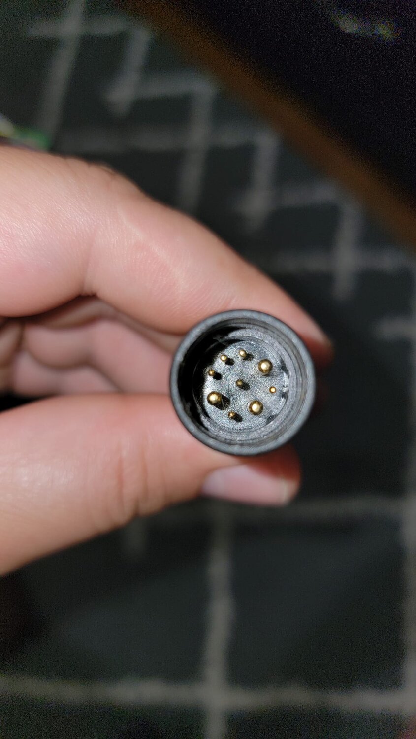

Hello.
I'm trying to find information about this cable.
The cable says that it's a Julet; I've been able to find information under the model number Z916A nonetheless the only sellers is a single store on Aliexpress. I would like to know if any of you would know where I could purchase this cable or more information about it. Thank you.

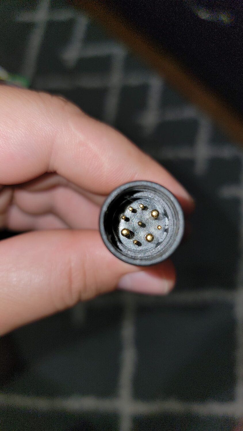

Hello.
Yep, my Vtuvia sf-20 had the same z916a. It's a very rare connector. It can handle the same current as z916 though. For my use I bought a KT controller and made my own conversion cable by using the older controller connector and splicing in a regular z916 end on it (if using a 1000w controller else you need a z910 end if using a 500w-750w controller). You can also buy the one z916a extender cable from aliexpress and also do the same splicing on it but it's expensive. I have not found any source of the z916a connector anywhere. Kinda forces you to use the factory controller which sucks. I find the KT controllers give me the smoothest PAS as anything else I've tried. Luckily enough though, the colors match the standard color codes for hub cables so it's easy to figure out which wire goes to what. This is the aliexpress z916a extender cable: https://www.aliexpress.com/item/1005004599800280.html

Could you remove this answer, please? It's misleading. It's showing the Z910 connector, which is different (smaller) from the Z916A. And the linked video has no information about the actual plugs, it's just a Julet factory tour.
I was so confused that I made a small list of popular ebike motor plugs at https://docs.google.com/spreadsheets/d/1t0hcVV1riy9zPBIZPwUBRNrV_-02OBEFYpAcc16qPFk if that helps.
