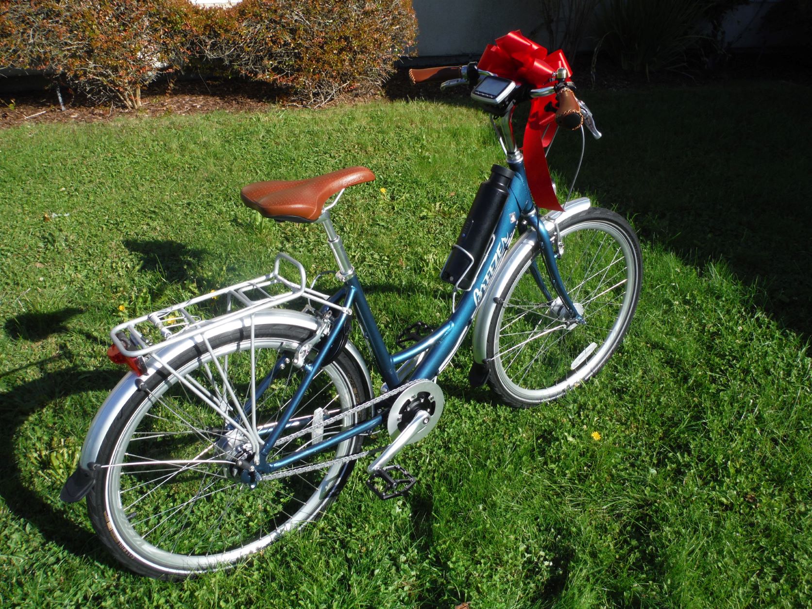

This is a torque sensing mid-drive with a throttle and an internally geared hub. It is posable to have it all. It feels like a bike but amplified, no surge or lurch, immediate, smooth, for her birthday. Then her husband had to get one for Christmas. Better eBikes do not look or feel clunky. Good ones are lithe, and elegant. Pedal speed is the same as chainring speed.
